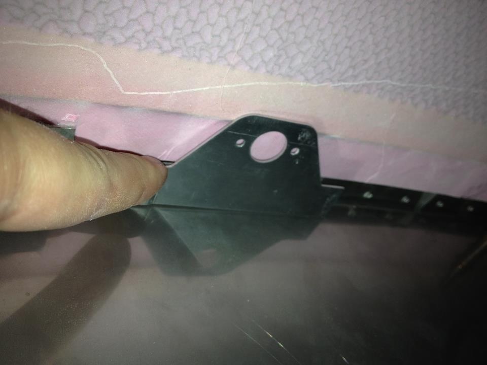

PostPosted: Fri Apr 25, 2014 7:11 am    Post subject: camlocs on the bottom of cowl Reply with quote
Mine (ordered very close to the same time Kelly's) doesn't have enough flange for my skybolts. Weird.
So I'm switching back to hinges at this point. I've got some photos somewhere of it.

PostPosted: Fri Apr 25, 2014 9:32 am    Post subject: camlocs on the bottom of cowl Reply with quote
I have the pink cowl w/o the gray exterior and it had plenty of flange for
the skybolts all around. I am using the skybolt upper kit, hinges on the
lower cowl sides, and 3 #8 screws on each side on the bottom of the cowl.
Not flying yet though.
I would not let the lack of flange deter you from skybolts if you wanted to
use them. It is not a difficult task to remove some of the honeycomb. I
don't think it weakens the cowl at all when you do that because essentially
your making your cowl match how most of them were molded from the start. I
would seal the edge of the honeycomb and potentially layup a thin layer or
two of glass if you felt you sanded the shell a bit thin in spots. In total
it's probably on a couple hour job.

PostPosted: Fri Apr 25, 2014 11:01 am    Post subject: camlocs on the bottom of cowl Reply with quote
Guys, FYI
I have the pink cowl, just fitted recently, and I had to grind away the foam structural part on the top right corner just to make the piano hinge fit.  The foam was very crooked along the aft edge.  I covered the area that I ground away with fiberglass cloth to replace the structural foam I removed.  I am using 4 #8 screws & nut plates.
Rick

PostPosted: Fri Apr 25, 2014 12:38 pm    Post subject: camlocs on the bottom of cowl Reply with quote
I'm pretty sure the variability we are seeing has to do with both some of the cowling manufacturing variability, and with the variability in the front flange of the engine to the firewall dimension. Since all the cowls are custom cut and fitted, some end up with more or less flange than others.
I'm my experience, the fiberglass on the top and bottom of the foam is significantly thinner than the flanges. If you grind away the foam, you will have to add in several layers of fiberglass.

Here is the photo that I mentioned showing the interference with the honeycomb and skybolt tabs.
After reading some of the others experiences, I suspect the answer is in the spinner/prop selection.  I'm running a 3 blade MT and it came with a factory spinner.  I suspect if I fitted vans spinner to a different prop, it would move the cowling further forward by a .25" to .5".   The MT spinner does sit back a little further and after you set the gap between the back of the spinner and the front of the cowling, that could easily make up the difference between hitting the honeycomb or not.
I'm not going to put the work in to making the skybolts work with my MT setup. So if anyone is interested in a full set for the upper cowl, lower cowl, and sides, let me know.
Phil
On Friday, April 25, 2014, Phillip Perry <philperry9(at)gmail.com (philperry9(at)gmail.com)> wrote:
