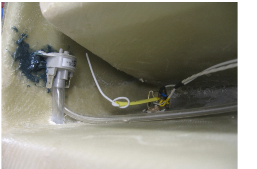

Hi Jos,I have been reviewing pictures on the EuropaOwners website for my instrument panel, for ideas, and came upon this photo. Can I please ask what it is??
[img]cid:EF0B9875-8E66-47C3-975D-34AE308CCC23[/img]
It appears to be a pressure sensor, a pneumatic pressure sensor. Is that right??

It looks like the stall warning sensor

<?xml:namespace prefix="v" /><?xml:namespace prefix="o" /><![endif]--> Tony,
The pressure transducer is for the stall warner of course. However, there is a problem with this install with the adjustment and maintenance. It appears he has a tube for adjustment of the sensor from below the panel, but Redux permanently mounts the sensor. I sure hope it never fails. Getting a cutter in that area means pull the panel and cut Redux. I also noticed his com jacks under the floor of the shelf. Again, not easy to service and a bit of a hunt to find.
I prefer the stall warner in the wing next to the tube passing through the spar. I mount it on a couple of bolts through the ply and run the wires to the cockpit. Tubing is harder to run through a conduit than wire. However, the easiest to ajust was put into the cockpit module just forward of the rudder pulleys with a hole to adjust. Makes it easy and fast for flight test adjustments in flight.
I normally put my com jacks in the upper aft area of the above head console. If you want them in the panel, we have installed the pilot jacks on the far left panel bottom and have made a simple foam shaped piece for plugging into the pax sides for direct plug in of your headsets. With it on the panel, the inspector may want it labeled but that is only in a few examples.
