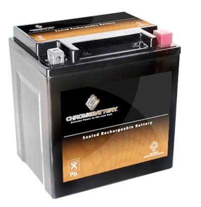

Aerovolts also claims:
The 16 Cell has a massive 500PCA and 28 Pbeq AHs at only 3 lbs of weight. The 16 Cell is a direct replacement of the Yuasa YTX30L-BS, GYZ-20HL, and YTX24HL-BS.
The Yuasa YTX30L is a 22 pound, SVLA battery that would
clock in at about 24aH . . . I submit that while the 16-cell
Aerovolts product may CRANK like the Yuasa battery, it is
NOT A DIRECT REPLACEMENT when it comes to keeping the
fires lit up front . . . in fact, it's probably less than
half the capacity of the Yuasa battery.

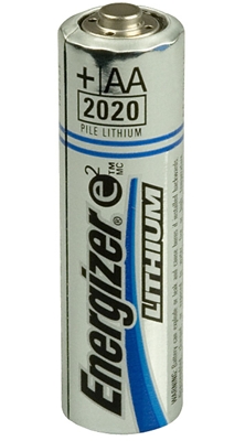

Your comments in the PDF file about battery Ah rating under different
operating conditions reminded me of an interesting annecdote.
About 10 years ago, Energiser began marketing a series of cheap (approx $20)
AA battery powered chargers for cell phones. They are a simple plastic case
(inc circuit) for two primary AA cells, plus a short adaptor cord option for
the various cell phone models. Turns out they come fitted with lithium

PostPosted: Thu Mar 20, 2014 10:57 am    Post subject: EarthX lithium Reply with quote
. . . using lithium cells in a low power device such as a wall clock would offer a very
poor return on investment, given the lithium AA cells cost about 4 times the
price.
Yeah, your talking about these critters . . .
[img]cid:.0[/img]
They're in the Size 91 package (AA) but offer a lithium-Iron
couple that's in the same ballpark as the carbon-zinc and
zinc-manganese flashlight cells (1.5 volts).
If you compare E91 alkaline cell data
V http://tinyurl.com/nt2x8hd
with the L91 lithium-iron data
http://tinyurl.com/otkeubs
We see that both products are in the same ballpark
for contained energy but the L91 cell internal
resistance is about 1/2 that of the E91. So not
only do you get slightly more total energy, your
access to that energy at high discharge rates suffers
about 1/2 the losses in heat.
This 'lithium' product is a different animal from
the devices we're pondering as replacement for
engine-cranking/standby service. The boss-hogg
lithium cells are 3.3V couples and generally
much lower resistance still . . .
It's unfortunate that characteristic performance
of two cells are not presented in the same pews . . .
suffice it to say that the approx 1/2 internal
resistance will toss off less energy under high
demand loads.
On the Nickle-Metal Hydride side of the house
one may acquire 1.2V chemistry with very attractive
internal impedances . . .
http://tinyurl.com/nj5xx85
At 1.2V vs. 1.5 volts the contained energy
in watt-seconds suffers slightly but they'll
readily deliver their contents at high rates.
Down-side is that the self-discharge characteristics
of Ni-Mh compared to the Lithium-Iron or Zinc-Manganese
cells is pretty sad. Up-side is that you can readily
re-use these cells many times over and their
acquisition costs are nominal.
http://tinyurl.com/nklo97k
Your right, lithium-iron AA cells poor value compared
to other choices . . . unless your design goals
absolutely demand high rate discharge support
AND long shelf life.
Its all in the design goals . . .
