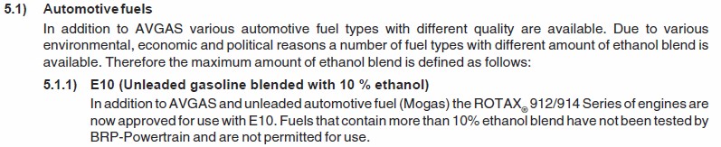

Has anyone run ethanol (E-10) in their Rotax 912S? Is this stuff any good or safe for the engine? Can a lead additive such as Bell Performance Products be added to reduce the damaging effects of ethanol-alcohol. What is everyone else using other than AvGas? Just thought I'd throw that out there for discussion. Thanks

I have a plain vanilla 912 and have been using standard test gas out
of the Sheetz gas station since first flight in November of 2000. I
have 800 + hours on the plane. I have replaced all the fuel hoses
once and have recently recoated the inside of the fuel cells.
Still runs great ! !! ! !
I think Rotax still says that 15% ethenol is OK. There are Rotax
engines in Brazil running on their mogas.
I still keep my fingers crossed.
Bernie Wilder

I think 10% is max allowed. I would not use any additives. I just checked Rotax Service Instruction SI-912-016R6 and here's what it says...
[img]cid:part1.07050904.02020802(at)gvtc.com[/img]
Ray
