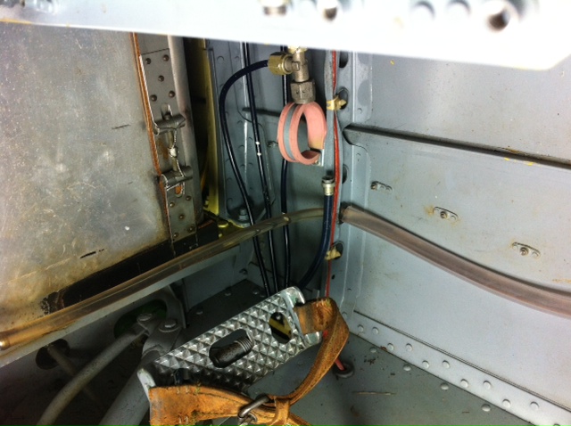

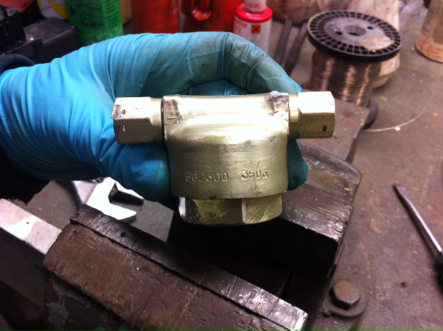

Hi all. Just finishing up an annual. Had some wear problems on the right main gear which required re-bushing. Re-assembled and on trying to pressurise the air system got a major farting noise from inside the cockpit, and no pressure going to the bottles.
On investigation, the air/noise id coming from a valve low down and forward of the right rudder pedal (see pics). Local guru says it is an air pressure regulation valve that modulates air pressure to the gear actuators to stop the gear smacking down under full pressure. We pulled the valve and tried to open it up to inspect, but the thread is peened over, and we couldn't budge it even with two wrenches and a vice - not designed to be serviced I reckon.
However, in wrestling it around something inside clicked, and on a hunch we re-installed it and, hey presto it started working again.

PostPosted: Tue Apr 01, 2014 1:55 am    Post subject: Re: YAK 50 Air/Gear problems Reply with quote
and photo......

aerostar6
Joined: 26 Jun 2008
Posts: 33
Location: Amersham, UK
PostPosted: Tue Apr 01, 2014 1:57 am    Post subject: Re: YAK 50 Air/Gear problems Reply with quote
and where it lives....

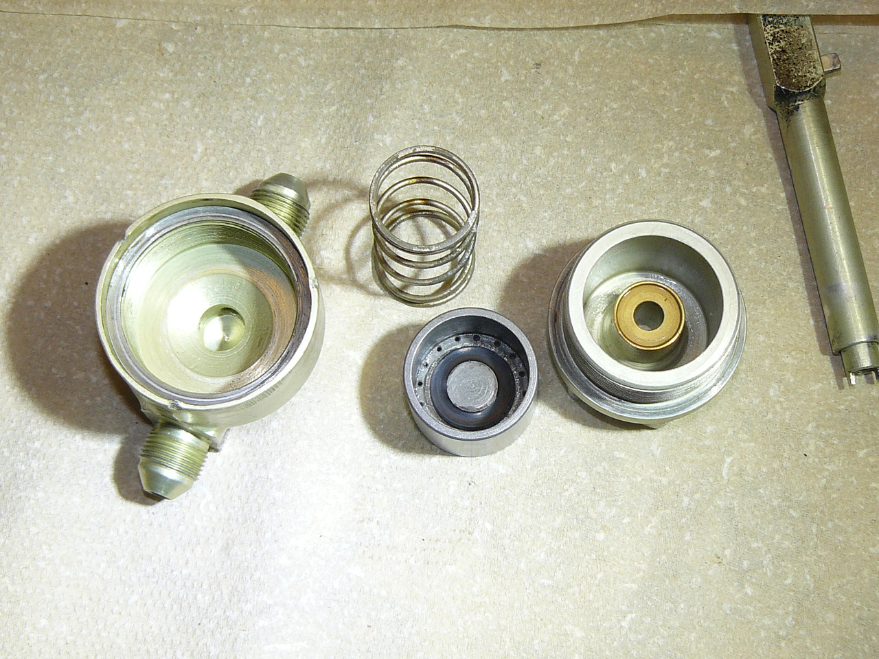

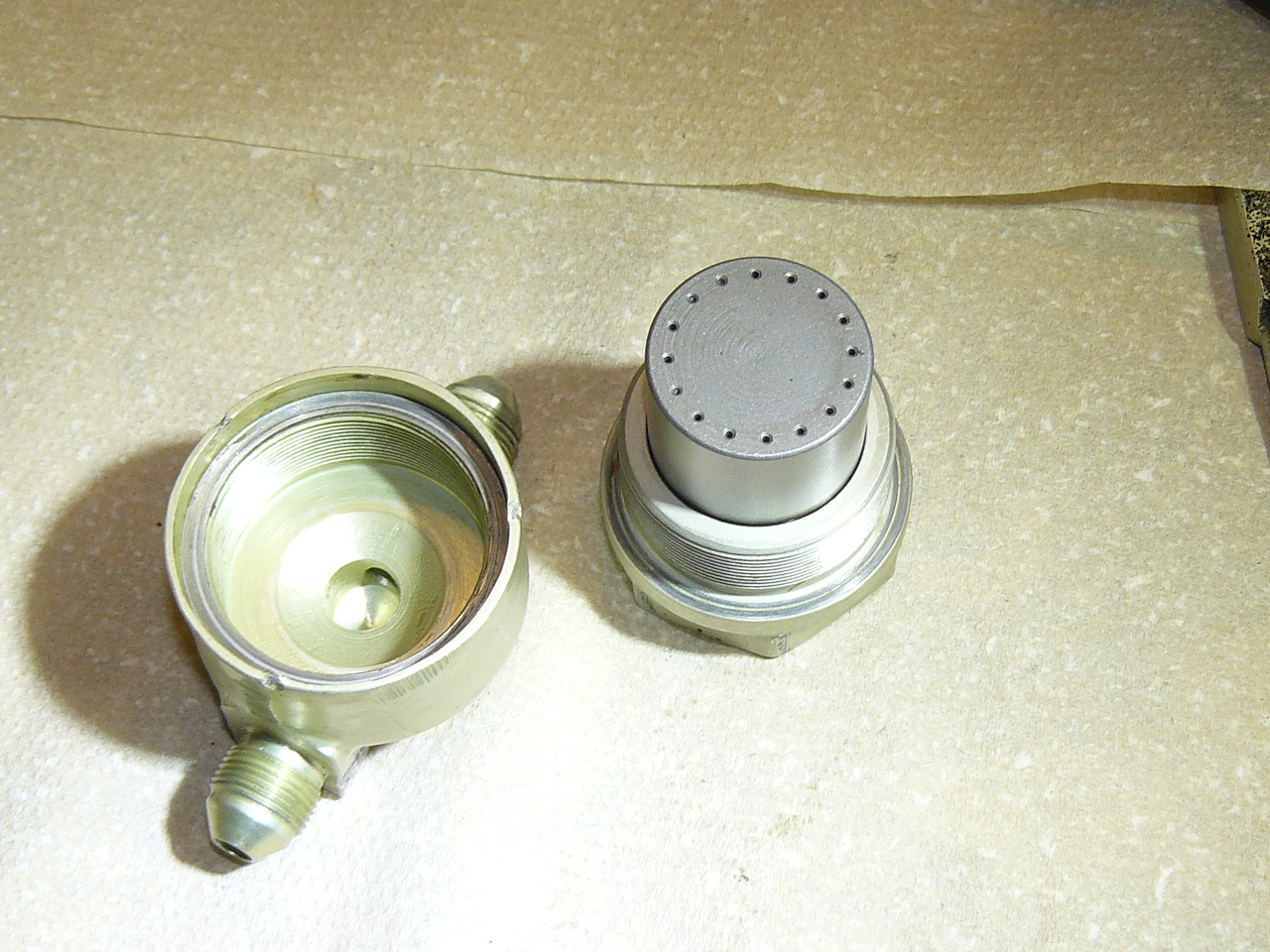

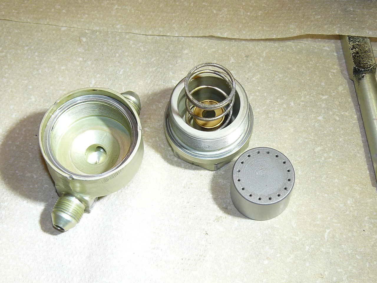

PostPosted: Thu Apr 03, 2014 4:01 am    Post subject: Re: YAK 50 Air/Gear problems Reply with quote
Hi,
that valve does no regulation at all, it is either open or closed. I think it is a sort of blow-off valve related to the emergency extension of the landing gear. If it works now, OK. See the photos below, there is a spring loaded piston that is kept closed with sufficient air pressure. The speed of the gear extension is restricted elsewhere .
Vic

PostPosted: Thu Apr 03, 2014 4:15 am    Post subject: YAK 50 Air/Gear problems Reply with quote
You are correct Vic. We call it the "fart" valve because that's what it sounds like when it finally opens, which is at a very few atmospheres.
Dennis
