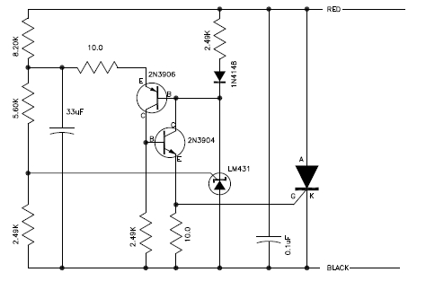

I am still wondering if a zener diode could be used instead of the SBS. If not, it would be interesting to know what the disadvantages of the zener diode are, or if it would even work at all.
Thanks for any advice.
Joe
Joe,
Feeling adventuresome? I pondered the idea
of exploiting the LM431's precise voltage set
point with a design goal of eliminating the
potentiometer and the post assembly calibration.
Here's what I came up with.
[img]cid:7.1.0.9.0.20110222010338.01f7bff8(at)aeroelectric.com.0[/img]
The parts count is unchanged but it should be
calibrated as soon as the last solder joint is
cool. Temperature stability should be as good
or better than any previous versions.

Thanks for that O.V. circuit using the LM431, Bob. I will add that IC to my next electronics parts order.

I built Bob's circuit. To test it, I wired it in series with an automotive lamp to a DC-DC converter like this one: http://tinyurl.com/kmpqcb8
I slowly turned the pot to increase the voltage. The lamp illuminated at almost 17 volts. Since my Rotax rectifier/regulator puts out about 13.8 volts, I decided to lower the set point of the over-voltage protector by substituting a 5.1K resistor for the 5.6K. Now the test lamp comes on at 16.2 volts. When the voltage increases above 15.8, the circuit becomes sensitive. Just touching the circuit with a digital voltmeter probe is enough to fire the SCR. Using a different voltmeter had the same affect. No doubt that in an electrically noisy environment like an airplane, the circuit will trip at 15.8 volts. That is not a problem though. 15.8 volts is 2 volts above my aircraft system voltage. If spring weather ever comes to Michigan, I will install it in the airplane.
Thanks for designing the circuit, Bob. You are my mentor.
Joe
Joe Gores
PostPosted: Mon Mar 24, 2014 7:04 pm    Post subject: DIY CBOVM: variations on a theme Reply with quote
That should not be so sensitive to probing.
How is this circuit packaged? Can you send me a pucture?

I repeated testing of the over-voltage circuit today, doing a better job of connecting wires. If the voltage is steadily increased, the SCR fires at 16.2 volts. But if the voltage is set at 16.0 volts and held there, the SCR would fire after waiting a couple of minutes. Probing the input with a voltmeter intermittently caused the SCR to fire only when the voltage was above 15.9. Circuit instability, if any, is within 0.1 volt of the set-point. The adjustable voltage power supply only cost $6. Who knows how stable that is. The components are all through-hole, not surface mounted, and are mounted to a 1 x 2 inch area of PCB. I am happy with the circuit.
I intend to connect the over-voltage circuit in series with a relay coil that is powered by a 3 amp fuse.. The normally closed contacts of the relay will be in series with the AC output of the permanent magnet dynamo. In case of high voltage, the SCR will fire, connecting one leg of the coil to ground to energize the relay, opening the AC circuit to the rectifier/voltage regulator. The SCR will continue to hold the relay energized until battery power is disconnected from the relay coil.
This will not be a crowbar type of over-voltage protection. So no circuit breaker is required. High voltage will not blow the fuse.

In regards to stability you might check that there is a capacitor across
the voltage reference diode and another from the SCR gate to ground. If
you happen to have an old circuit diagram dated before about 2005 it may
not show that update.
One nice thing about the crowbar and circuit breaker in the Z diagrams
is that the voltage is brought under control immediately when the SCR
fires. If I understand your post it sounds like your implementation
waits for the relay to open and for any subsequent arcing to extinguish.
Perhaps that is good enough but it seems preferable to use the circuit
breaker as per the Z diagrams so that the SCR clamps the voltage faster.
Might be other small advantages as well such as a subsequent dead
battery could not cause the alternator to come back on line.
Ken
to a 1 x 2 inch area of PCB. I am happy with the circuit. I intend
relay coil. This will not be a crowbar type of over-voltage
not blow the fuse. Joe

Thanks for suggesting the capacitors. The circuit is stable unless the voltage gets very close to the trip point. That is OK with me as long as there is no nuisance tripping. Time will tell.
Good point about the crowbar circuit acting immediately by clamping the supply to ground. The data sheet for my relay says it will operate in 15 milliseconds. I am hoping the battery will limit the voltage until the relay contacts open. I will try to land before the battery runs down enough (almost completely dead) to drop out the relay.
Joe

Ken, Thanks for suggesting the capacitors. The circuit is stable
relay. Joe

PostPosted: Wed Mar 26, 2014 11:47 am    Post subject: DIY CBOVM: variations on a theme Reply with quote
across the voltage reference diode and another from the SCR gate to
ground. If you happen to have an old circuit diagram dated before
about 2005 it may not show that update.
diagrams is that the voltage is brought under control immediately
when the SCR fires. If I understand your post it sounds like your
implementation waits for the relay to open and for any subsequent
arcing to extinguish. Perhaps that is good enough but it seems
preferable to use the circuit breaker as per the Z diagrams so that
the SCR clamps the voltage faster. Might be other small advantages
as well such as a subsequent dead battery could not cause the
For the run-of-the-mill ov conditions with a good
battery, an ov even is not one of extreme urgency.
The ships air-worthy battery will stand off a runaway
alternator for significant intervals. If one waited
100 mS to evaluate an ov condition for a true runaway
alternator, it wouldn't be a bad thing.
In fact, the next generation ov module will do just
that. Sensing an ov condition start a 100mS timer
that continue to run as long as the voltage does not
drop back below 16V before the timer runs out.
On the other hand, a second threshold at 20V assumes
no air worthy battery is present and an immediate trip
is initiated.
We're still going to pull down on the field supply
breaker . . .
is initiated.
breaker . . .
