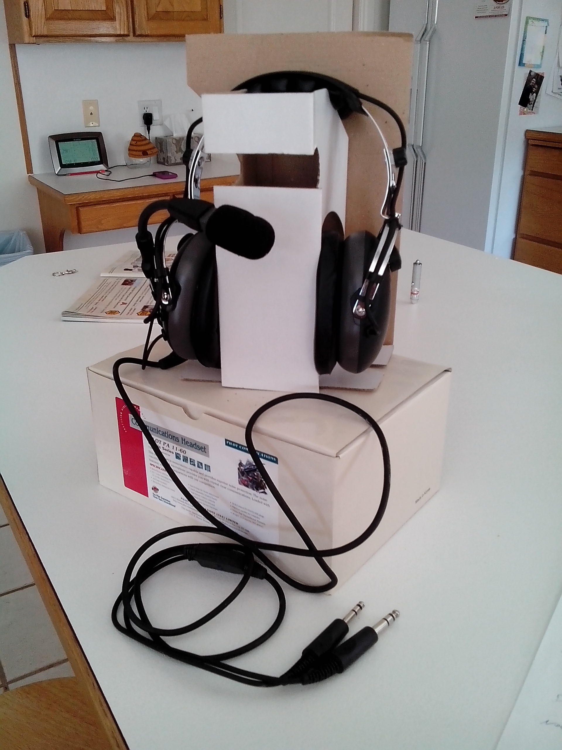

PostPosted: Sat Apr 12, 2014 9:01 am    Post subject: Radio antenna question Reply with quote
Richard
I have a headset. "Pilot PA 11-60"  I used it for about 100 hours, then bought some noise canceling headsets.  Here is a photo, let me know if you are interested. As you can see it is still in the box.
Boyd
