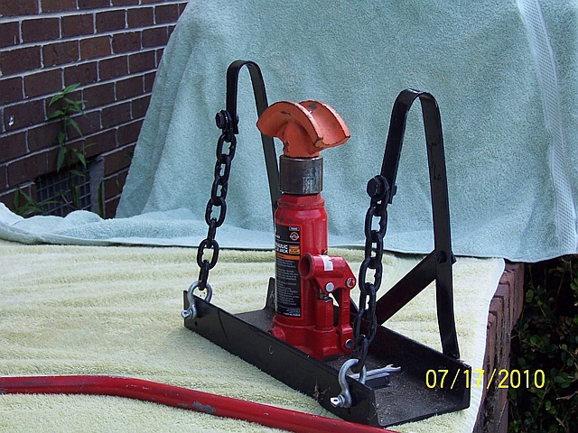

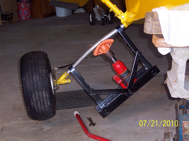

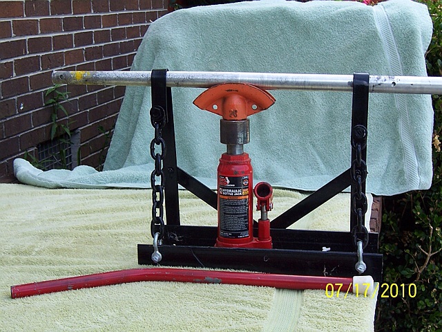

PostPosted: Mon Mar 31, 2014 9:18 pm    Post subject: Re: Bent gear leg question.. Reply with quote
I can't remember where I found these pictures but it looks like this would work very well to me.
Here is a way to help eliminate bent gear legs, check out the video
http://youtu.be/ysZBXy-pDzI
 Filesize:  124.15 KB
 Viewed:  8284 Time(s)
 Filesize:  167.98 KB
 Filesize:  162.45 KB
