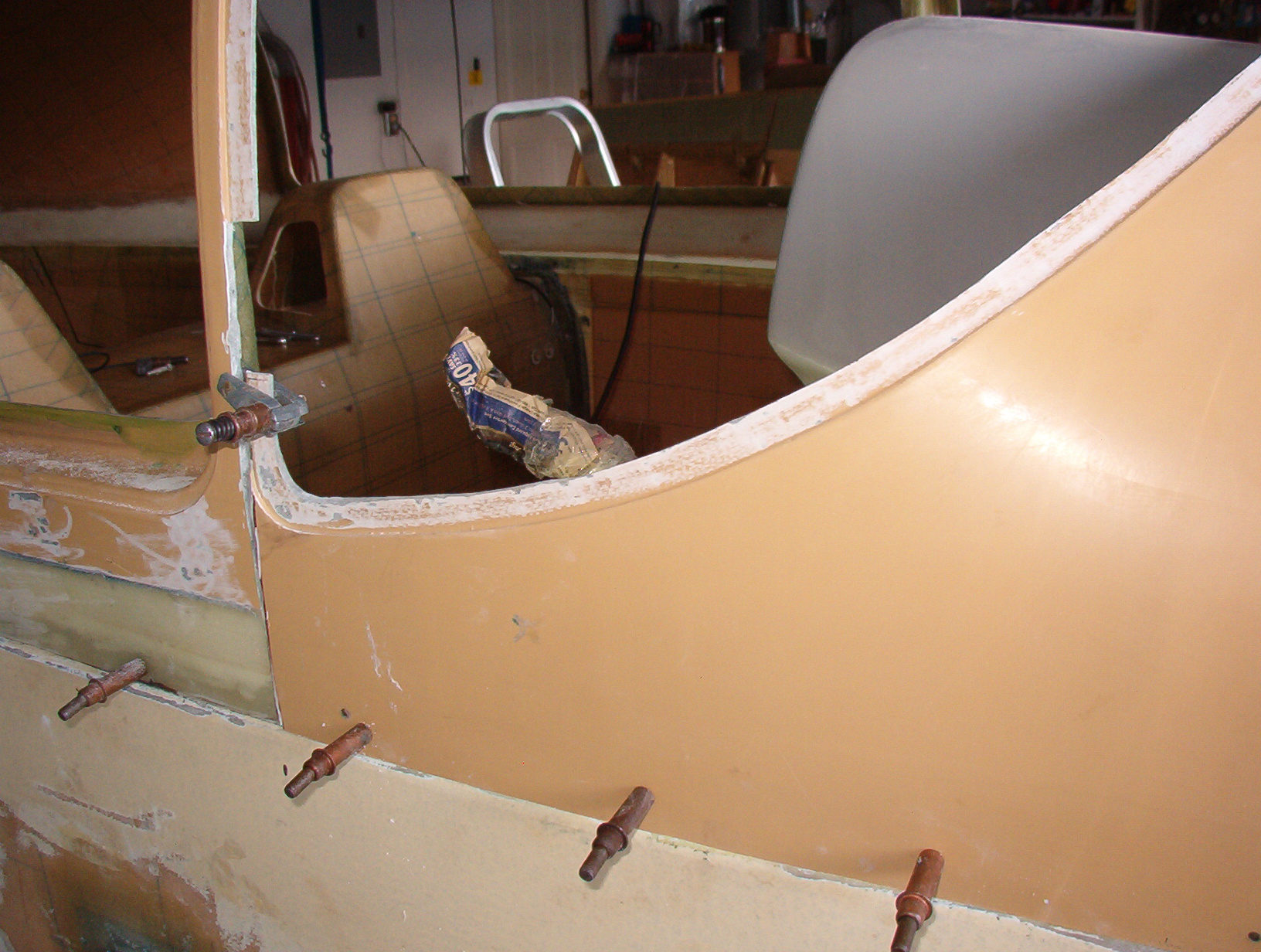

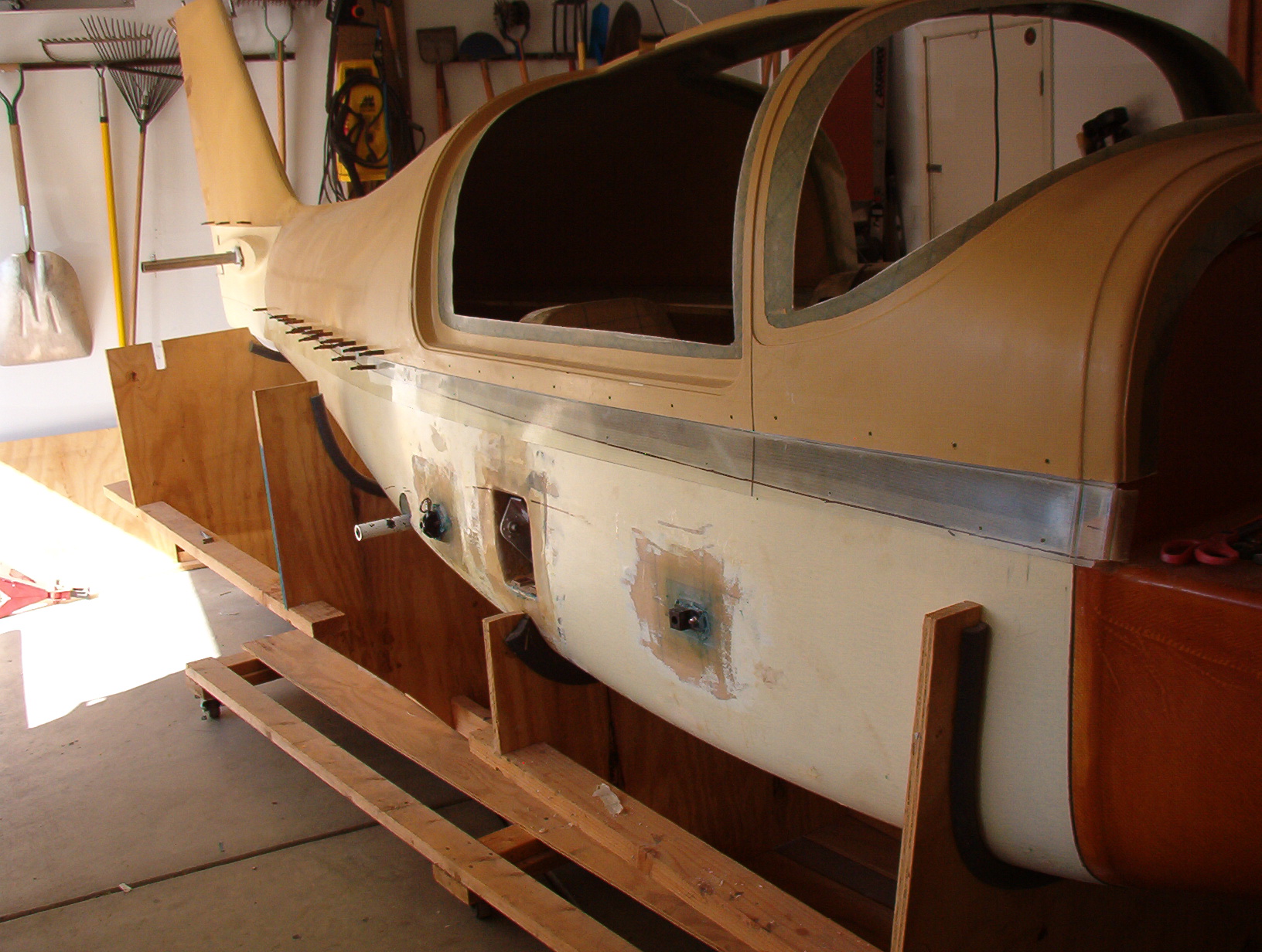

I made my cut on the wind screen rear edge. I have attached two picture, but if you need more contact me off line.
Aireuropa(at)sbcglobal.net
I did the 64B mod. When I got the wind screen it was smaller than the opening so I had a lot of back filling to get it to fit.
 Filesize:  683.96 KB
 Viewed:  3648 Time(s)
 Filesize:  739.89 KB

Hey thanks for the reply. I took the plunge today and made the cuts. My concern was where to make the horizontal cut, how far up the pillar. There is no defined height as long as they are the same both sides. I made the cuts 25cm up from the lower edge of the upper moulding.
