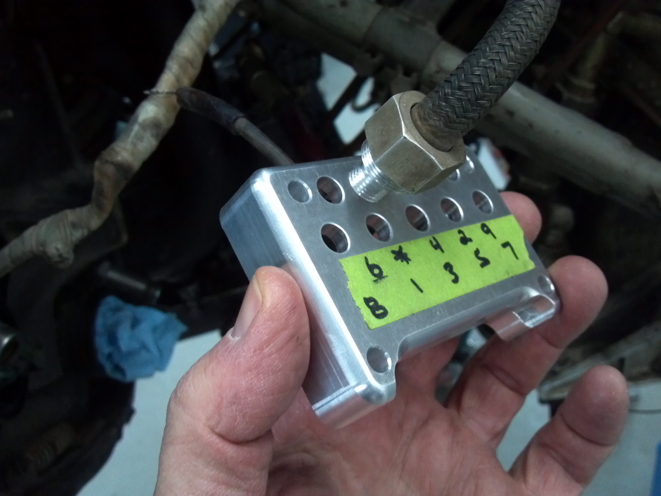

PostPosted: Sun Mar 23, 2014 8:01 am    Post subject: Re: Coil lead Conversion Reply with quote
An adapter I make to convert Taylor ignition using Cj or Yak start lead.
 Filesize:  707.99 KB
 Viewed:  6552 Time(s)
