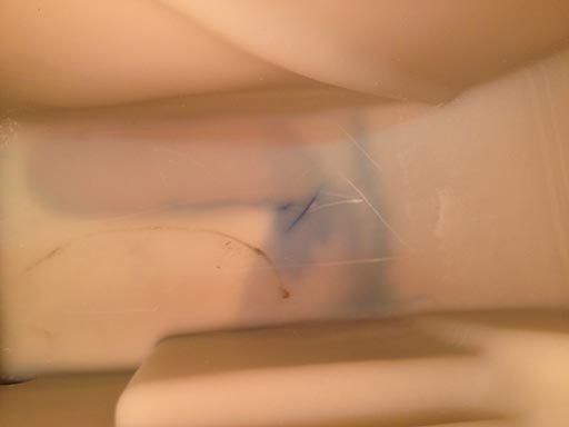

Yes, to the stress concentrations caused by the fiberglass “shelf." My tank cracked right at the corners of one of those fiberglass layups:
[img]cid:64619E84-D1BA-4D2B-B86C-A6DDB1BC9EA5[/img]
In this view the top of the tank is off and you are looking down into the port side of the tank. The crack is pretty well defined in blue and is right on the corner of the outside, forward corner of the “shelf.” Right at the 45º predicted by stress analysis.

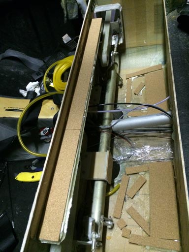

Kinda/sorta, the fix is to provide support under the tank. The rear “shelf” is still there attached to the rear bulkhead which carries most of the load supported on a layer of cork. There is also support built under the forward part of the bottom of the tank. This is a thick micro applied in lines upon which the tank was set (plastic wrap used as a parting agent) and the micro allowed to cure. The micro was also covered with cork. The micro is not to provide primary support only secondary support should the gas soften the tank and allow some sag. The micro would support the sag rather than sagging over the shelf causing another stress riser.
[img]cid:B897072D-70D5-4A90-93AD-99AF78CCD8CE[/img]

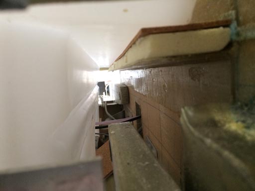

The aluminum T shelf on the front bulkhead had a layer of urethane foam bonded on top to support the ledge of the tank. This was also covered with cork.
[img]cid:303EFBE6-3486-457C-9F40-977668A5C1D0[/img]
