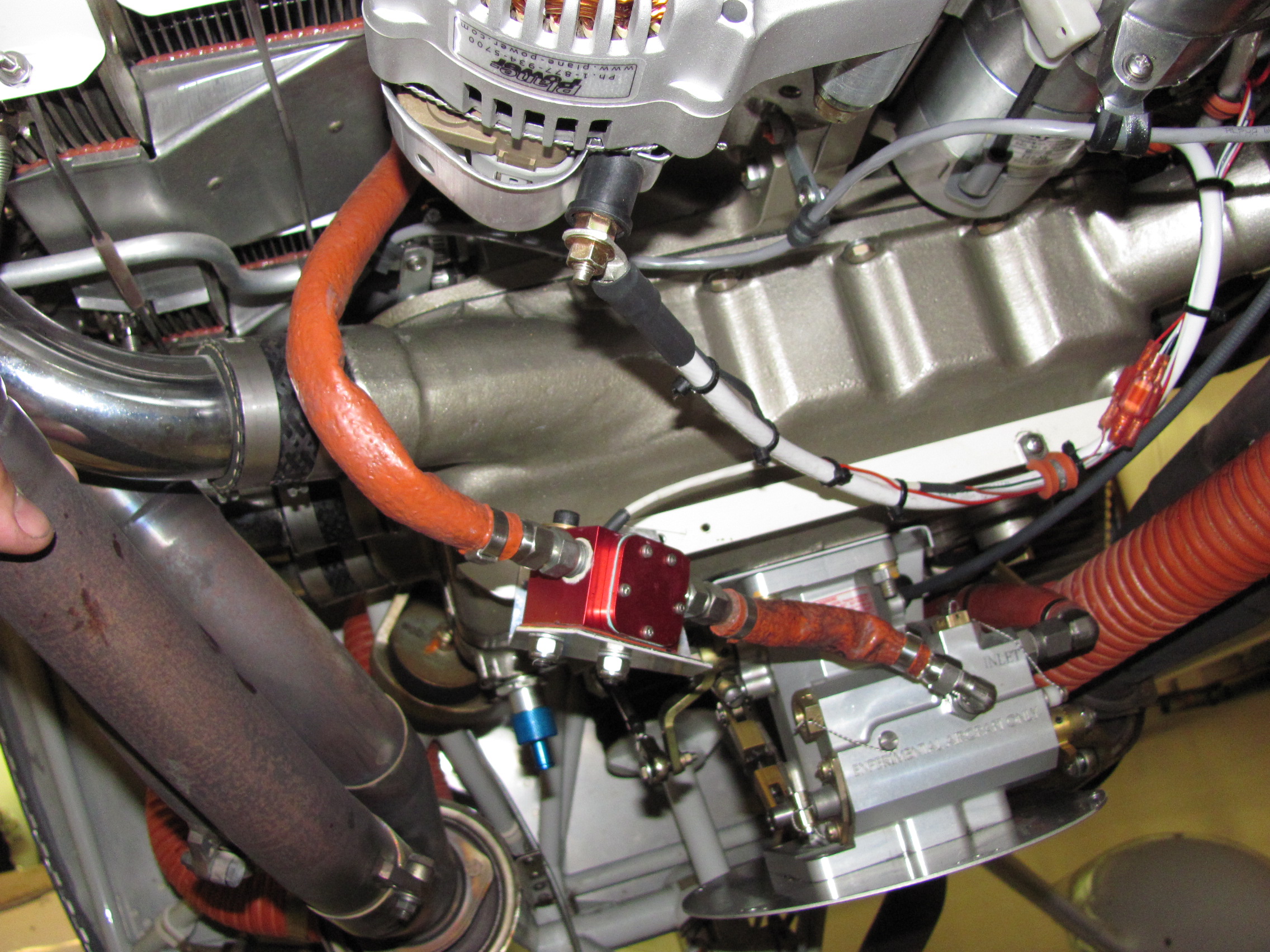

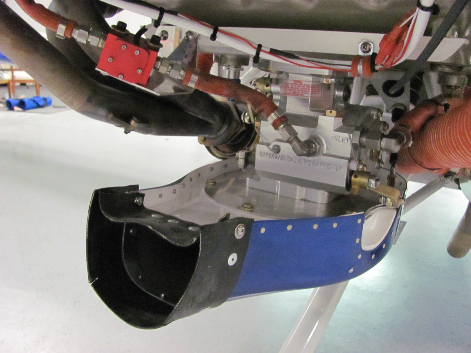

PostPosted: Mon Mar 31, 2014 5:19 am    Post subject: Need help with FloScan re-location from tunnel to engine c Reply with quote
Bill
Here are some pictures that might help. 430 hrs and working great

 Filesize:  484.04 KB
 Viewed:  7507 Time(s)
 Filesize:  1.1 MB
Geoff Combs
RV-10 QB N829GW
Flying 500 hrs
Geoff Combs

If I remember correctly I took my original line and had them cut it and add
the new fittings as need and then
Cut to the new lengths.
There is a place nearby that does all types of custom hoses.
Geoff

Bill
Geoff Combs
