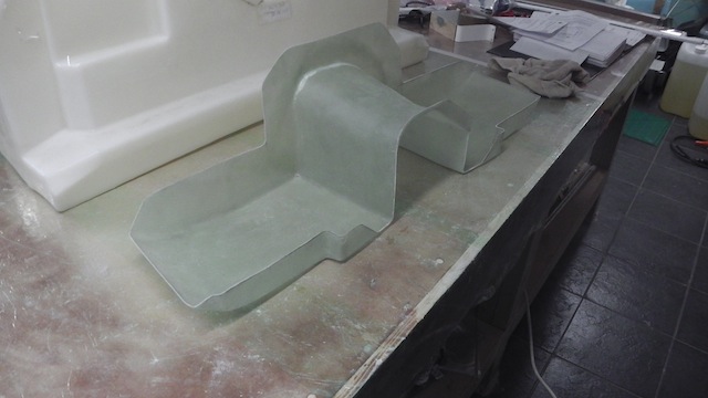

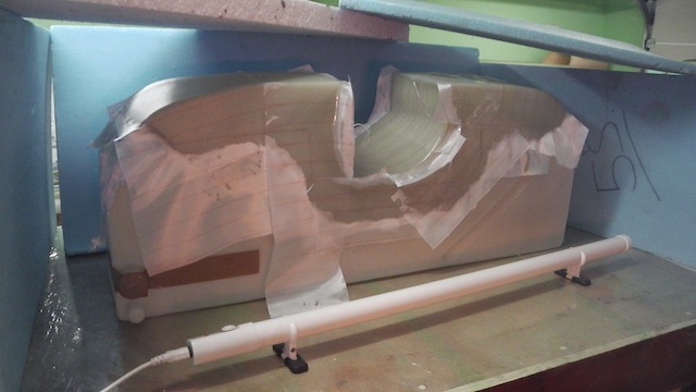

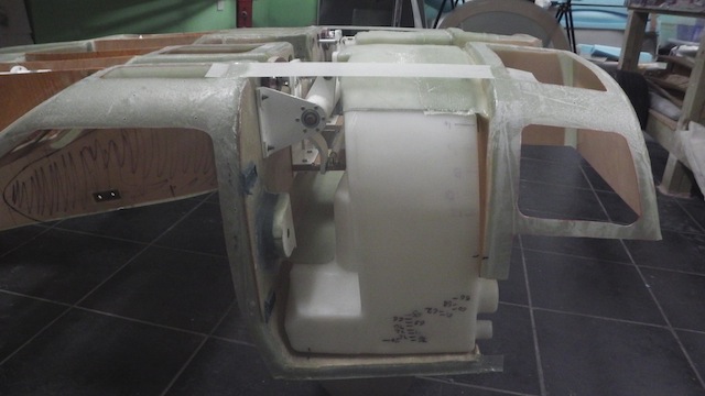

Hello stephan. Well I put off bonding in my cockpit module because of this very subject as it seemed that quite a few reports of tanks splitting we're emerging just as I was about to bond in my tank. I filled my tank with fuel for 6 months prior to bonding it in and yes it does swell by quite abit but I think this is not only due to fuel getting into the actual material but the weight of the fuel. What I gathered from everything I read was that the tanks were splitting due to being bonded into the module tight against the cockpit wall this giving the tank no we're to swell once filled with fuel. I made a cradle for the tank to sit in and bonded that to the cockpit so my tank is actually "floating" in place. I will post a few pics later. Hope that helps. Frank

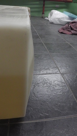

This is the back of the tank after 4/5 months of having fuel in it.
 Filesize:  58.79 KB
 Viewed:  3734 Time(s)
Looks good
 Filesize:  55.95 KB
See the gap between the rear of the tank and the cockpit module rear bulkhead
 Filesize:  57.21 KB
