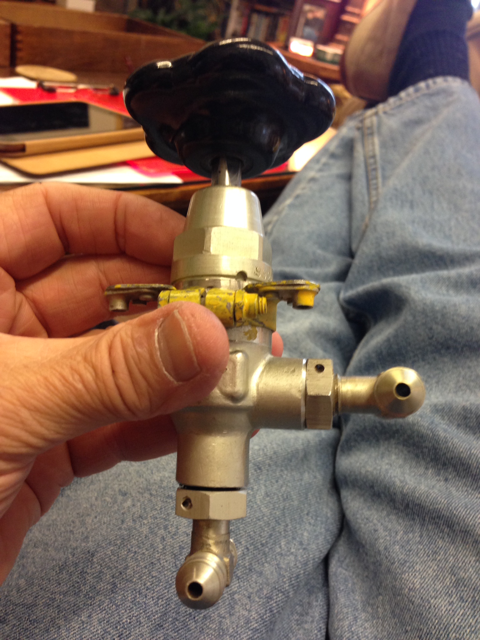

Folks: looking for a main air valve. Anyone have an idea where one can be found? I've tried Doug and Jill.

How many do you need? I have a few.

Why would you possibly want to install those shitty russian valves?  Do yourself a favor and retrofit to Swagelok (or similar) 1/4 turn valve - a very simple retrofit, but a huge improvement.

Dee: Do you have photos, what type of valve, etc. for the conversion?

Can you share the part number of the compatible Swagelok valve?

Hi - don't have that handy, but I used 1/4" valves in all my Yaks - the lines in the yak are 6mm, so easiest way to adapt is to buy swagelok 6mm to 1/4" union adapters, and then splice in a short run of 1/4" tubing.  I use these valves on the main and also emergency valves  - WAY better than the russian valves and never leak.
