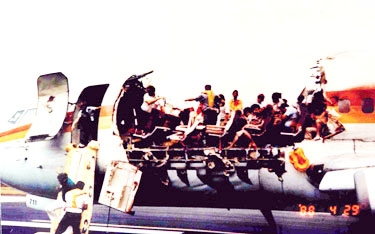

For example, flown long enough, the wings on EVERY aluminum
airplane are going to break off. This is because aluminum,
unlike steel, has a stress-to-cycles plot that never goes
'flat'. If you stress and relieve a steel part to maxiumum
ever expected loads 10,000,000 times without breaking
it, the part is considered 'golden' and will last forever.
Aluminum has no such feature . . . it eventually fails at
any stress loading . . . the cycles may be very high but
there is no flat spot on the s/n curve to failure. Hence
you see a totally different approach for the design setting
service limits for qualification of structural parts on
airplanes. Approaches that have continuously evolved over
the years particularly in response to incidents like this . . .
[img]cid:.0[/img]
An alternative technique for making design decisions
can be adopted for items that are not immediately
catastrophic. The generally categorized by criticality
level not unlike software under DO-178 . . .
