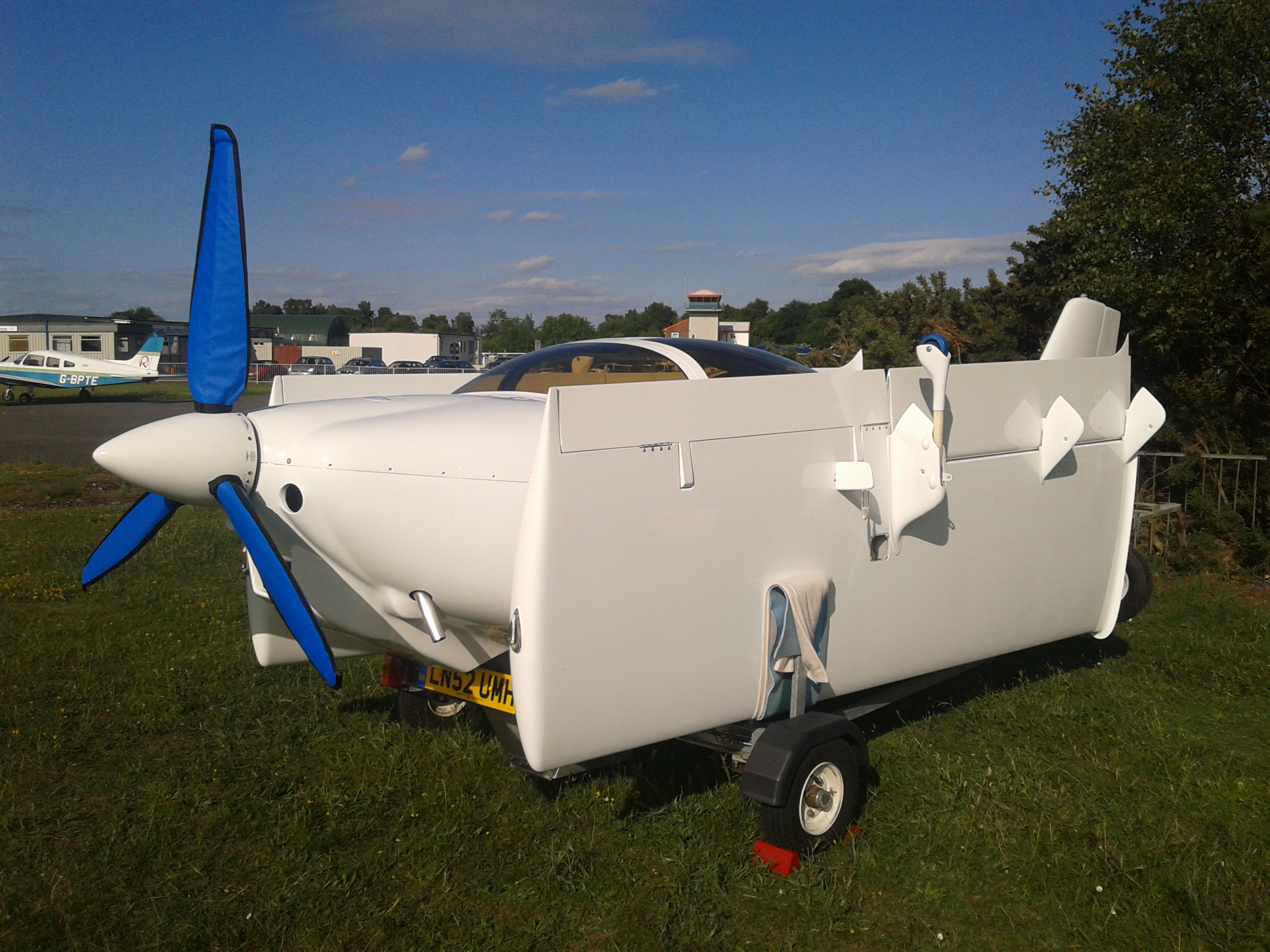

I fitted the Aveo Powerburst position/nav/strobe on the wingtips, and the Posistrobe MiniMax position/strobe on the fin.
They use 9-18V DC power (x 2 wires to allow separate nav and strobe use) with no separate power box/controller, then just an earth and sync wire so all strobes flash in time.
www.aveoengineering.com/index.php/product-info-powerburst
www.aveoengineering.com/index.php/product-info-posistrobe-minimax
www.aveogroup.com/aveo-shop/19-aurora-e-series
Both are just visible in the attached photo and, although I haven't flown with them, they seemed very bright during testing.
