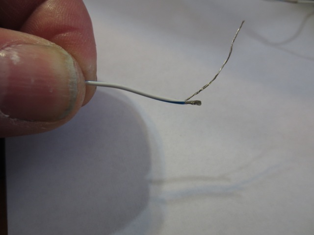

I need to split a shielded wire into 2 pins on on a DSUB. I am sure that what I did would be an acceptable approach but is there a better way?
this is a 2 conductor shielded wire. I have already added a pigtail using a solder sleeve
thanks for the help
I striped off a 1/4 inch strip of insulation about 1 1/2 inches back from the pin
I [img]cid:37A4A777-BAA1-4976-82BC-EDD67F3CDB41(at)home[/img]

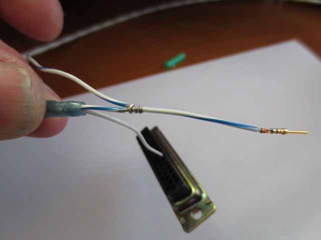

following Bob’s comic book on splicing wires i teased out a couple of strands of the wire to be joined
[img]cid:EBF15593-B0E3-40D1-BD4A-3EC3183C63DD(at)home[/img]

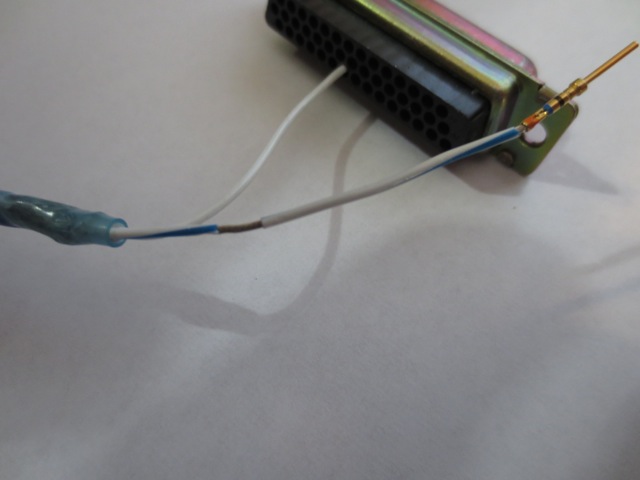

Wrapped and soldered
[img]cid:F98E29ED-F00A-4BC3-A4DA-E9CB10CC7324(at)home[/img]

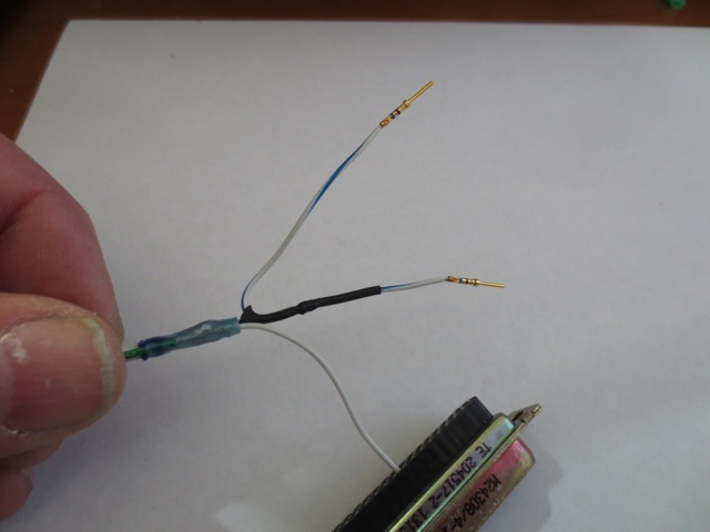

added shrink wrap and crimped on the pin
[img]cid:4F612A8E-59EB-4674-BBF3-753D96D26E1C(at)home[/img]

That’s a perfectly acceptable way to do it; I have used that method many times without any problems.
Jay

Works good, lasts a long time . . .
