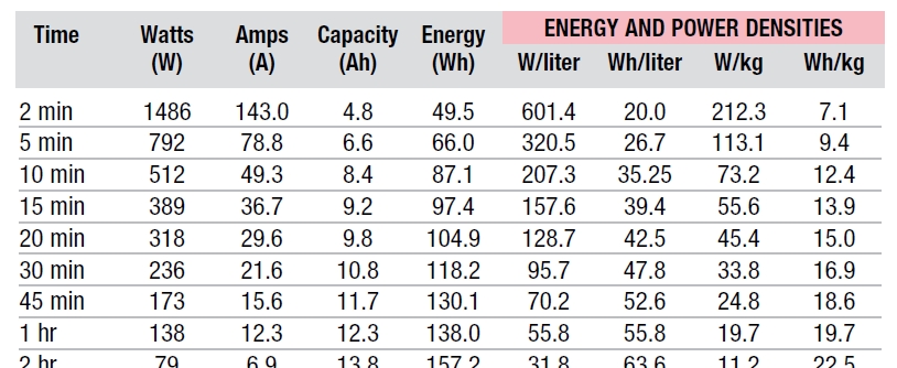

Tying this back to the venerable PC680 . . .
[img]cid:.0[/img]
We see that teh PC680 at the 1-hour rate is a 12.3Ah battery
when new. A 175W airplane will say lit up for about 45 minutes on
a new battery.
