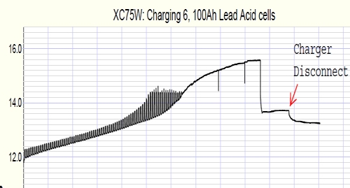

Bought a XC75W with nice buttons, annunciators and digital
display. Max charge rate was advertised as 20A. The first
time I plotted a recharge in the "AGM" mode, the charger
wanted to top-off charge at well over 15 volts. It had
barely leveled off at 15.7V when the microprocessor deemed the
battery charged!
The battery wheezed and whistled for a couple hours after
the charger shut down.
[img]cid:.0[/img]

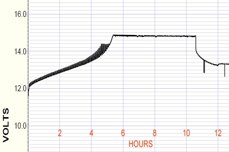

On the next cycle, I used the "GEL" mode. This mode tops off
at 14.4V . . . can't speak to ideal protocols for GEL batteries
but this looks like a good one for AGM as well. It's interesting
that it spent about as much time in top-off as it did for
charging.
[img]cid:.1[/img]
Will learn more about this charger as testing progresses
on the battery. I may see if Schumacher's engineering staff
will comment on these findings . . . but in any case,
AGM mode in this charger is not recommended for any battery.
