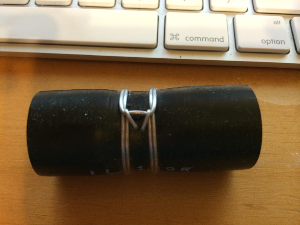

PostPosted: Thu Mar 13, 2014 7:58 pm    Post subject: sealing fuel lines Reply with quote
William,
I believe Graham was talking about this:
http://www.aircraftspruce.com/pages/to/safetywiretools/clamptitetool.php
I have one and it works surprisingly well where you have enough room to maneuver the tool.
The resulting clamp looks like this”
[img]cid:A0FE31C4-702E-4D77-AC5D-C66323481CCE[/img]
This is a double wrap. It can also be done as a single wrap.
Blue skies & tailwinds,Bob BorgerEuropa XS Tri, Rotax 914, Airmaster C/S Prop (50 hrs).Little Toot Sport Biplane, Lycoming Thunderbolt AEIO-320 EXP3705 Lynchburg Dr.Corinth, TX 76208-5331Cel: 817-992-1117rlborger(at)mac.com (rlborger(at)mac.com)

wdaniell.longport(at)gmai
PostPosted: Fri Mar 14, 2014 5:57 am    Post subject: sealing fuel lines Reply with quote
Got it thanks. looks very neat.
What wire does it use?

rlborger(at)mac.com
PostPosted: Fri Mar 14, 2014 6:41 am    Post subject: sealing fuel lines Reply with quote
Will,
It can use any size safety wire. Heavier might be less likely to cut into the hose.
The instructions are out in the hanger. Next trip to hanger I’ll bring them home to scan and provide to list.
The video on the ACS website says any kind of wire will do. Watch the video it is excellent.

William,
[img]cid:1.2441769615(at)web87701.mail.ir2.yahoo.com[/img]

On Mar 14, 2014, at 9:40 AM, Robert Borger <rlborger(at)mac.com (rlborger(at)mac.com)> wrote:
Will,
