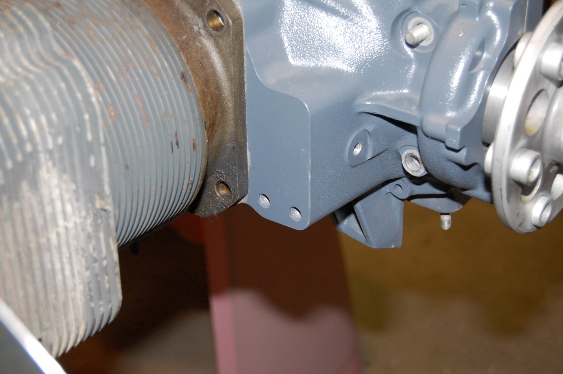

I’m using an IO-540 C4B5 off of an Aztec that’s built up as a dummy core for now so I can do the initial cowl and baffling work. The case halves are the actual ones that will be used on final re-assembly of the motor. The issue I’m seeing is a missing boss mount hole for the CB-1002E fwd left support bracket that backs the fwd left air ramp baffling. Has anyone that’s used a C4B5 ran into this? I presume the hole can be carefully located and drilled and tapped but thought I’d ask the brain trust. See attached photos.

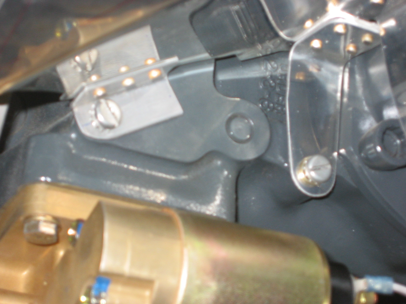

Yes, I had that on the engine of my first RV-10.  My solution was to make a replacement bracket to fit a hole outboard of what was shown in the plans.  Picture (fuzzy) attached to give you an idea of what I did.  Never heard of anybody else having this issue so I just made a replacement out of 3/4 angle and moved on.  Hope this helps.

The hole you see to the right is not where it goes. That will be filled similar to Bob’s pic once the motor is assembled for real. It’s actually in the boss mount area to the left of the gaping hole. I assume the C4B5 had no reason for an accessory to mount there so Lycoming did not drill and tap that hole.
I did not think about making the smaller front hole work with a custom bracket. I guess I sorta figured that would be used for something else and just dismissed it. Good to know I’ll likely go this route.

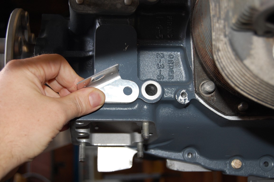

Just for the record the right side has a similar boss mount area that does have holes drilled and tapped thus my assumption was the left side would support it. The attached photo shows the right side for reference. I’d much rather use the existing front hole than risk f’ing up the case that’s for sure.
Again, thanks and glad I asked. I must subconsciously love to do things the hard way as I was pretty much resigned to drill and tap before Bob pointed out what should have been obvious! Ah tunnel vision.

For the further record… I checked on the reason for that ½” hole right of the boss mount seeing that Bob’s appeared to be plugged.  That is for a through bolt that is just not currently installed on my “fake” motor.  Bob’s picture showed what appears as a plug bit is really the back end of a bolt.   His case must be an older vintage where the through bolt threads into the case half, newer ones get a heavy nut and washer instead.
