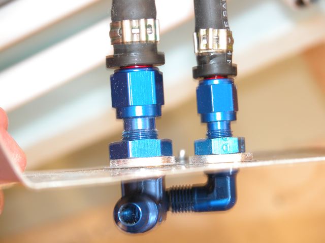

Will…I too used automobile injection hose aft…here’s how I penetrated the firewall and transitioned to SS jacketed flex hose forward…Good luck, Fred

I guess I was hoping for a straight connection without the fittings...but that looks really neat.
Will

Will…bear in mind that mine is for a non-Rotax engine installation…the 90 degree fittings worked best.
Note that the fittings are aluminum Aeroquip…I’ve received a comment from one lister cautioning me against using aluminum fittings FWF on all fuel and oil lines, recommending brass (at the least) and preferably steel.
Such a practice was news to me…additional comments welcome and invited.
Fred

Any sort of fitting adds weight and leakage possibility. Going straight through the firewall with the hoses immobilised on both sides, with the passage sealed by silicone adds nil weight ,no leakage possibility and works in the sense that having already replaced hoses twice on a five year life basis, the pipes showed no sign of chafing wear. Why complicate things?
David,
Thanks for the description of your installation as well as your report of trouble-free operation over a ten year period…yours is simplicity itself, and I salute you for it while I also admit to envy of your accumulating all the hours of airtime which you have while my kit remains in my workshop.
I suspect that one person’s “complication” may be another’s sense of “proper kit”, both being subjective assessments for dealing w/ the task at hand, whatever it may be…and...a reflection of one’s “comfort zone”.
In my case, I recall a sense of discomfort at the thought of simply running a rubber hose w/ fuel under high pressure through the firewall…I was also keen on matching the FWF SS jacketed fuel line which my engine supplier had already used connecting the injector rails…the firewall seemed like the logical place for the transition, and the weight of the aluminum fittings was not a detriment for me.
As my fuel lines are under high pressure for a fuel-injected engine with the pumps located aft, I paid little attention to the build manual references to routing of the low pressure fuel lines for the Rotax engine, relying instead on an old dog-eared copy of an EAA publication, “Firewall Forward” by Tony Bingelis.
What I’ve done made perfect sense to me at the time the work was being done…
Cheers,
Fred
