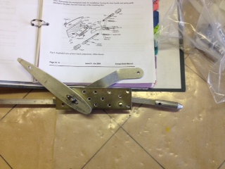

Hi guys & gals, Thanx for your help regarding door fitting - coming along
nicely. Got a problem with the door latch. as you can see in the attatched
photo. With the inner handle in the fully closed position, the outer handle
is cocked up at 40 degees to the horizontal ??? I'm assuming it should be
horizontal - streamlined into the airflow. I followed the instructions to
the letter & as you can only ever change the positions of the handles by 90
degrees, whats gone wrong ??? Any ideas please Paul Munford trigear kit 625.
Thankyou

You may have fixed the anchor nut on the wrong side of the Handel ???

Try swapping the handles

try turning the handle over, (inside face to outside) You nned to take the anchor nut off, so have a look and think about it
first!

As ever, you guys are great !!! You were right, - by swapping handles, everything fell into place (wish I had a brain ???!!!). Thanx again. Paul Munford. Trigear kit 625
