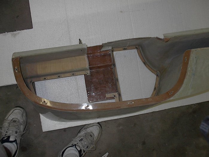

Fred Klein
Joined: 26 Mar 2012
Posts: 503
PostPosted: Tue Mar 04, 2014 1:08 pm    Post subject: instrument module wider than firewall - what to do? Reply with quote
On Mar 4, 2014, at 11:03 AM, Rowland Carson <rowlandcarson(at)gmail.com (rowlandcarson(at)gmail.com)> wrote:
Have I been issued with a mis-matched instrument module & fuselage moulding?
Rowland…I would tend to doubt that; however, I found that the exterior flange, when trimmed to allow the insertion of the instrument panel module into the fuselage, was insufficient. Consequently, I mounted an inside flange which allowed me to use shock mount bolts which provide a 1/2” space between module and firewall, useful for both vibration isolation as well as providing a means of cooling air circulation…a couple of the shock mounts are visible thru my initial cut-out for my instrument sub-panels…Good luck,
Fred
[img]cid:873D7FDD-656D-4918-9133-152D7ABC7F02[/img]
 Filesize:  44.95 KB
 Viewed:  1473 Time(s)

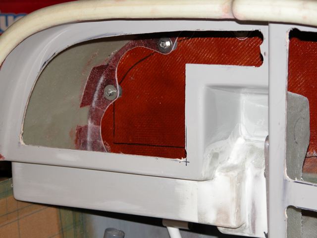

PostPosted: Sat Mar 08, 2014 8:42 am    Post subject: instrument module wider than firewall - what to do? Reply with quote
<?xml:namespace prefix="v" /><?xml:namespace prefix="o" /><![endif]--> Rowland,
This message was delayed by my aging shop computer.
Bud
