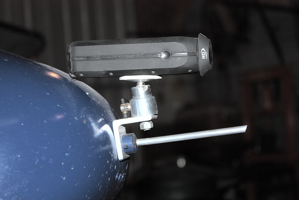

 I have included a jpeg of where I mount my drift, and I shoot it on full HD. This is the only spot on my plane that I can find that will not turn the film into "jello". When I cut the throttle however it will wave a bit until it gets past a certain rpm or speed, but is quite steady the rest of the time. Drift has a remote, so I can start it or shut it off when I need.
