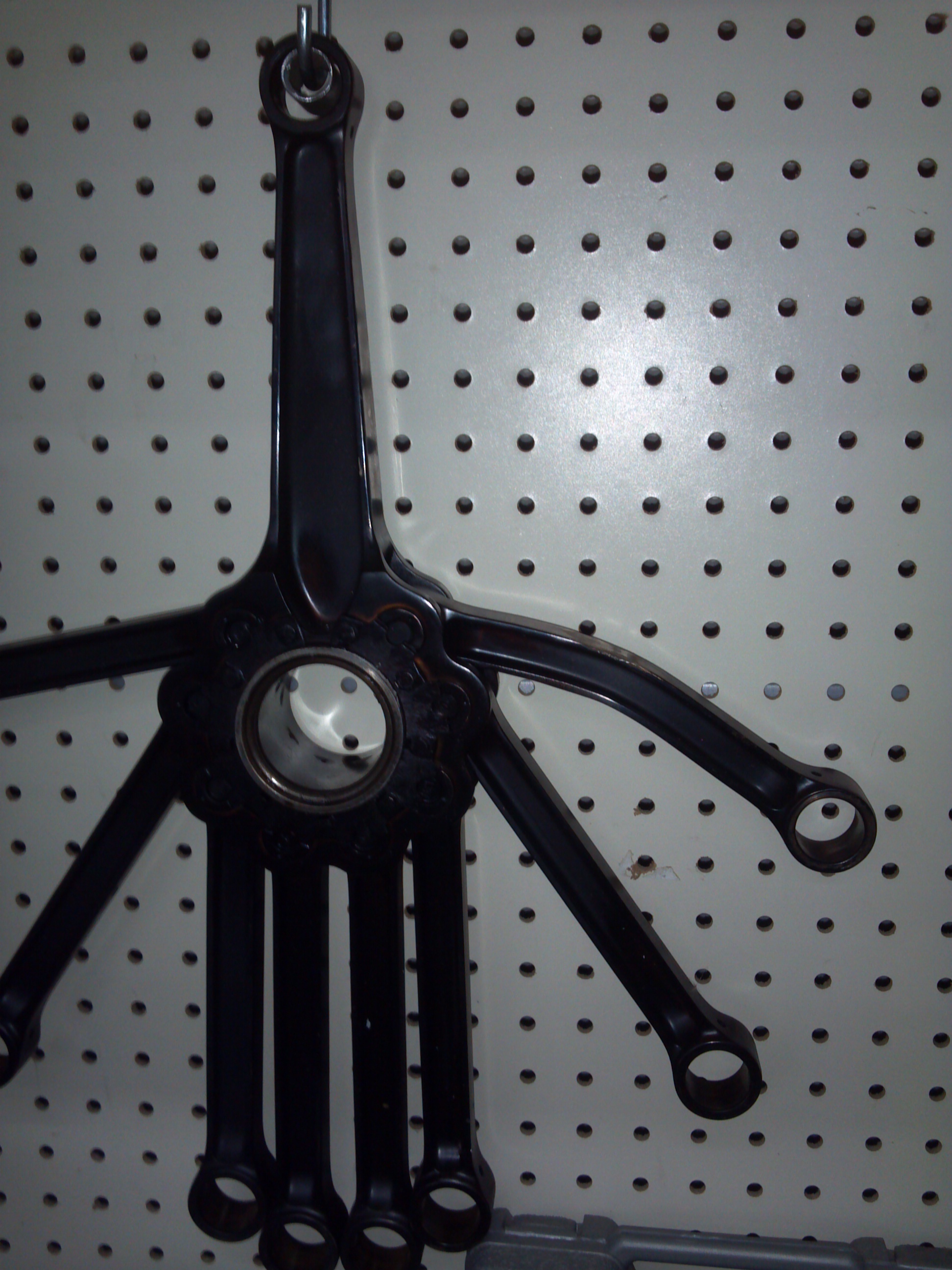

You can bend a rod with just the air starter and can do it just as easily hand propping it with too much force. Big round engins have a clutch in the starter that diengages if it hits a hydrolock. You don't.

Follow the advice of the people that posted checking for a hydro lock by feel. Do not use the starter unless you want what happened to this poor sole's engine. Was a $20K mistake. You CAN way over prime and do it with fuel as well. If the engine stops no matter how long I always check before starting again. Cheap insurance. Make sure you have intake drains as well on the lower cylinder intake tubes.
 Filesize:  938.04 KB
