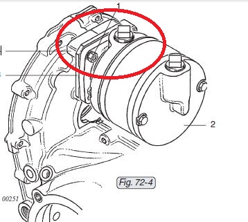

PostPosted: Sun Feb 16, 2014 1:12 pm    Post subject: Oil Thermostat Reply with quote
Mocal A0T2-7 -8AN Male. Mount where vacuum pump would mount.

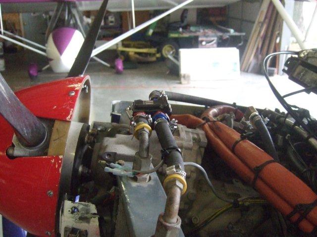

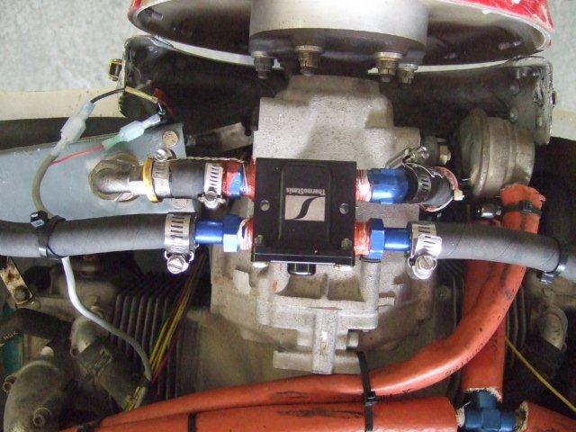

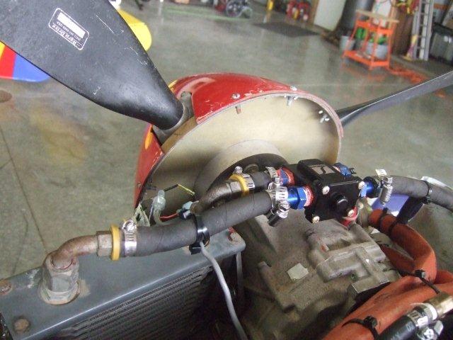

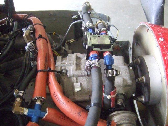

PostPosted: Sun Feb 16, 2014 2:31 pm    Post subject: Oil Thermostat Reply with quote
Richard
For what it worth, here are pictures of a THERMOSTASIS oil thermostat  installed on 912ULS in my RANS S6S
Works perfect for me
Nati
