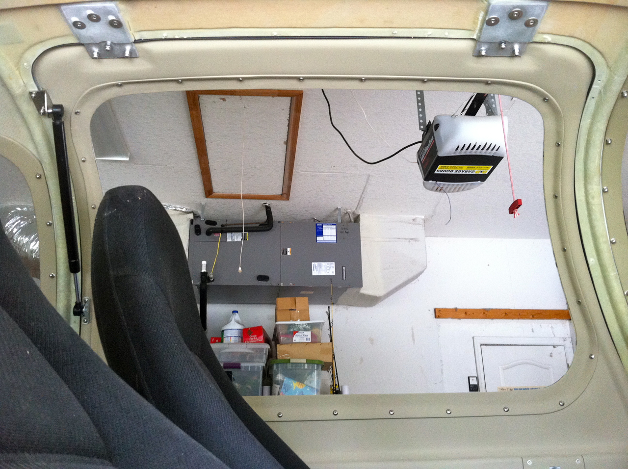

I had to replace the door window also.  I removed the cracked one the way Bob described .  Cutting the skin on the inside and around the window. then prying it loose.
Before doing anything, I made layups for a retaining bracket that is removable for easy window renewal in the future.  See picture worth a thousand words.

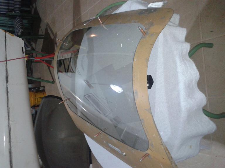

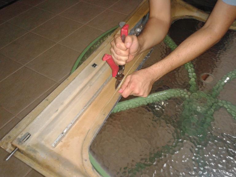

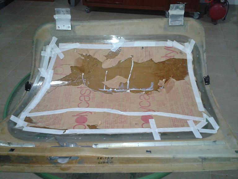

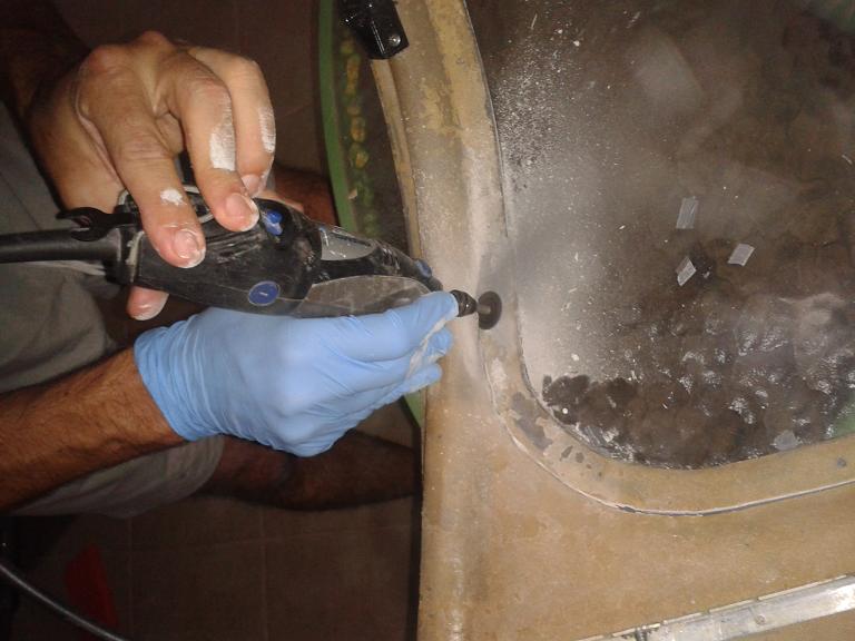

PostPosted: Wed Feb 12, 2014 4:44 am    Post subject: Re: KIS TR-4 Door Window replacement procedure Reply with quote
Bob,
I don't have pictures of the delamination process. We used a screwdiver with care.
After delamination, the original window was cut and broken in several parts to remove it from the frame. The initial idea was to install the new window without cutting the frame.
Later we discovered that this is not possible....
Pictures bellow.
Fabricio
cracked window after removal.
 Filesize:  76.35 KB
 Viewed:  6487 Time(s)
cutting door frame with snips.
 Filesize:  71.63 KB
cutting door frame with dremel
 Filesize:  70.28 KB
New window ready to be bonded
 Filesize:  61.64 KB
