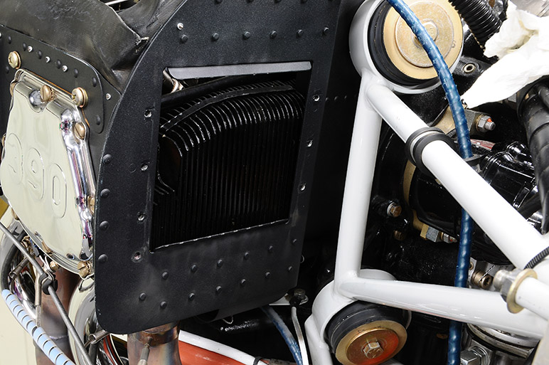

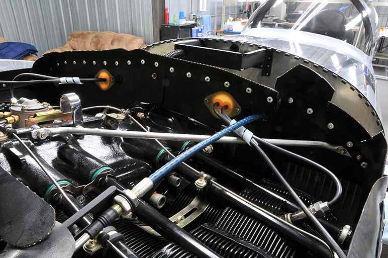

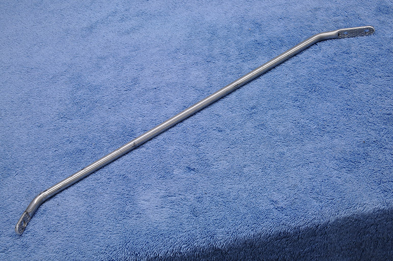

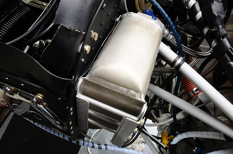

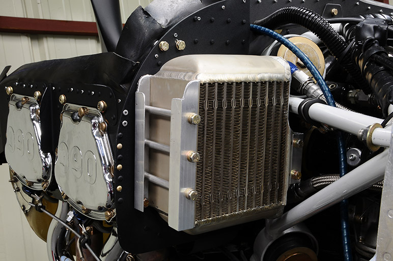

I thought the source of the cracking had been addressed. I had some issues with the left-rear baffle flange cracking too in the beginning. I made the rear baffle nice and strong, but used the stock left-rear piece which was .032. It just wasn't up for the task. I later added a cross strut from the crankcase just ahead of the hoist loop all the way back to the left rear corner and added some .063 angle stiffners over the oil cooler flanges for additional support. I'm wondering if I cracked the flange today taking the oil cooler off. It was pretty stuck on and I was having to do a fair amount of prying to get it to separate from the gasket. I would have been more careful if I'd of realized those flanges are made out of such crappy pot metal. Man, they are soft.
Since I'm rebuilding, I decided to rebuild the left-rear baffle part and was taking the oil cooler off today to accommodate that. That's when I noticed the crack.
Attached are some pictures of the setup prior to disassembly today.
Matt
