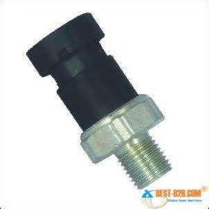

There's nothing inherently risky about mounting
a sensor right to the engine. It's done on cars
all the time . . . and probably less vibration
stress. Consider this oil pressure transducer.
[img]cid:.0[/img]
All steel structure, short moment arm, light
mass . . . risk approaching zero.

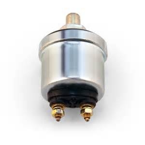

Consider this one . . .
[img]cid:.1[/img]
Hmmm . . . fatter, longer, but still steel . . .
probably still okay plugged right into the engine.
But consider the installation that demands
multiple 'sensors' . . . say one of these
fat rascals, stuck into a brass tee-fitting opposite
a low oil pressure warning switch. Now put
a not-so-close brass nipple. The high risk
joint is where the brass screws into the
engine with all that stuff hung off the
end.
There's are ancillary concerns for deciding
whether or not to mount a sensor directly
to the engine . . . temperature and vibration
effects on the transducer itself . . .generally
low risk but a question to ask and answer.
I might be wrong, but these are the questions I'd ask: How stiff is a braided oil line when it's fully pressurized while the engine is running? What does it weigh? How much vibration gets transmitted up the fairly stiff pressurized line? How does that weight & vibration affect the cantilevered *aluminum* adapters connecting it to the pressure sensor? I suspect that the cantilevered weight of the hose is more than the weight of the sensor, on its steel mounting threads, and there will still be a lot of vibration transmitted to the fittings.
Am I mistaken?
Stresses that a flexible line would put on
the threads at the engine are minimal . . . if
the threads are steel . . . the risks are zero.
Risks risk sharply with high moment installations
on rigid, brass, pot-metal or aluminum, christmas-trees.

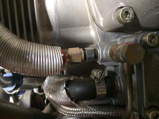

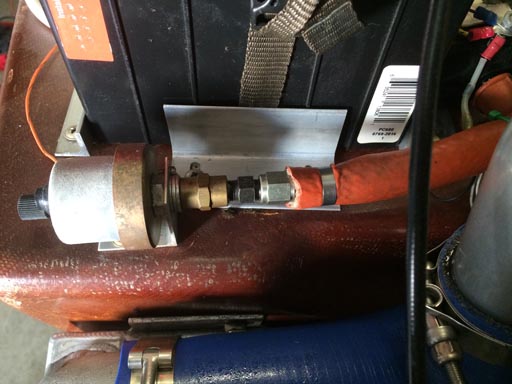

Hi Charlie,
My original concern for having the oil pressure sender mounted on the engine was a result of a series short time of oil pressure sender failures which were reported on the Rotax and Europa lists a number of years ago. Due to the placement of the sender on the engine it was surmised that these were failures from the sender being repeatedly shaken during engine start and stop. The recommendation was made by someone on the list that the sender be removed from the engine and remote mounted on the firewall to get it out of the vibrational environment of the engine.
In my case I used a length of Aeroquip 666 1/8” hose which is braided stainless steel over teflon with stainless steel fittings. I have never weighed the line but it isn’t very heavy. Just went out to the shop and weighed a similar length of 666 with fittings and it weighs 2 oz. I doubt it is any stiffer pressurized than it is unpressurized. There are no aluminum fittings connecting to the engine. A steel AN fitting was used to connect the hose to the engine. The weight of the hose as supported by the engine fitting is considerably less than the weight of the sender ~16 oz. Considerably less than an ounce on the fitting. I have confirmed that there are no vibrations being transmitted through the hose back to the sender or its fittings. The hose seems to do a good job of absorbing rather than transmitting vibrations.
Hope this helps.

Hi Bob,
I do understand worrying about stress & vibration issues. What caught my
attention was what appeared to be aluminum adapters on the pressure
sensor itself, cantilevering the right angle adapter and hose away from
the sensor's mount. I could imagine the aluminum adapters being at risk
more than the steel threaded sensor.
What was the nature of the failures? I was envisioning the sender
breaking off at the threads. Was it some sort of internal failure,
instead? Most current RV-x builders do remote mount the sensor, but they
seem to survive on a lot of motors when they are direct- mounted. If
there is a high percentage of failures on the Rotax, I wonder if it's
caused by the very different frequency of vibration from the Rotax,
compared to most other engines running at constant-RPM.
Charlie

Years ago while touring a rotax overhaul facility I noticed the vdo
electro-mechanical pressure senders had a significant added weight
attached to them. The story was that this was to lower the resonant
frequency below what the engine would excite to prevent them from
breaking off. Those engines run at twice the rpm that a Lycoming runs at.
ken

Charlie,
Yes, there are Al fittings on the sender in the pictures. They were only for test fitting purposes. Matter of fact, the installation ended up quite different from the build pictures. I ended up using a longer length of 666 which was routed over the engine to the sensor. It was covered in firesleeve & heat shield and tied off a couple times along the way. I also used steel fittings on the sensor. The aircraft is down for some repair work and Annual Condition Inspection so I was able to take some pictures today.
[img]cid:5A82E680-55F2-4062-A706-C04743AD60C9[/img]
[img]cid:E14A28D5-58F4-43DA-9410-C9006979AA2B[/img]
Vibration transmitted to the sensor is pretty close to zero.
The oil pressure senders died from internal failures. The either stopped sending or sent invalid readings. There were no physical failures of the attachment to the engine. Those only seemed to occur when additional fittings were installed between the sender and oil pump.
As was pointed out in another e-mail, a brass weight ring was added to the sender to modify the harmonic frequency and reduce vibration issues. I don’t know if this was effective or not. Haven’t seen any complaints of oil pressure sender failures for a couple year.
Yes, there are much different vibration issues with the Rotax. Cruise RPM in a 91X is 5000 to 5500 RPM. There’s a 2.43:1 gearbox to the prop so it is turning at .41 of the engine speed. All these things make for a challenging vibrational environment.
I’m presently building a Little Toot Sport Biplane and I will probably direct mount the oil pressure sender to the engine as it is a Lycoming IO-320.
Blue skies & tailwinds,
Bob Borger

PostPosted: Fri Feb 14, 2014 10:31 am    Post subject: engine pressure senders installation Reply with quote
At 12:56 PM 2/13/2014, you wrote:
<ceengland7(at)gmail.com>
Hi Bob,
Yes . . . that's the bottom end of the moment arm
upon which mass of the attached hardware is vibrated.
Was it some sort of internal failure, instead? Most current RV-x
builders do remote mount the sensor, but they seem to survive on a
lot of motors when they are direct- mounted. If there is a high
percentage of failures on the Rotax, I wonder if it's caused by the
very different frequency of vibration from the Rotax, compared to
The short, low mass sensor is just fine threaded into
it's designated port on the engine. It's the extension
with non-ferrous materials and adding more mass on the
end that sets up the scenario for failure.
