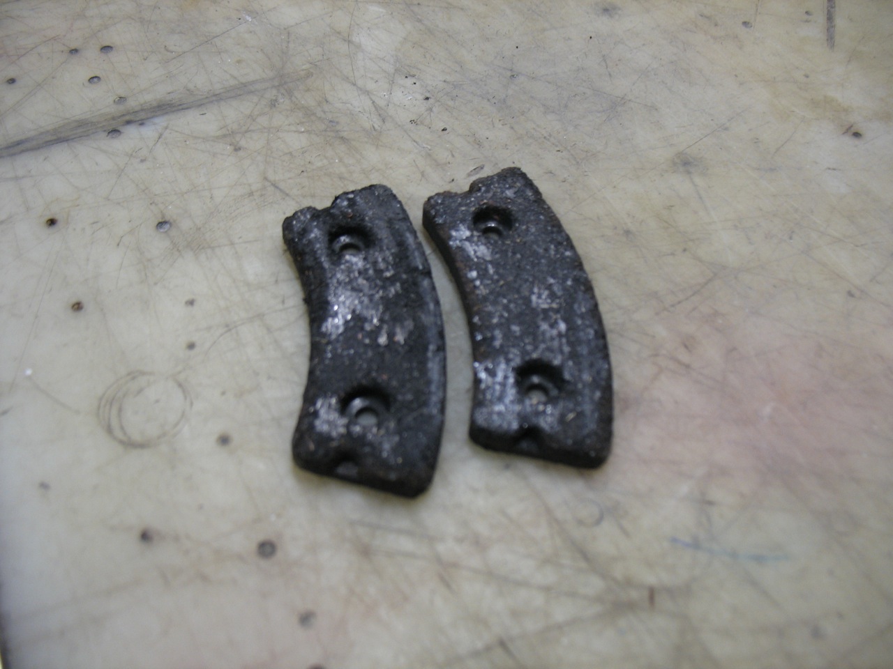

well i tried the cheaper rapco brake pads. i had a caliber leak and although the pads had only 40 hours on them they wore unevenly. My regular mechanic said to replace them.
Has anyone else had problems with the Rapco pads?
Alan

Having pads uneven is not a problem. Having petroleum on them in the form of 5606 is. A thorough cleaning with BrakeKlean to remove the 5606 can resurect a pad if there is enough thickness to justify. Also, if you decide to replace, just do the caliper that needs pads. No need to do the other side.
Kelly

kelly,pads had enough thickness but my mechanic didn’t like the the way they looked.
alan

Being experimental, it is your choice to take his advise or ignore it.
Looks are not one of my criteria.

PostPosted: Tue Feb 11, 2014 5:01 pm    Post subject: rapco pads Reply with quote
[img]cid:3D649459-3ACE-4539-BFFB-6DC6B620EABE[/img]
On Feb 11, 2014, at 5:07 AM, Alan Mekler MD <amekler(at)metrocast.net (amekler(at)metrocast.net)> wrote:
[quote]--> RV10-List message posted by: Alan Mekler MD <amekler(at)metrocast.net (amekler(at)metrocast.net)>
no i didn’t build my plane so i need a mechanic. both my A&Ps have built and own RVs.

Kellym
Posts: 1706
Location: Sun Lakes AZ
PostPosted: Tue Feb 11, 2014 7:00 pm    Post subject: rapco pads Reply with quote
Yep, no question, replace.

PostPosted: Tue Feb 11, 2014 7:12 pm    Post subject: rapco pads Reply with quote
Those don't look so good. Are there any strange environmental
situations that you store or fly the airplane in?
I've had Rapco pads for about the last 3 or so changes now,
and they really look just like the Cleaveland ones pretty much
when they're worn down....and they have worked well almost
all the way down to the rivets. So I'm curious if there is
some strange environmental things going on.
Tim

PostPosted: Tue Feb 11, 2014 7:46 pm    Post subject: rapco pads Reply with quote
what does the brake disc look like? these look like they are relatively unused but almost like something effected them. Replacing was a good call, but what caused this that may do the same thing to the new pads?
BTW- I did not mean any disrespect to the A&P, I was simply mentioning that I don’t always trust what they tell me about my airplane. in this case he made a good call. It’s not the Rapco its something the pads are reacting to is my guess.
I would send this picture to Rapco and get their feedback.
Pascal
