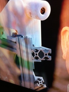

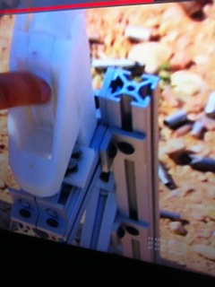

Gidday,I saw this product recently and realise it has great jigging potential, with variable positioning along its entire length. Does anyone know what this product is and where to get it, as I have a couple more jigs to make and would like to give it a go.
Reg
Tony Renshaw
Sydney Aussie.

I also use this stuff to build frames to hold equipment and various
items in place. I think it is also referred to as T-slotted aluminum
framing. McMaster carries a bunch of them.
On Sun, Feb 9, 2014 at 5:03 PM, <rparigor(at)suffolk.lib.ny.us> wrote:
Hi Tony
80-20
http://www.8020.net/
Look on E-Bay too.
Ron Parigoris
