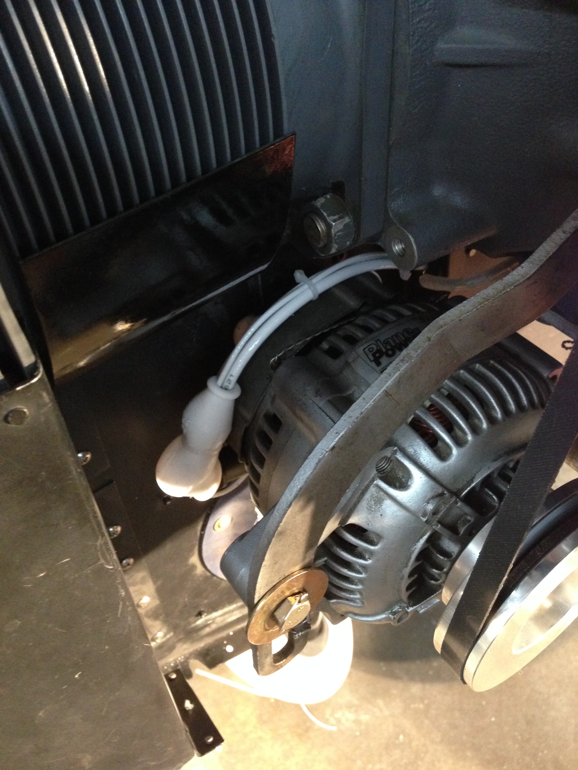

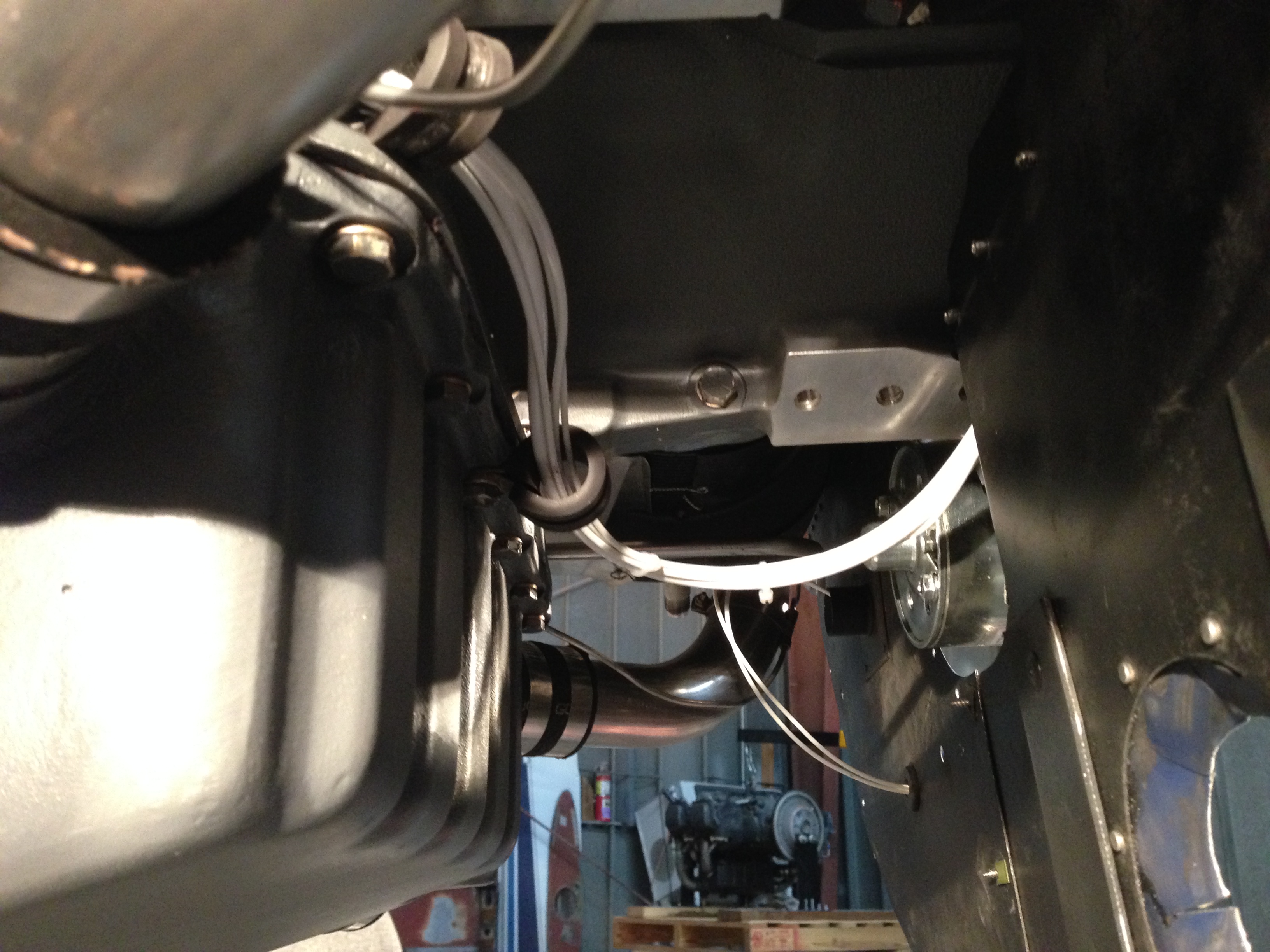

To those who've installed a Plane Power Alternator, you may have noticed the terminal is just opposite the hole in the baffle where the wire is supposed to go. VERY bad setup. The terminals should be rotated 90 degrees one way to the other.
I made my own pass through with all new wires. Much nicer.

Hello Gary, What type of Grumman is this on, Tiger?
Did you make up new longer wiring?

All new wires. I'll take another pic when the baffles are done.
