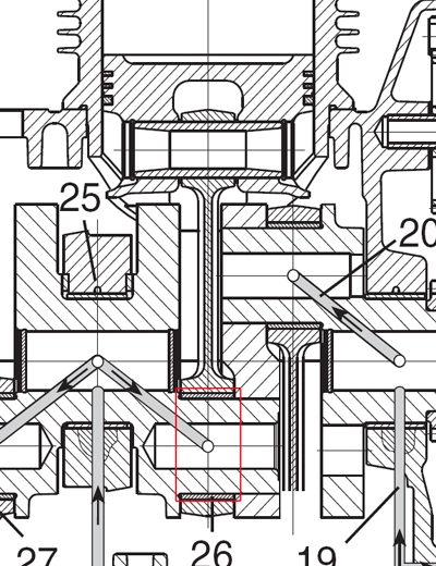

6) The ability to use roller bearings. (I have no idea if they actually should or do).
Interesting point to ponder . . . if they do use
roller bearings, then in no way will a loss of
lubrication put a destructive torque moment on
the crank end of the rod in a mere ten seconds
of running . . .
but no . . .
This excerpt from the 912/914 maintenance
manual . . .
http://tinyurl.com/mresg6r
suggests that the classic pressure
lubricated sleeve bearings are used on the
connecting rods.
[img]cid:.0[/img]
As long as the rod and main bearings are good, the idea that the crank can come apart is simply a distraction. Porsche 4-cam racing engines used a similar design, although they keyed theirs. But Still... Your Mileage May Vary.
. . . I've not heard of crank disassembly
in the field . . . those engines have been
around for a very long time. It's hard
to argue with success!
A short web-cruise did turn up this crank
failure accident
http://tinyurl.com/lzhk22s
which failed to identify any errors of manufacture.
The press-fit technology is not a high-risk
process. Interruption fits of highly stressed
parts has along history of success.
Also found an AD against a production batch
of Rotax 912 cranks for suspected vulnerability
to cracking.
All incidents of slipped assembly joints
I found were byproducts of prop strikes.
I think there's a slip clutch mod that
reduces probability of a prop-strike from
over-torque slipping of the joints.
All in all, a pretty clean track record.

From the pics on the Europa site posted earlier, it clear they uses one piece rods. Only way to do that is with roller bearings and a press assembled crank. The main bearings seen are typical automotive style Babbitt bearings.
Also the blueing on the rod beam shows the amount of heat generated when the failure occurred.
Tim
