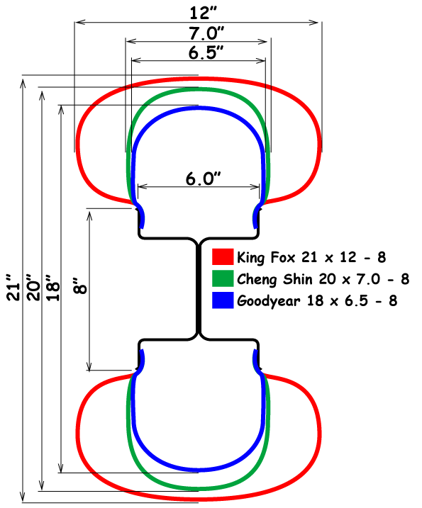

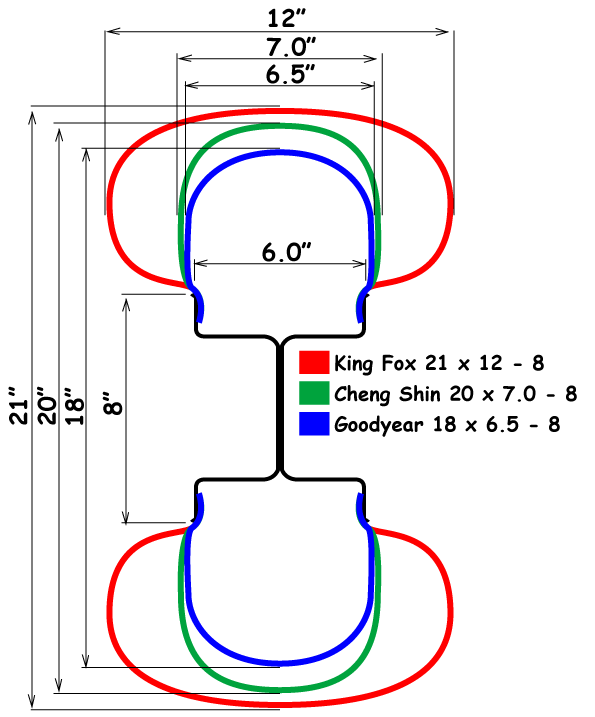

Please look at the enclosed drawing, John. I can't figure it out. Somewhere I must misunderstand something. How can a 12 inches wide tyre fit a 6 inches wheel?
PS: my drawing was done to scale. It should be pretty exact.
The Alaska tyres look great but ... they are for 6" wheels, aren't they?

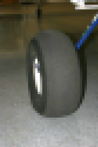

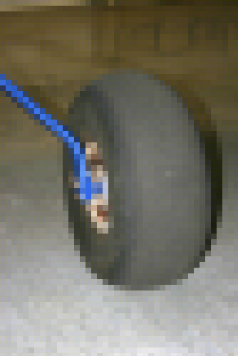

Michel, I just re-read you post, I think the wheels are 7" across the
beads and 8" dia. I just did a rough measure on an extra I have. The
previous post shows the tires mounted. They look puffy, but they work great
and I like them.
Lowell

Michel, the drawing is pretty accurate, but the cross section is more
round.

On Jun 13, 2006, at 4:24 PM, Lowell Fitt wrote:
I think the wheels are 7" across the beads and 8" dia.
Well, Lowell, I don't know anything about tyres and I may be reading
wrong and mixing different things. But in my Kitfox 3 Construction
Manual from Denney Aerocraft Company, I have, in the parts list:
2 LW-27R Wheels; main gear, aluminium, 8" dia., 6" wide.
I "think" that is what is called "rim width" in other places. And the
King Fox tyres state that the minimum "rim width" should be 7".
Also, I would think that any tyre is smaller at the "rim" than it
widest part. Since the Cheng Shin are 7" wide, I'd expect that their
"rim" is slightly smaller than that.

But ... it's a jungle out there, guys! First, it doesn't seem to be a
standard way of writing tyre sizes. Sometimes it says something like
650, sometimes 5. What unit are those? And it's from the same tyre
manufacturer and same web site.
Then there is the price. I see aviation tyres way above USD 100 and
others as cheap as ... USD 5!
What do you make of this:
http://www.ultralightnews.ca/suspension/tirestubes.htm
Is it something we can use on a Kitfox? Do you manage to make sense of
the type, the size and the price? I'd appreciate any help before I go
nuts and the men in white will have to come and take me away, ha-ha,
hi-hi, take me away, ha-ha, hi-hi! Smile

PostPosted: Tue Jun 20, 2006 5:31 pm    Post subject: Tires Reply with quote
Michel,
One last thought. When I responded, I was not focused on the wheel
penetration skis. A friend that came to the fly-in here had tires that
closely resembled the Cheng Shing, but he found a similar lugged tire and
spent three hours sanding the lugs off with a belt sander. They looked
pretty good. They have the round profile we are used to rather than the
flat tread that he found to be a real drag - no pun intended.
Lowell

PostPosted: Tue Jun 20, 2006 7:43 pm    Post subject: Re: Tires Reply with quote
[quote="Michel
[/quote]
Michel,
Try this website, I think it will clear up your confusion on tire sizes. It has about every aviation tire size out there and it gives you all kinds of different data points on a given tire. It even explains the three different sizing labels used in aviation. Read through the definitions and abreviations section then go to the Tire Data section. Hope it helps.
http://www.goodyearaviation.com/tiredatabook.html
Darin
