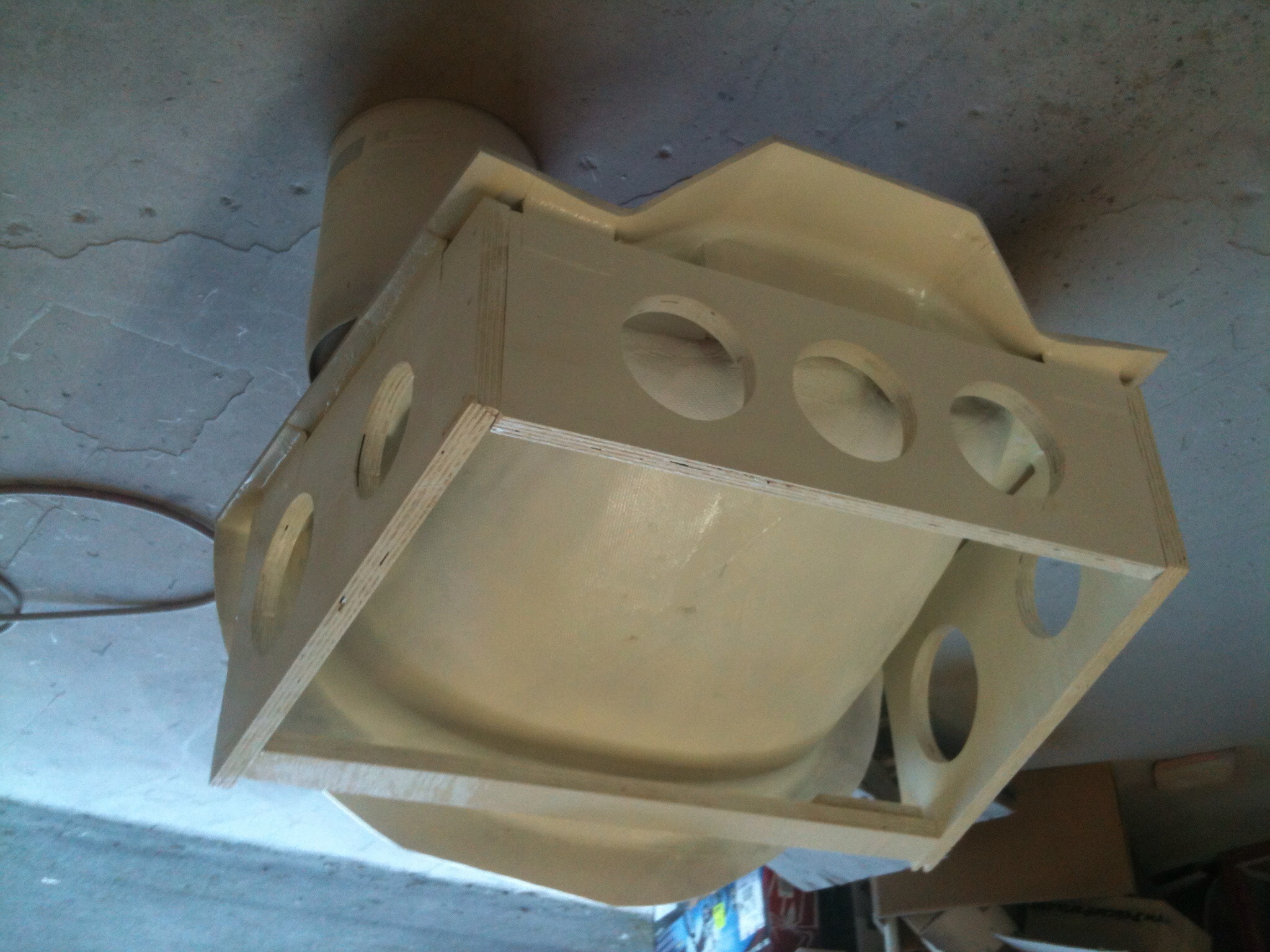

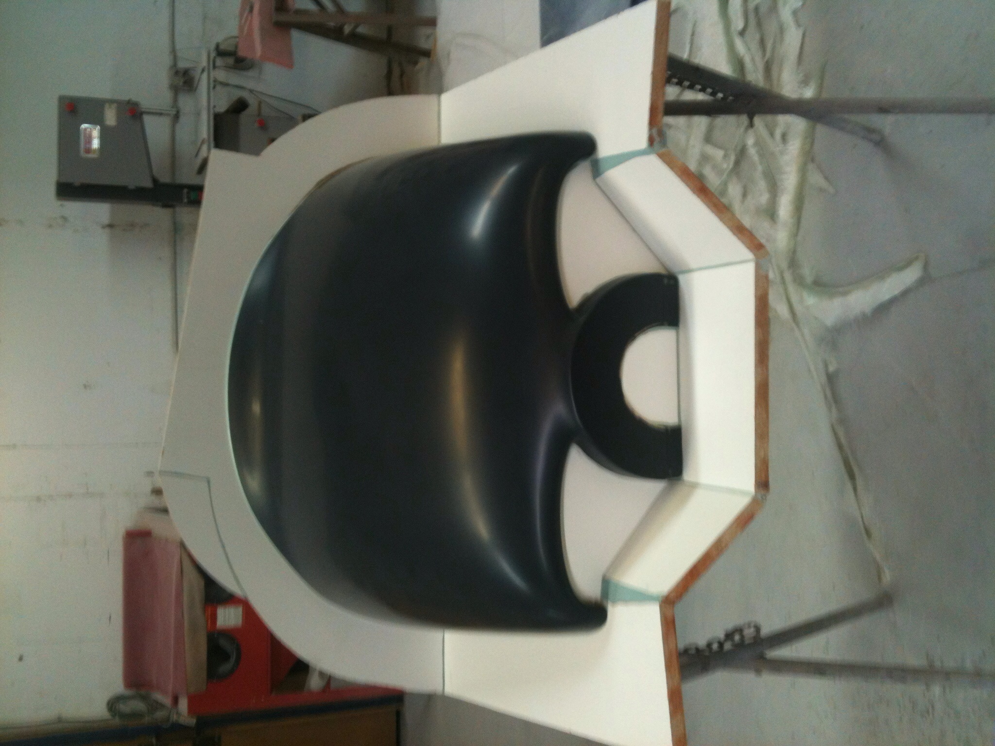

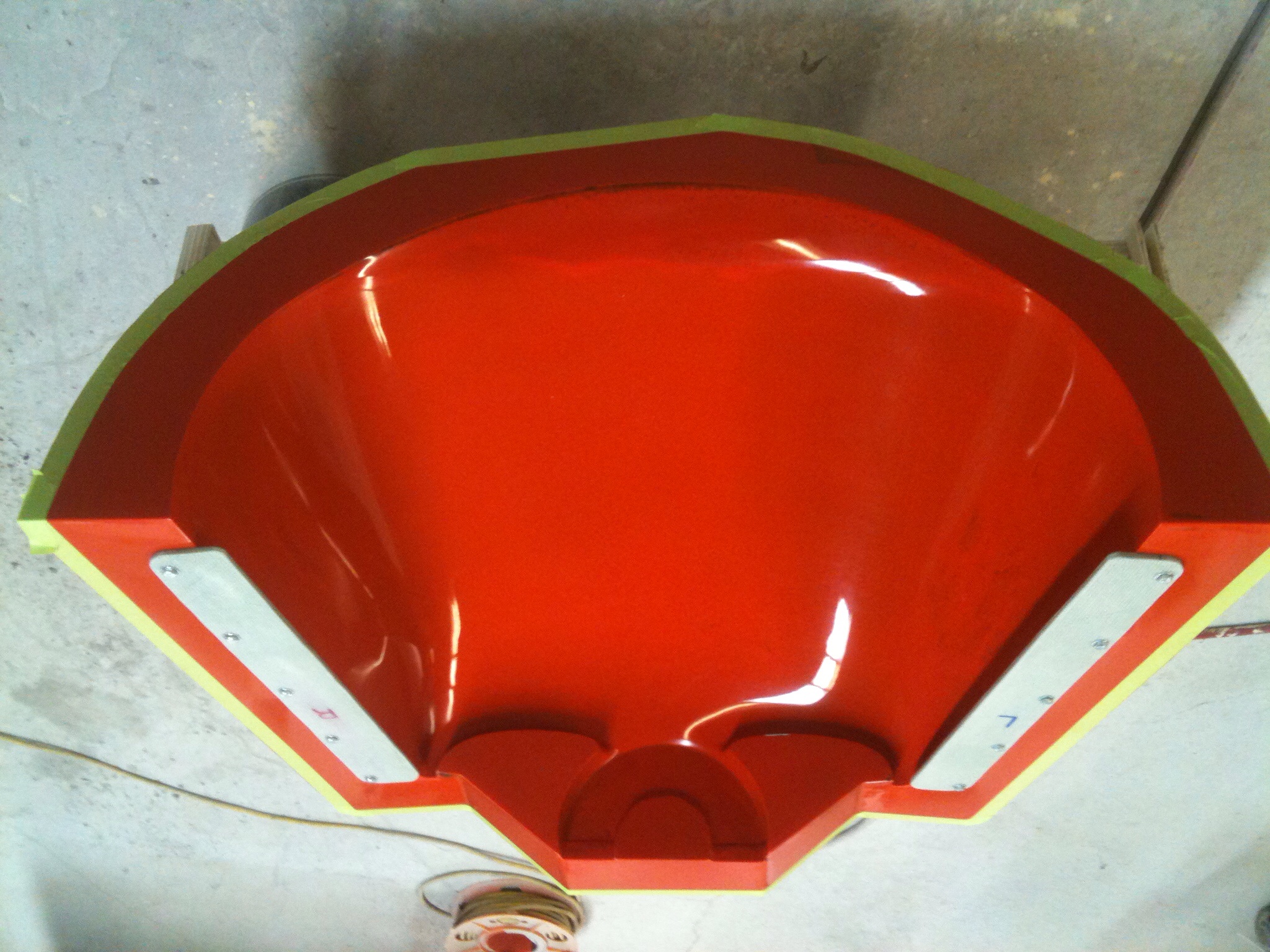

Hi all,
I've recently just finished making the lower cowl mold for the XP. This was based off the original cowl which was reworked because of damage and turned into a suitable plug. The original part was not going to be airworthy (from our standpoint) due to the amount of oil soak it had in it. If anyone is looking for a new lower cowl, let me know. Below are pics of the plug and the new mold.

I don't have pricing as of yet. These parts can be done in one of two ways, either prepreg or resin infused. The one I'm doing for this plane will be resin infused. I'm waiting on pricing for the foam from another company, which is the least cost of the expenses. Other options are glass versus carbon. Prepreg versions would more than likely use honeycomb core. Infused versions will use only the same thickness core as original, but of higher quality.
Note that the return flanges can be removed for those not wanting to do the triangular return flange of the cowl and opting for a standard joggle for using camlocks. The joggle itself would have to be a layup performed against the upper cowl.
