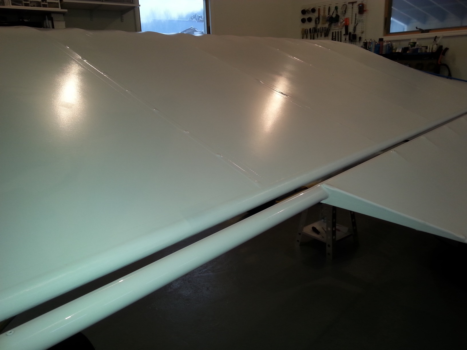

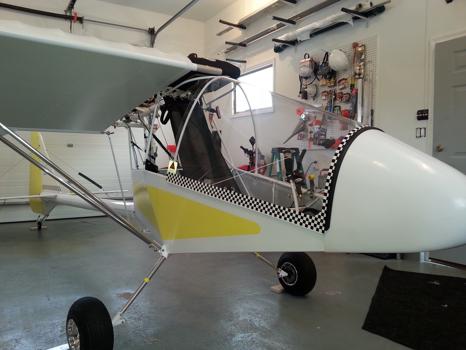

OK photos posted

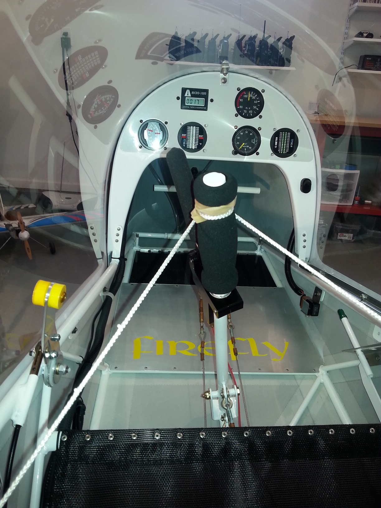

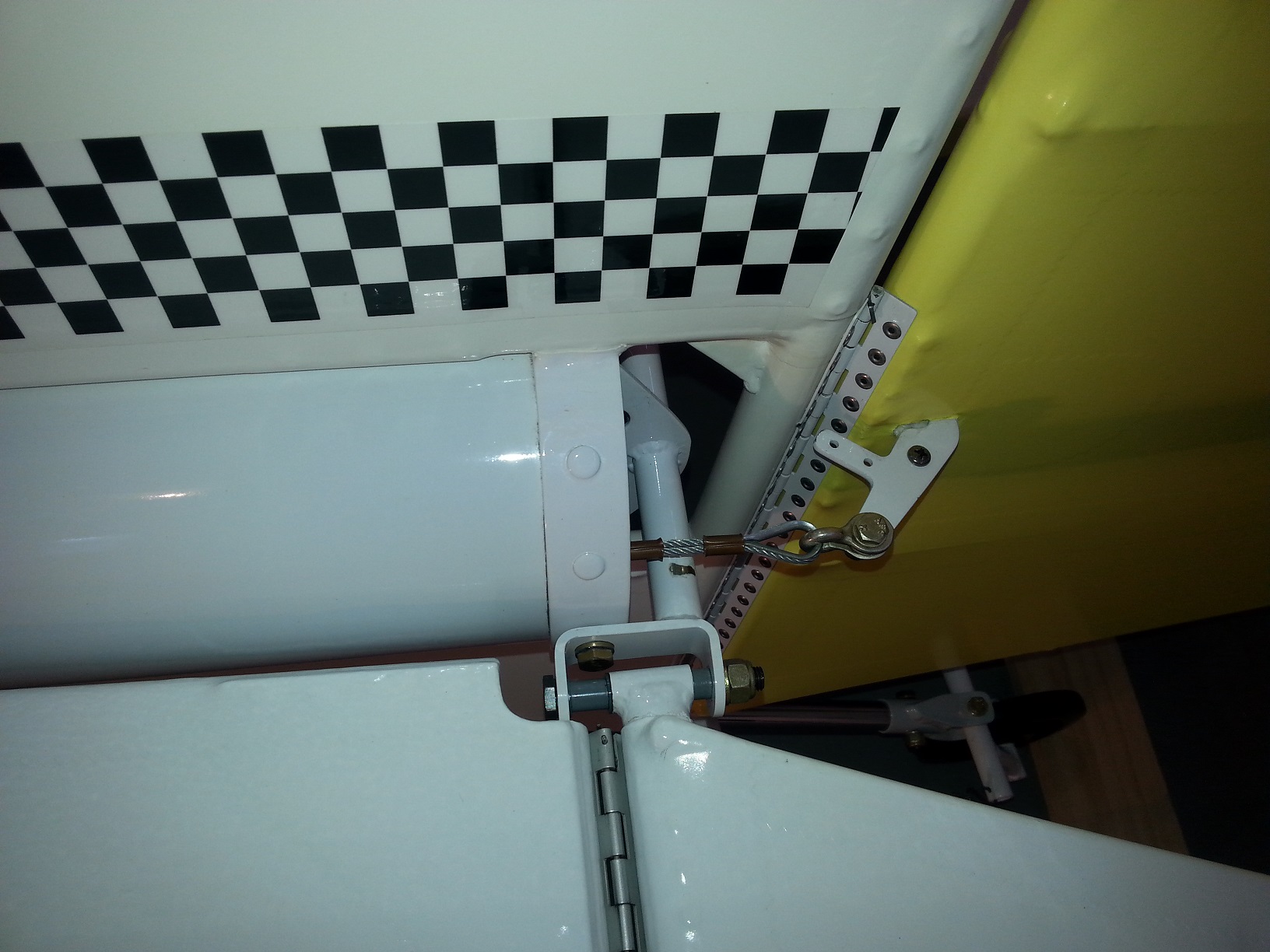

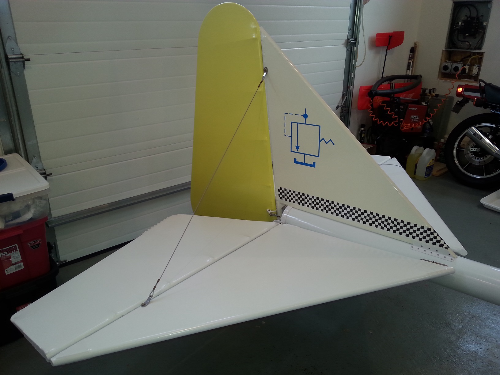

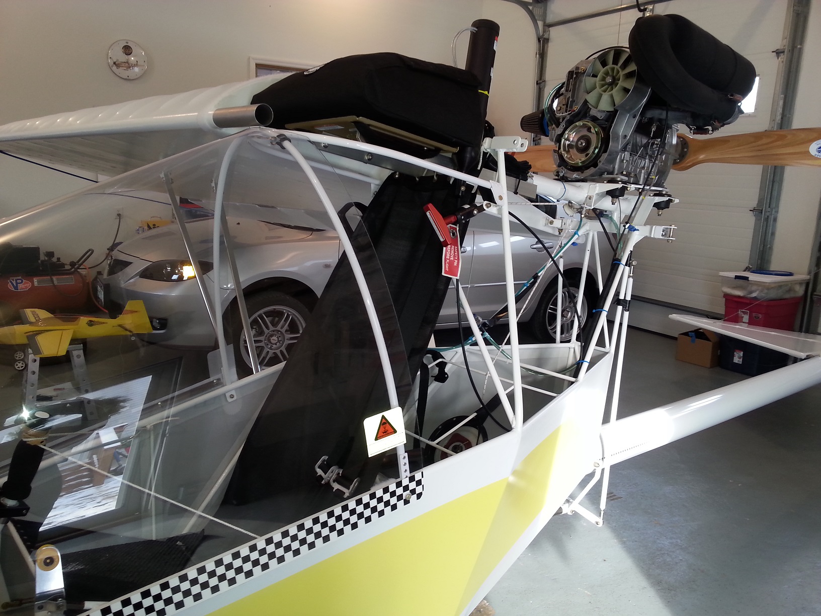

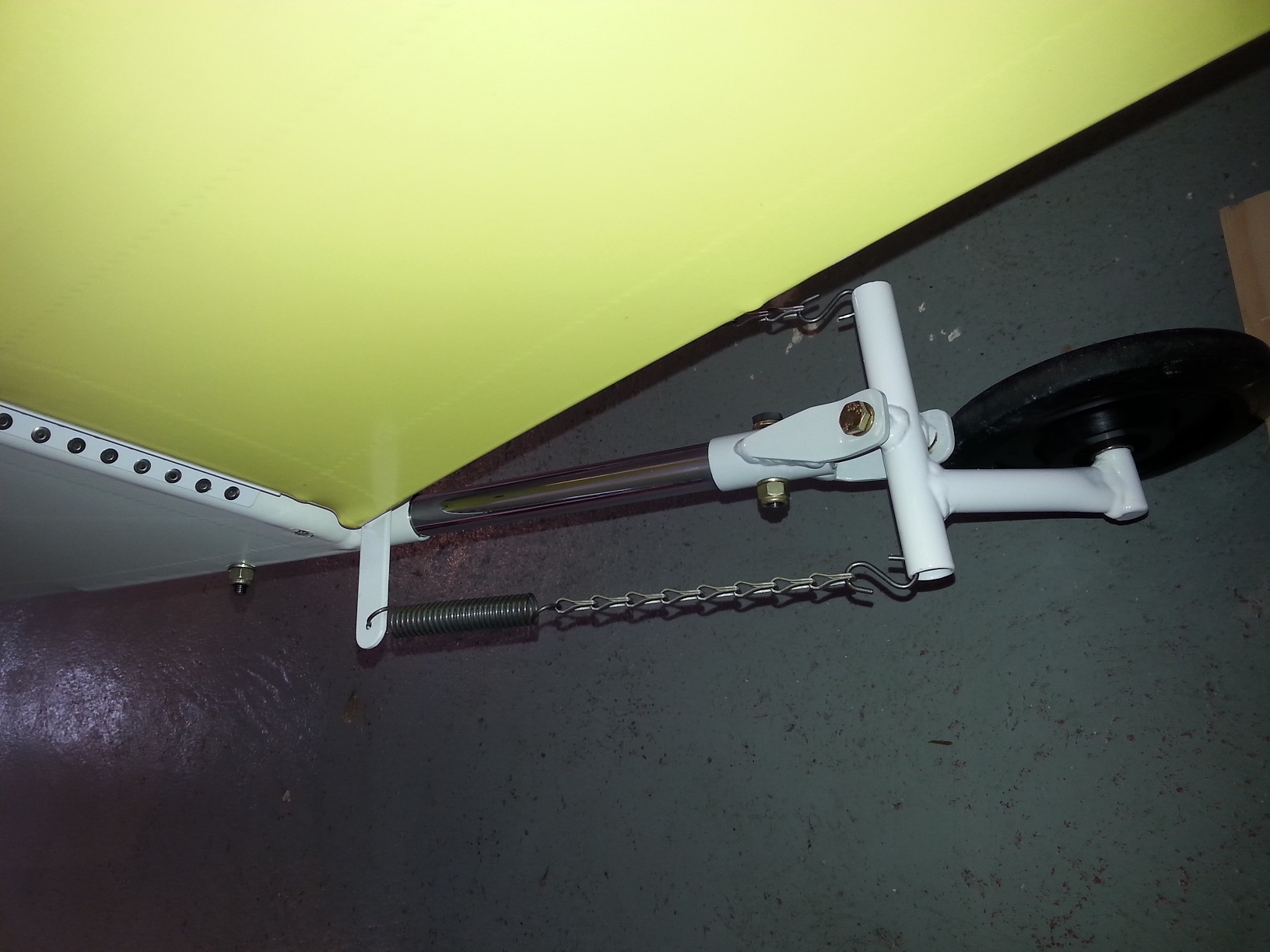

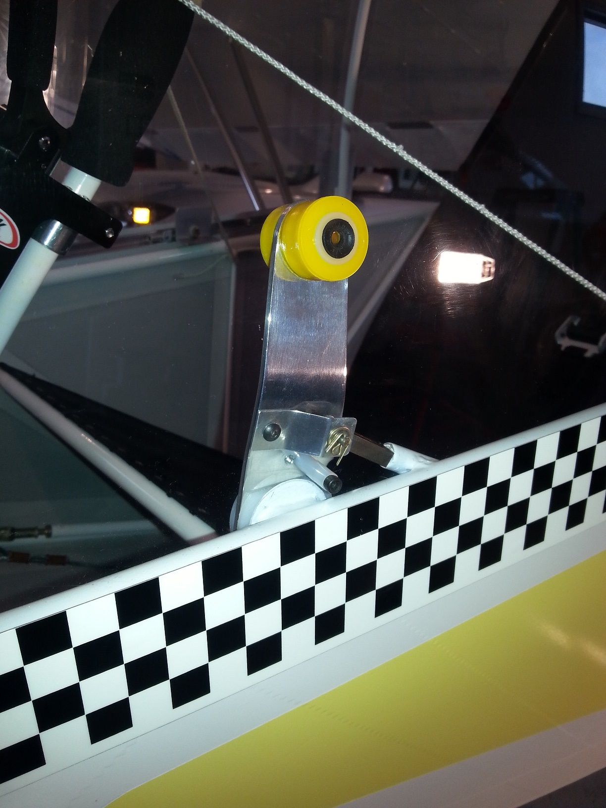

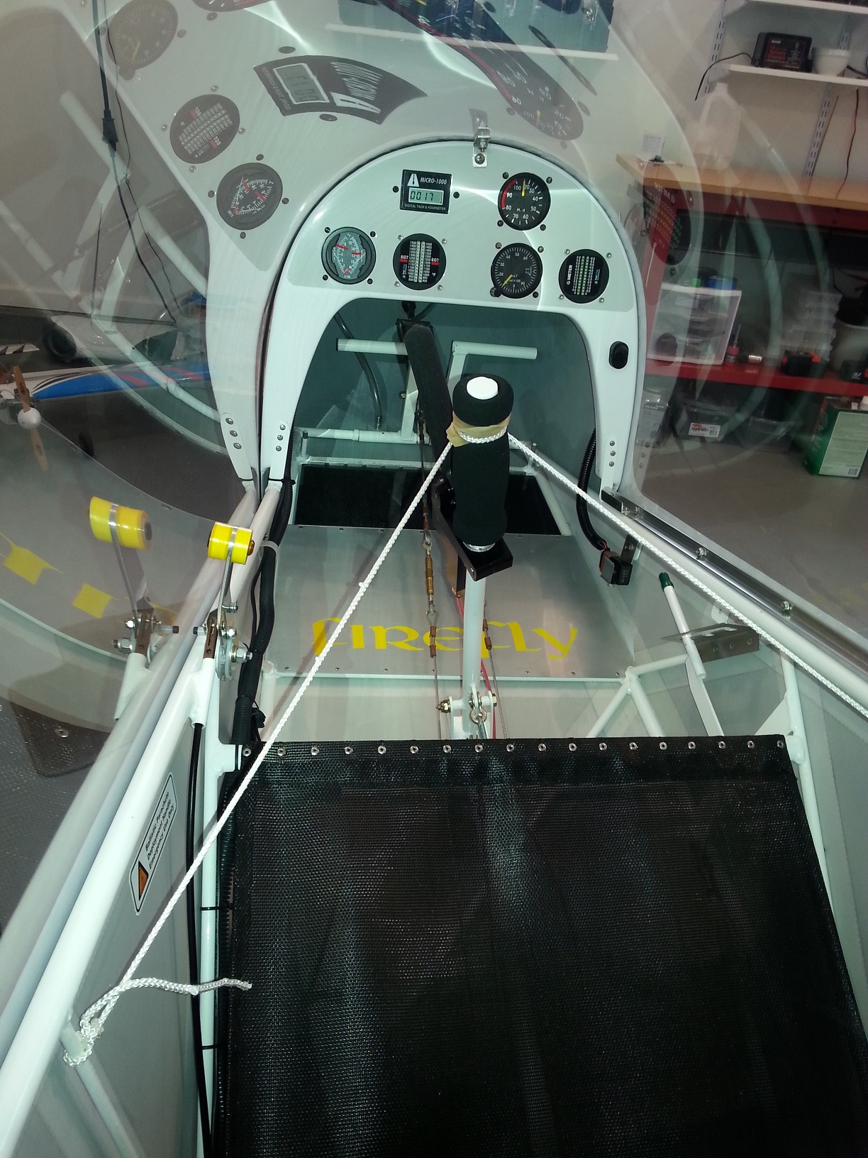

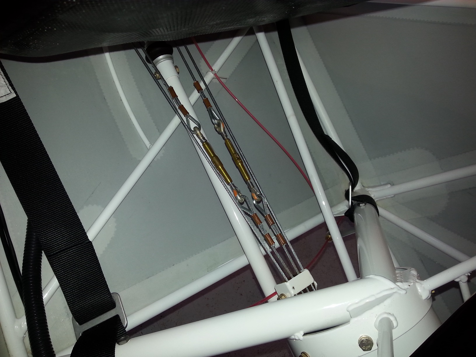

This is my Firefly , Part construction kit and part quick build, Brian built the wing structure almost to quick build specs. He could not do the rigging portion as I already had the rest of the airplane built. Please ignore the incorrect fasteners, I am making some changes and many of the bolts are temporary. The structure and rigging is as last flown, hope this helps Stuart or any other Firefly builders.

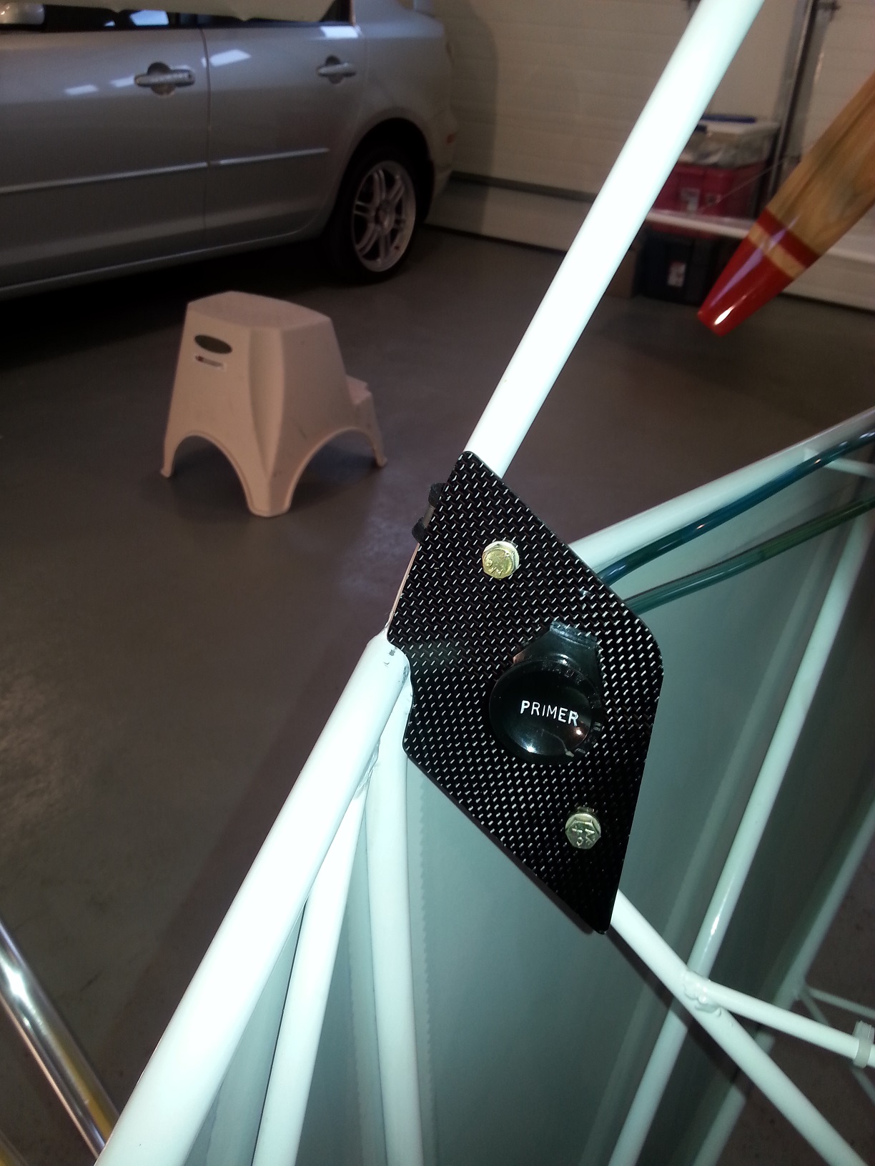

Mods. I did not like the supplied throttle so I fabricated the one pictured.

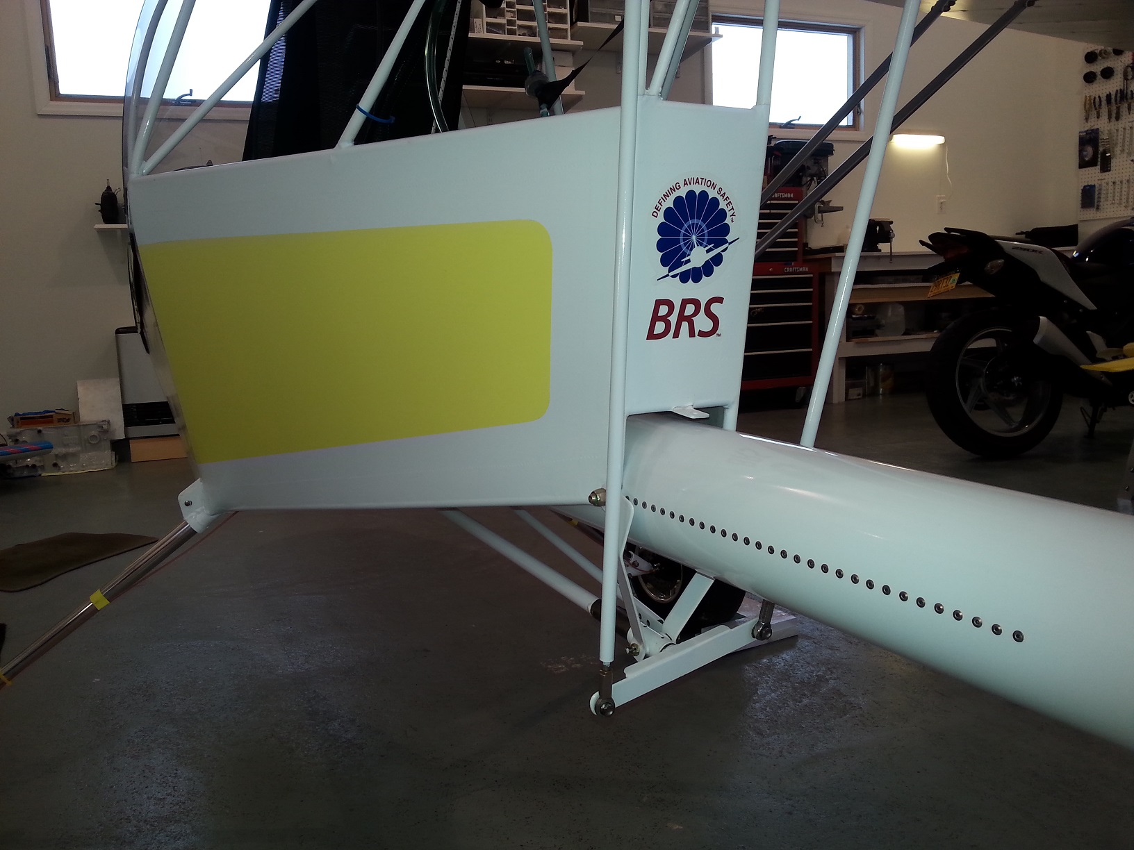

Notice the small screws on the interior nose cone supports and the exterior bottom - no need to drill rivets for removal.

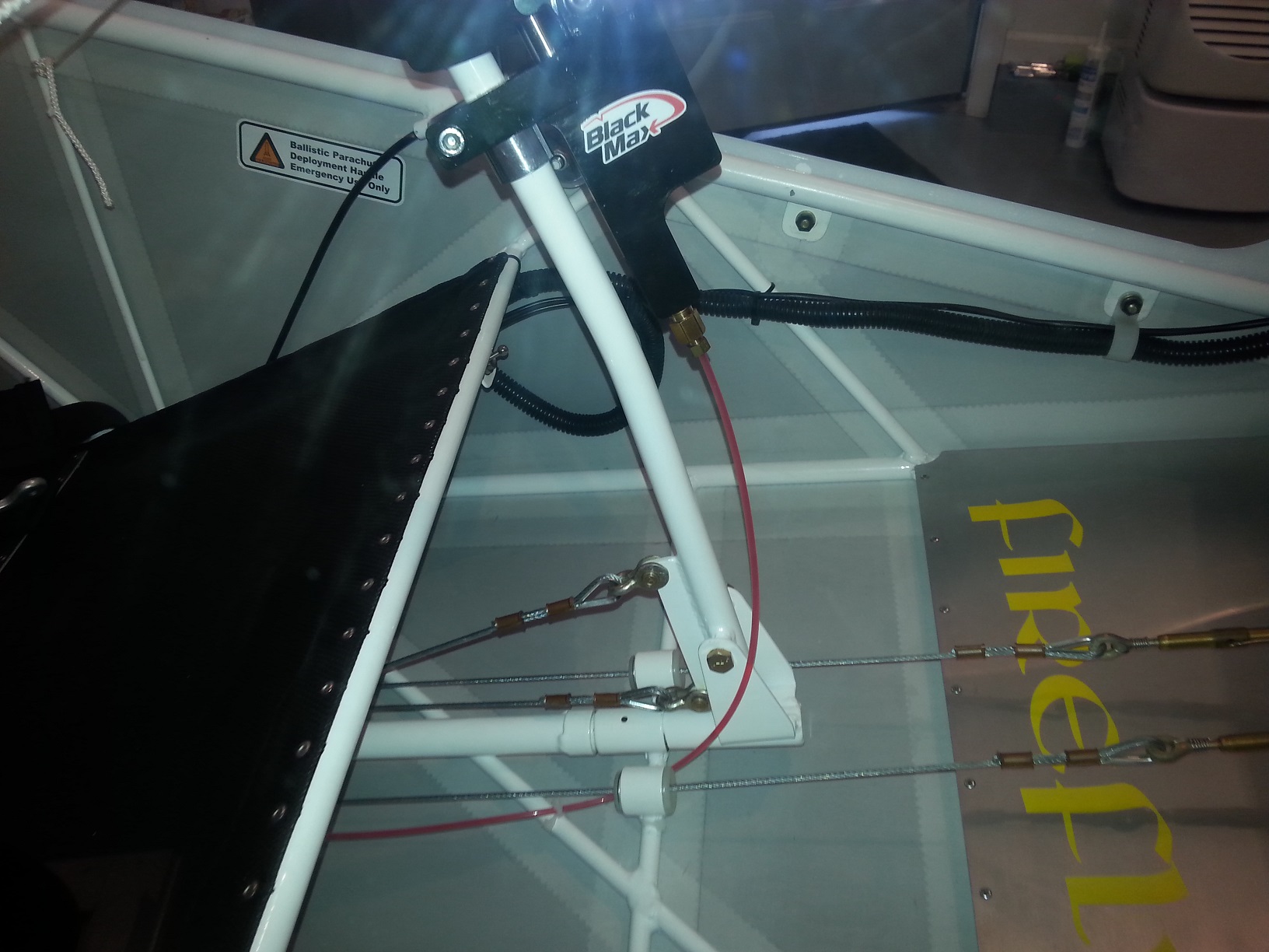

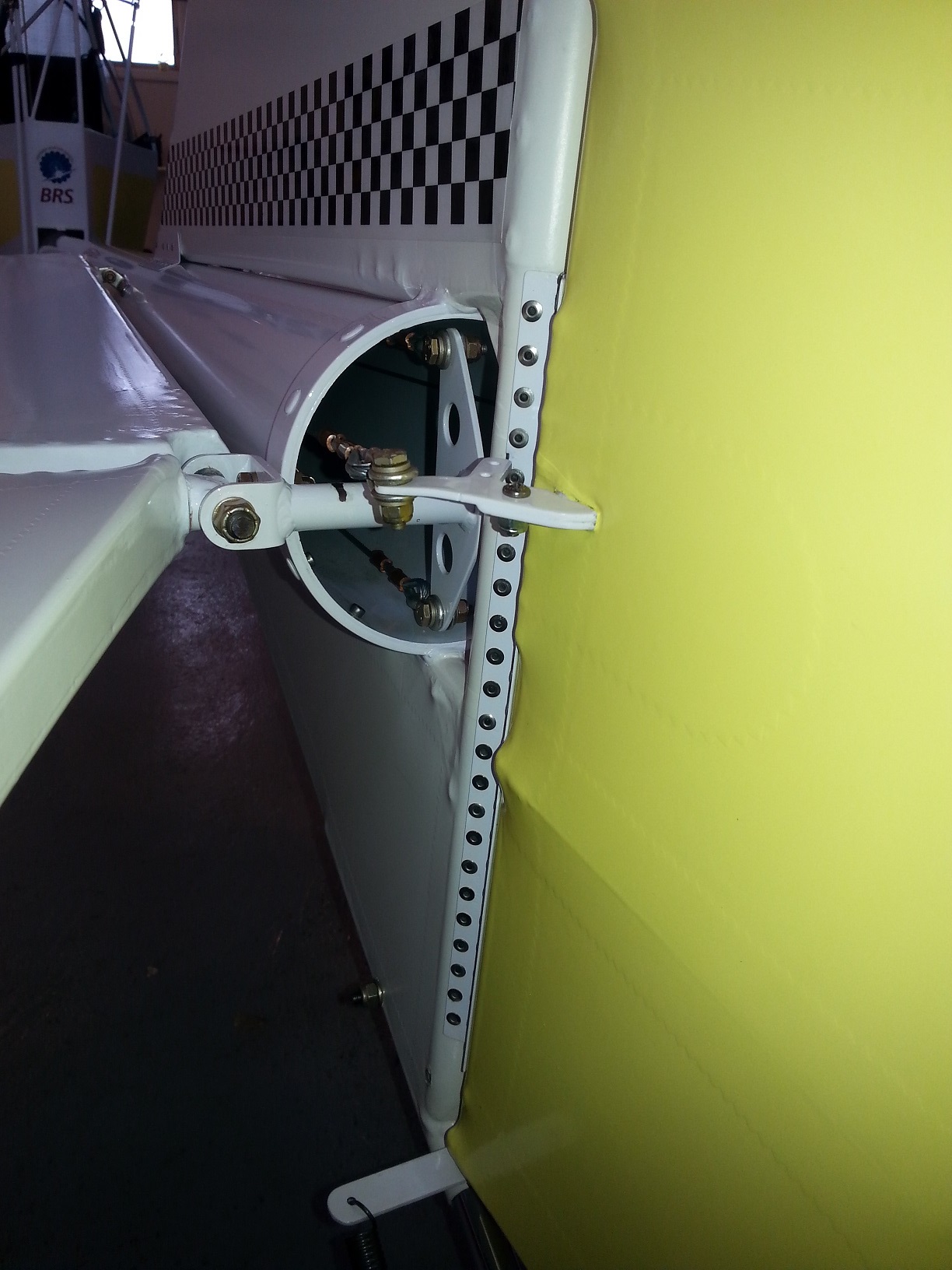

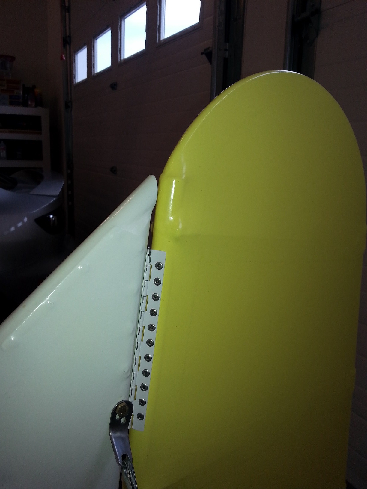

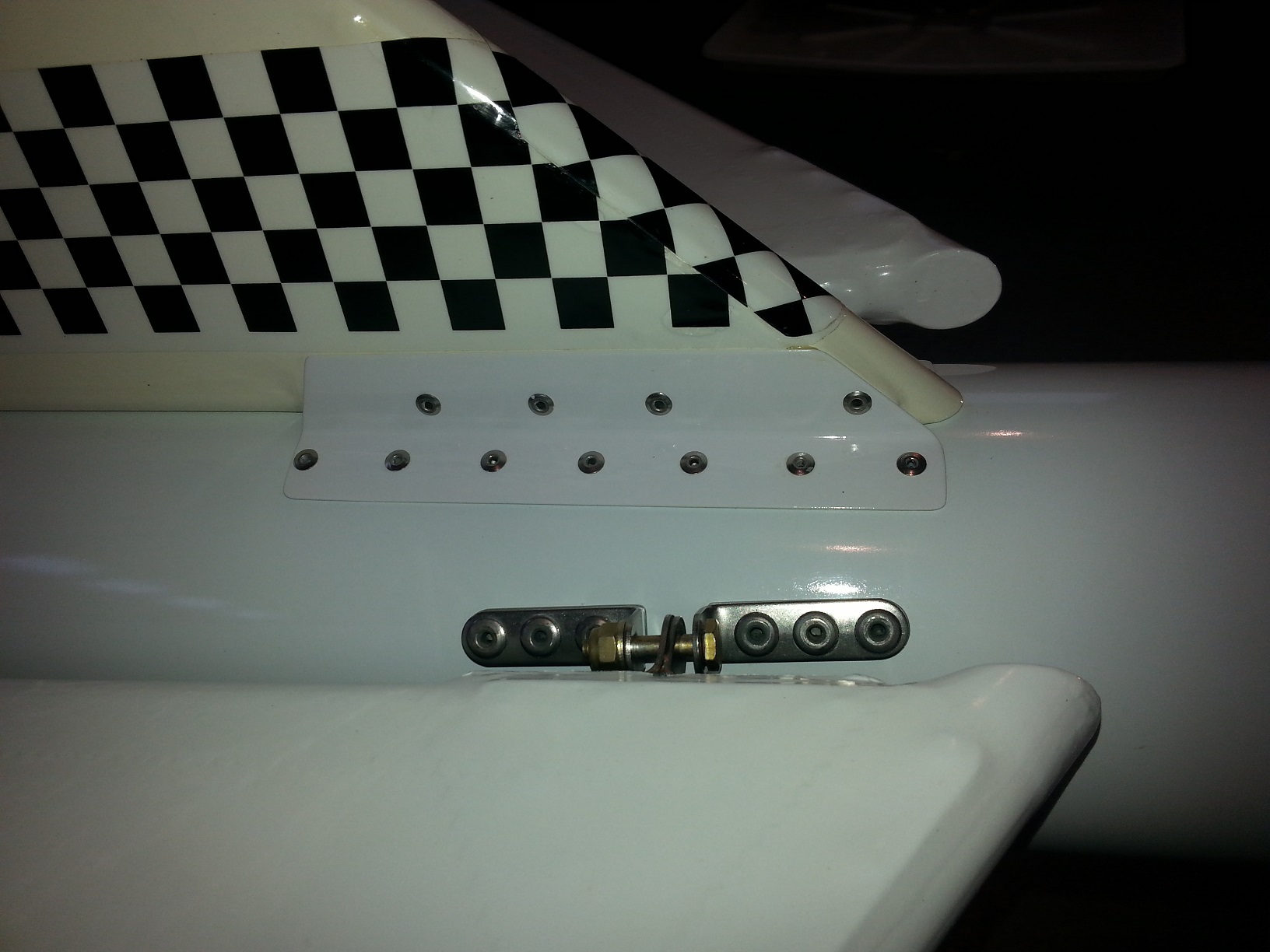

Modified rudder horn, for clearance.

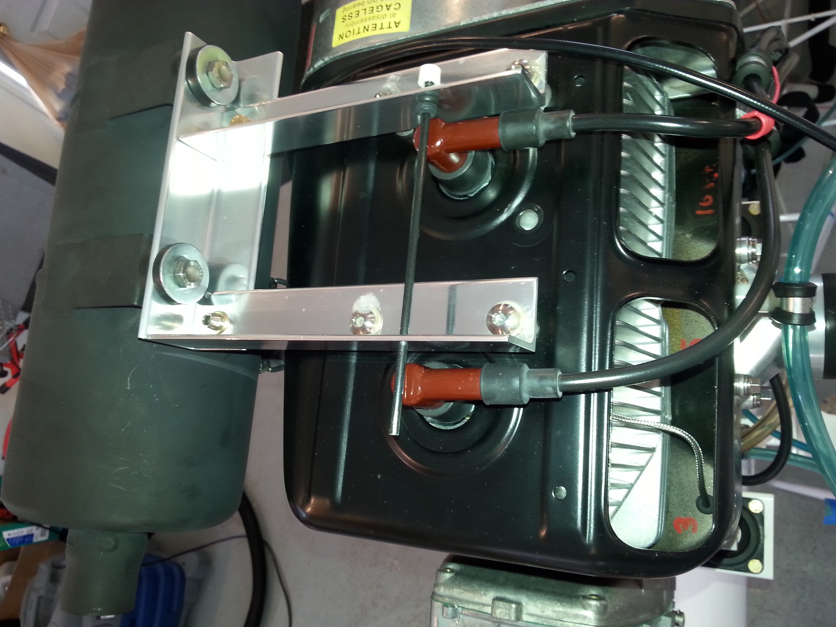

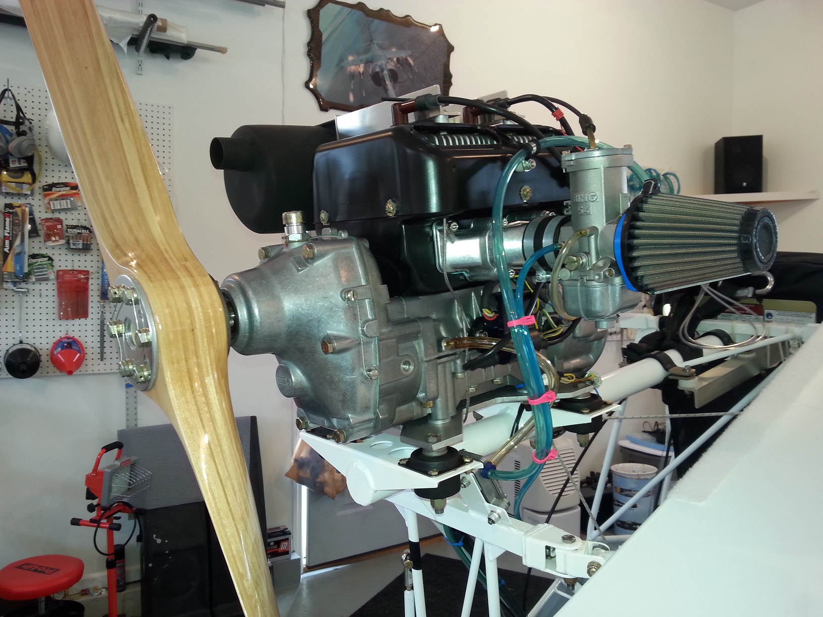

I have seen a number of spark plug cap retention methods but they all required consumables. Composite rod has a sleeve glued on recoil end and tight fitting o rings to secure rod - slide o rings down rod for removal.

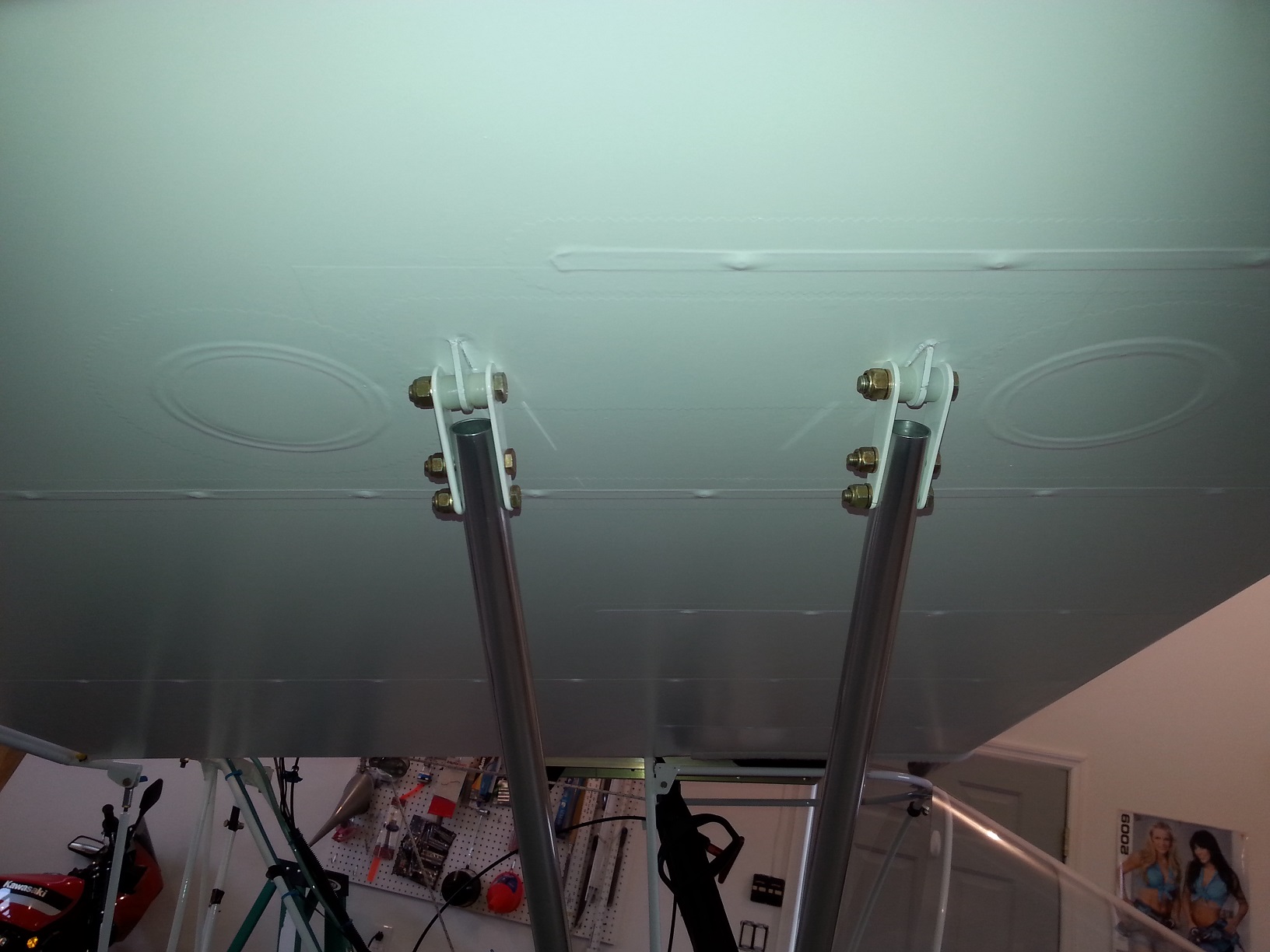

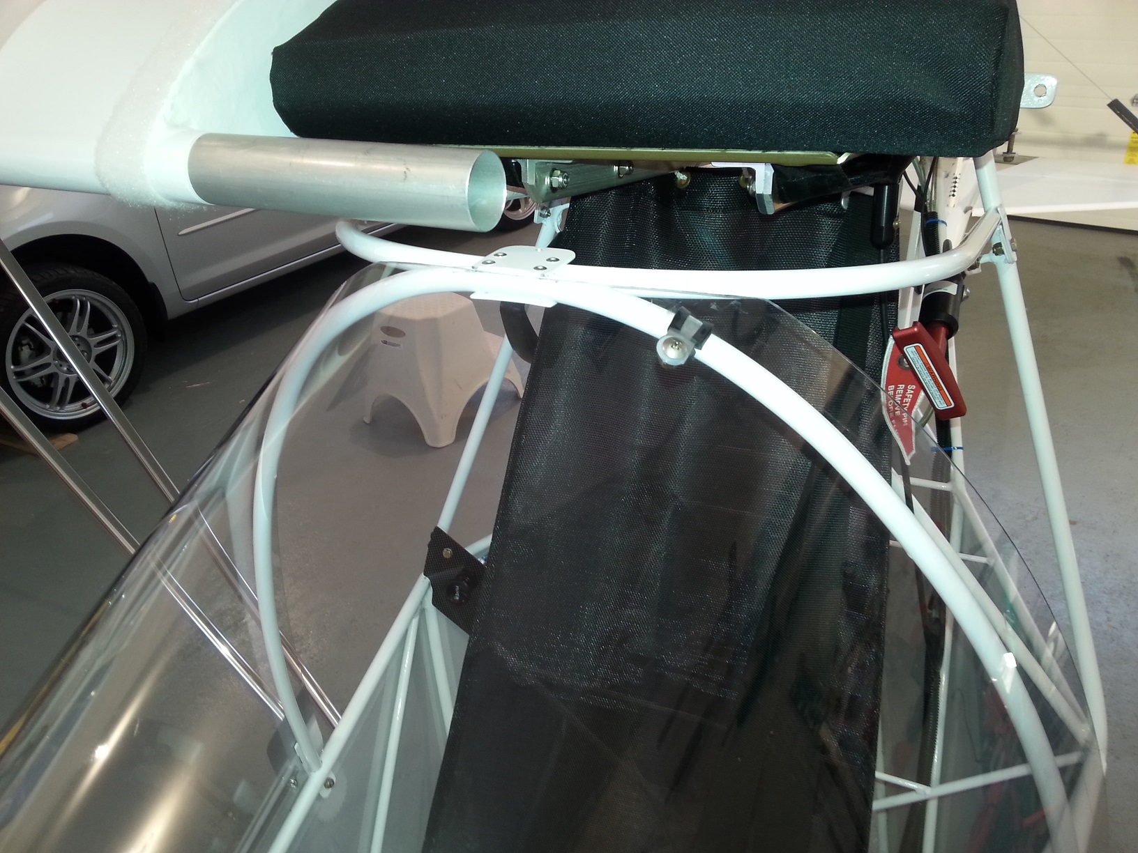

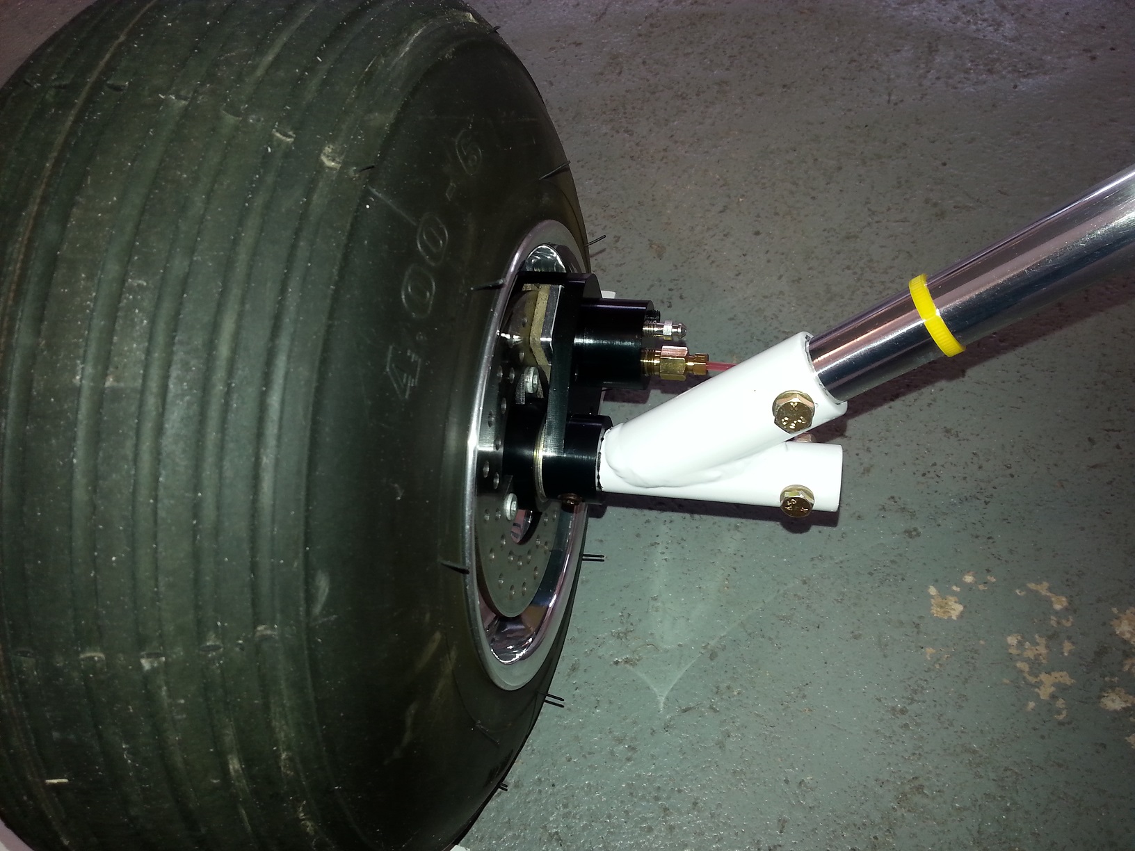

Nylon spacers at wing strut attach points to help prevent wear from sliding and vibration - inspection rings for future opening and covers.

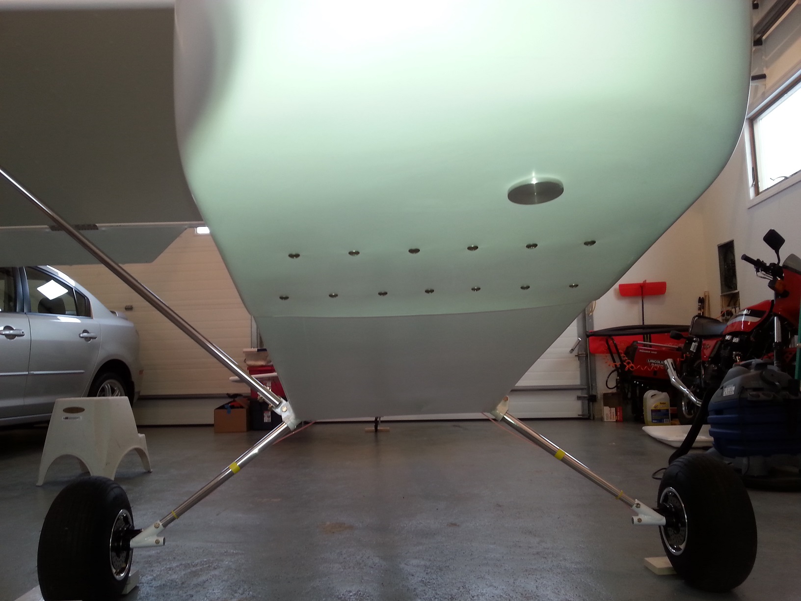

Many bolts ( as seen on intake manifold ) and axles are Titanium, Al. lock nuts on shear only fasteners.

I looked at all the photos- that is a very good looking plane. Any idea when she will fly?

OK photos posted

Perfection. I love it.
Your plane and garage show an organized, detail oriented mind. So what happened here? "Kolbd deatil photos" Someone else must have started the thread for you. Very Happy
The only thing I would change is the plastic fuel line clamps.

Beautiful airplane, excellent workmanship. Something you might think of doing is upgrading when it comes time to replace the urethane tubing in a couple years.
If it were mine, I would get soft aluminum fuel line tubing from AC Spruce and run in place of the urethane, with rubber automotive fuel line at the connections where you have to transition from the aluminum to soft tubing. Had a urethane tubing failure last summer, oil line from the oil injection tank to the injector pump failed while the airplane was sitting in the hangar. Walked into the hangar one day - oil everywhere. What a mess! Hate to think if it had happened in flight.
Doing what I call a 5-year annual this winter, serious stuff and upgrades, when I get done there will no urethane tubing on my airplane.

Haven't used plastic fuel line for years, many years. Never understood why
it was used on airplanes in the first place. Got a perfect track record
with Gates black neoprene fuel line. If you are concerned if the fuel line
will collapse, buy Gates Fuel Injection Fuel Line. Yep, they make it in
1/4" ID.
I use Gates Fuel Line to feed a 5.5 KW Onan Generator from a 25 gal alum aux
tank, both mounted permanently in the pickup bed of my truck. The fuel line
is exposed to the sun and weather every day, all day. I don't know how many
years I use it before replacement, but usually when it starts looking like
it may fail, 3, 4, 5 years. Like I said, don't know for sure.
If it were mine, I would get soft aluminum tubing from AC Spruce and run in
place of the urethane, with automotive fuel line at the connections where

The Gates hose John refers to complies with a standard called SAE 30R9.   So, any hose that complies with that should work quite well.  For example, go to  napaonline.com  and in the search box, type in "30R9" and you'll get some of that hose that you can order from them.  (Their WH H0770410 part number is the 1/4" ID hose.)

I agree the plastic clamps are near useless, I will be replacing them with steel.
Great idea with the aluminum fuel line, never even crossed my mind. I will plan to make the change if I ever get caught up with my other projects. For now I prefer the urethane over the neoprene for this application. I have a coil of urethane and replace the line each spring.

for what it is worth..... after 4 to 6 months of using the urethane fuel
hose with the plastic clamps,, supplied by kolb,,,,, I started noticing
some fuel staining on the engine cooling fins,,,, I turned on the electric
fuel pump and walked around to see,,,, there were leaks on 2 of the joints.
it was bypassing the fitting and hose where the plastic clamp overlapped
itself... long story short,,, if I were to use urethane fuel lines,,, I
would not just put a metal clamp on it and expect it to hold. the inside of
the clamp would not be as smooth as the plastic clamp. which let fuel pass
in the very tiny spot where there was less pressure on the tube.
so imho in my humble opinion,,, to use urethane hoses, in addition to the
metal clamp, I would cut a 1/2 inch of tube and place it on the outside of
the hose. don’t use any splits in the 1/2 inch peace, that would give you
uneven pressure on the inner hose,,, leave it intact. it will be harder to
get the hose over the fitting. but will allow for more even pressure
between the clamp, hose, and fitting.
OR someone in the past recommended using 4 or 5 wraps with tie wire, the
center few wraps would create very even pressure between the hose and
fitting.
boyd young

Helpful, YES! WOW, what nice work you do.
Thanks so much for posting these. I have downloaded them all and saved them
for reference material.
I too, did not like the idea of permanently attaching the nose, nor resting
my feet on the fiberglass. My solution was to install nut plates on an
aluminum angle and then rivet that to the inside (vertical) wall of the two
square cross tubes. This allows me to use #10 stainless large head screws
and fender washers to attach the nose.
The fiberglass did not fit very well and when I tightened up the screws it
caused the bottom edge to bow upward. I solved this by making a floor plate
out of 1/8 plywood and using it as a spacer between the fiberglass and the
fuselage.
This solved two problems at once. It made the nose fit much better and it

I would very much like to see some detail of how you attached the fabric to
the upper longerons. I can see the tapes you applied in the photos of the
inside of the cockpit.
You did such a nice job of gluing and wrapping the fabric around surfaces, I
cannot quite see the details. Which of course is the point isn't it?
What finishing system did you use, and how many coats?
Thanks for everything,
Stuart
fuselage.
took the stress of my feet off of the fiberglass.
Downside: It added a little weight I will endeavor to make this up
elsewhere.
Stuart

Thanks to all
Yes I had help, but after all her time and effort to post the photos I an not about to complain.
If you have a huge supply of urethane tubing for free or almost, then it is a reasonable option, but buying and using a dozen or two small hose clamps is a waste of weight and money. Use safety wire instead. Never had any problems with it if you are using good quality urethane. Instructions & pictures at the bottom of the page here:

It appears that you did a superb job here. I don’t want to rain on anyone’s parade, but it appears that when slack, the rudder cables are dragging on the elevator horn causing a bare spot. 4130 tubing is more susceptible to corrosion than mild steel. Things like this need to be touched up immediately before rust sets in. If I were you, I would touch it up soon, wrap a couple of layers up electrical tape over the area and add this spot to your inspection checklist for regular monitoring. A short length of poly spiral electrical wrap might offer more permanent protection.
Oh, and urethane fuel tubing works fine if you replace it at the beginning of each flying season; otherwise even the ‘good stuff’ falls apart after 2 - 3 years. At least that was my experience 14 years ago. Tubing chemistry may have improved since then, but I wouldn’t bet MY ass on it.

PostPosted: Thu Jan 23, 2014 4:29 am    Post subject: Re: Kolbd deatil photos Reply with quote
Contact of the rudder cables and elevator bell crank is due more to the fact that the bell crank moves up and down as it rotates. Look at the photo and you will see the bell crank pivot bolts are forward of horn shaft rotation. Due to the more or less hand built nature ( at Kolb ) of these airplanes and the resulting variation in parts I can not say weather all Fireflies have this problem but it appears many do. I was able to modify the rudder horn and make some other adjustments to minimize contact ant they only touch at extreme up elevator. I do not believe there is any contact during normal flight, the marks are from taxing with full up elevator and steering. Tape will not work as it is not the cable but the sleeves that scratch off the paint. Any sleeve added will only reduce clearance. Though I did apply corrosion prevention during construction I really do not have much of a corrosion issue, my garage is heated and dehumidified and my hanger is completely enclosed with a concrete floor. I have considered adding internal brackets using the existing forward fin and stab mounting holes to support an internal bracket with pulleys. The pulleys would be canted slightly off vertical and near the top of the boom tube to raise the rudder cables.
A future experiment. I worked for years as a professional motorcycle, snowmobile mechanic, which was very fortunate as I was able to work extensively with a number of 2 stroke brands including Rotax. I also worked with various types of fuel line and understand the limitations of urethane, so I treat it as a short term consumable.
