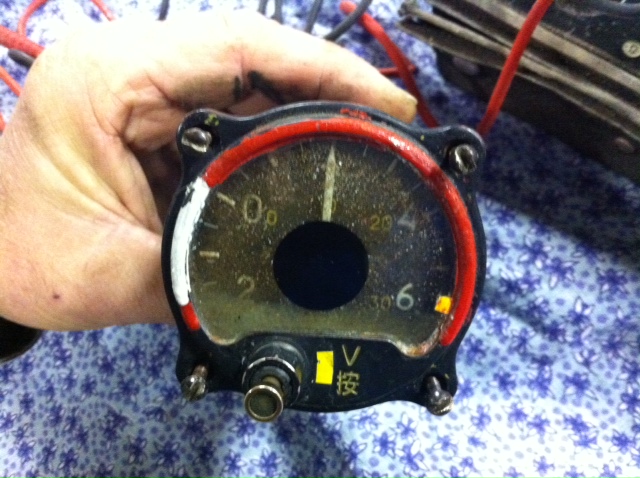

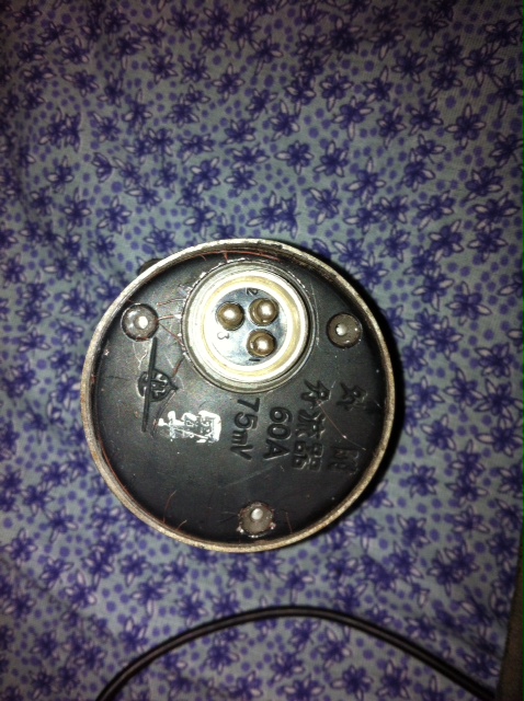

Hello,
our V/A meter is out of order, (inside component broken) . What do you suggest ? Replace it by an original one's or an other model. In this second case, which one is suggested and how to adapt the standard connection?
Best regards
Bruno

Same thing happened to me. Cheapest, easiest and best option was go with original equipment. Contact Doug Sapp for new original.

I will second Jon’s advice. By far the best option.

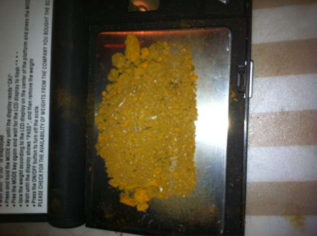

Thank's, i 've already contacted Doug, he told me to make a check by a good electric workman. we removed about 2,5 grams of yellow dust inside , like an exploded electric capacitor , it's dead . Doug will not have V/A meter available before a month. i tried to find an alternate solution.

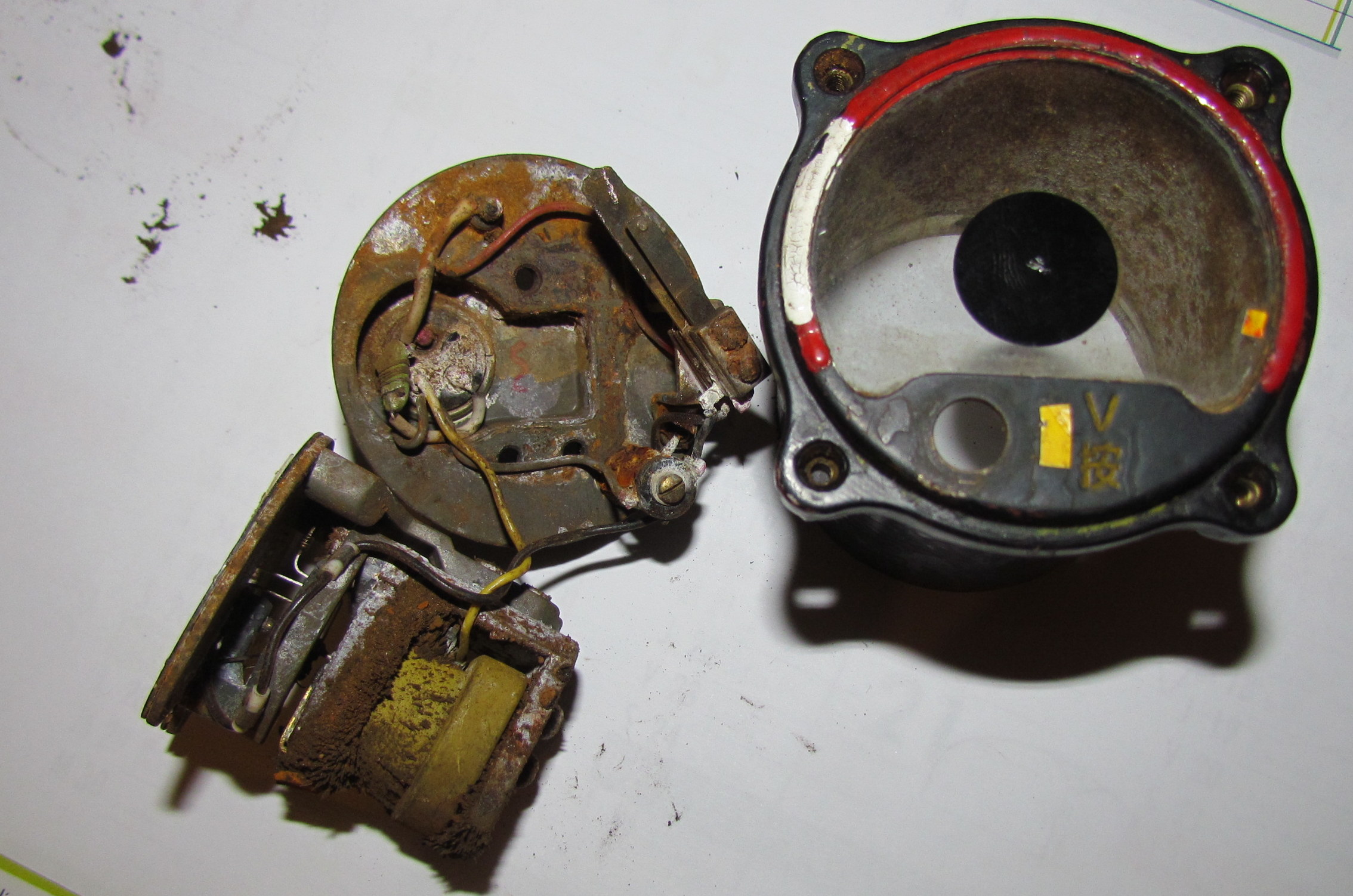

Here is the inside body of the V/A meter:
about 3 grams of yellow dust were removed, all the components are destroyed
its looks like the instrument was a long time inside water ,
