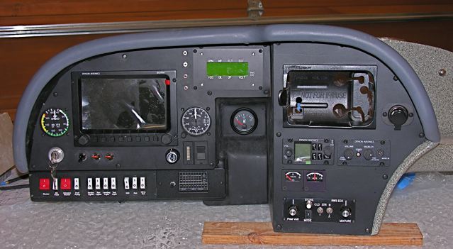

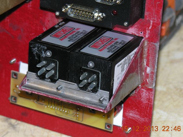

Bud...not at all...your posts are always informative, and as long as questions raised are not considered stupid questions, it's all good.
Recall that my powerplant is a Subaru derivative, so don't trouble yourself w/ Rotax-related issues on my behalf.
I thought it wise to supplement the voltage/amperage warning lights in the EXP 2 Bus Indicator Module with separate meters from Mitchell...pixs below.
Cheers,
Fred

I just looked up your Mitchell Ammeter. I noted that they specify a shunt for it. The shunt is a resistor and will by Ohms law (E=I/R) output a voltage that is proportional to the amps passing thru it. At full current (45 Amps) it will deliver a known voltage (usually 50 millivolts). The meter in the panel is actually reading volts and the shunt is mounted in the engine bay. Since the meter is +/- amps, it is designed to go in the lead right at the battery. That way you will see negative amps if the alternator is off line or if there is a power requirement in excess of what the alternator can deliver. You will also see positive amps when the alternator is charging the battery typically after engine start. Mostly you will see zero amps showing there is no current flow into or out of the battery since it is fully charged and the alternator is producing the needed electricity for everything that is turned on. This is as Frans described in the other thread.
You can install another Mitchell shunt in the wire that is the output of the alternator. Using a switch you can switch the meter between the two shunts. The second shunt would give you the ability to view the output of the alternator. That way you can see just how many amps the alternator is producing to keep the battery charged and to power everything you have turned on.
It appears you have a Dynon EFIS. Most EFIS have engine monitoring capabilities. They usually use a Hall Effect ammeter which measures the magnetic field around a wire carrying current to determine how many amps are being conducted in the wire. This is just a different way to measure amps. If you didn't want to use the Mitchell ammeter, you can measure amps using the Dynon.
In our Europa, we have two Hall Effect sensors. One is on the battery lead to measure amps in and out of the battery. The other is on the output of the Rotax alternator. They are switched by a toggle switch. Usually I just monitor the amps into and out of the battery. But I will occasionally see just how many amps I'm asking the Rotax alternator to deliver to assure I'm not exceeding its capability.
Hope this helps.
