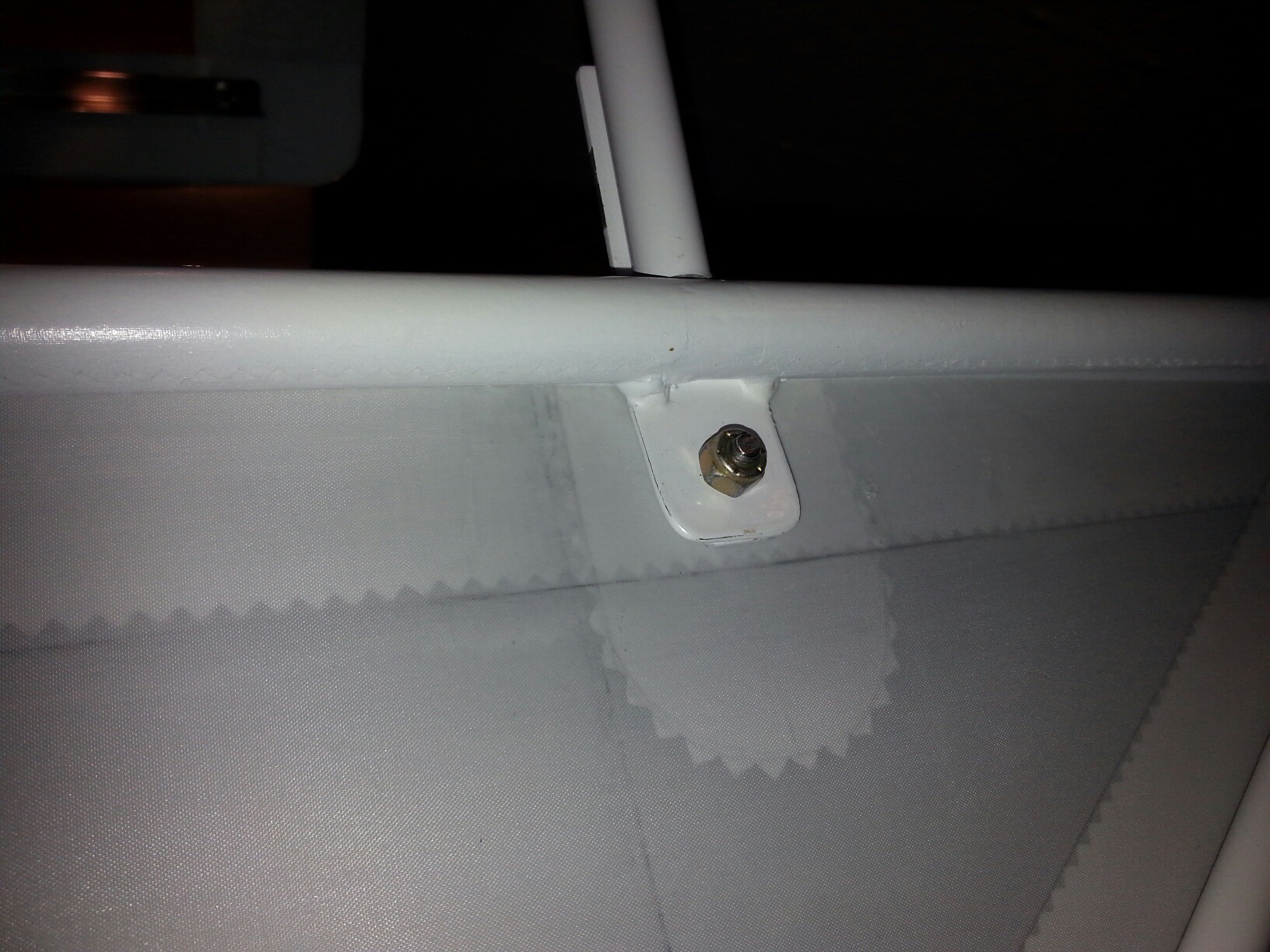

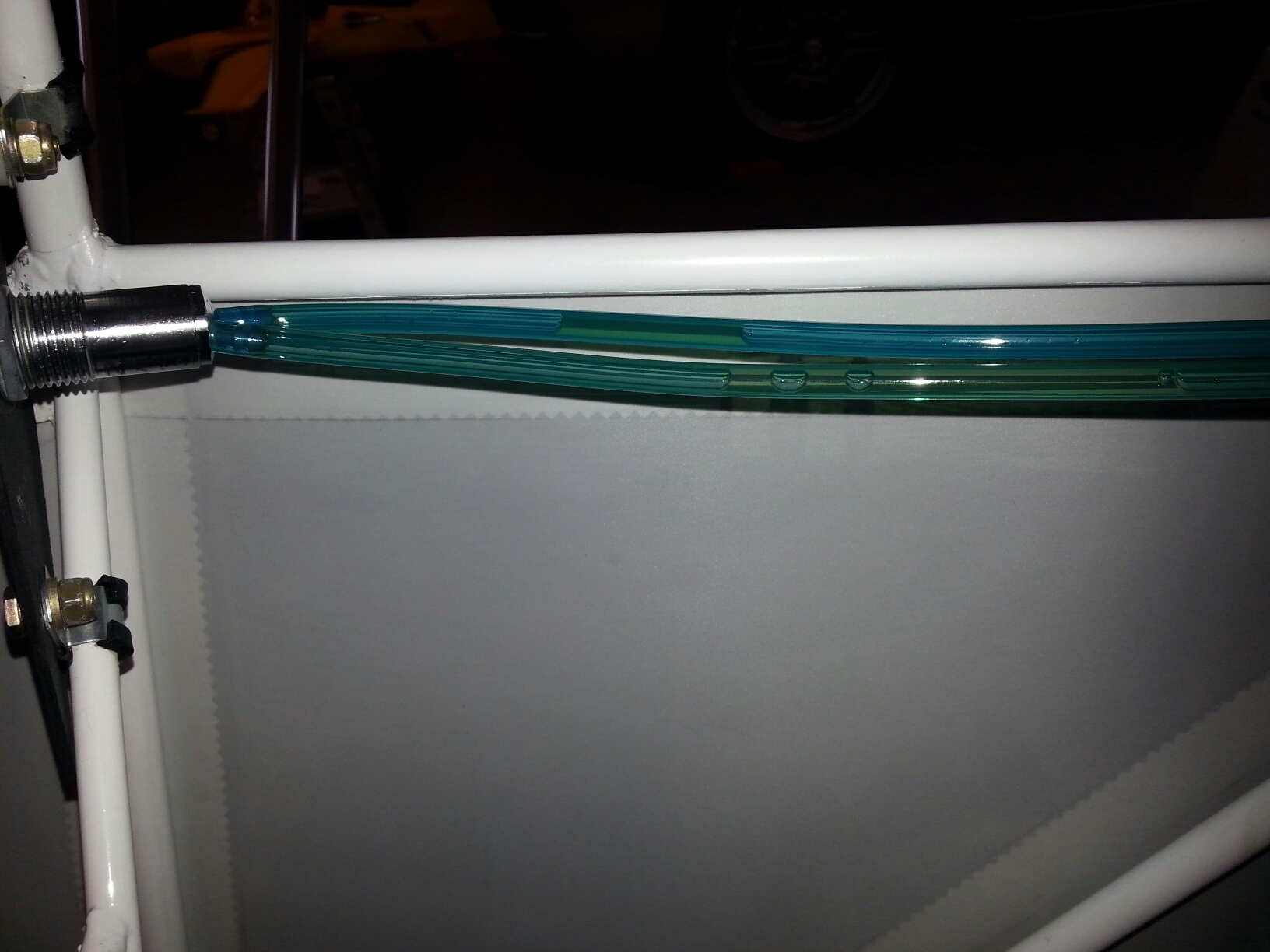

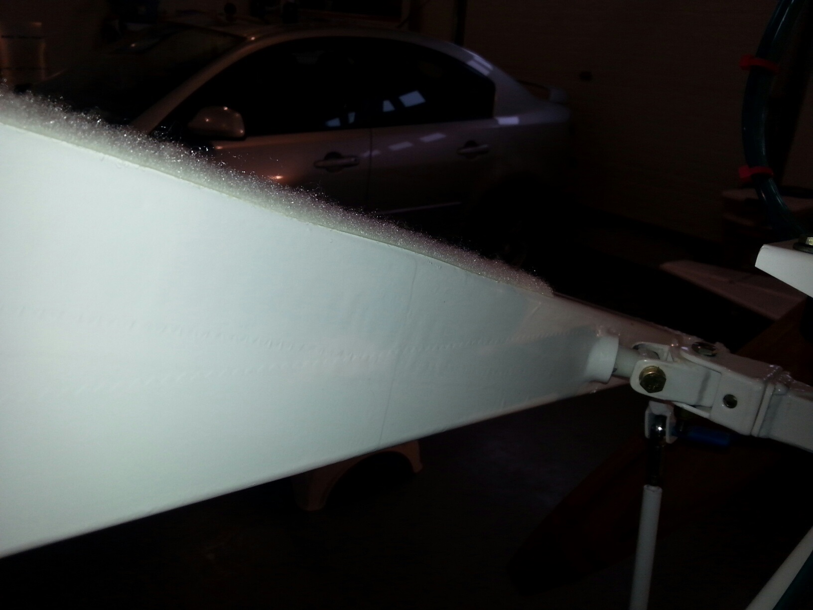

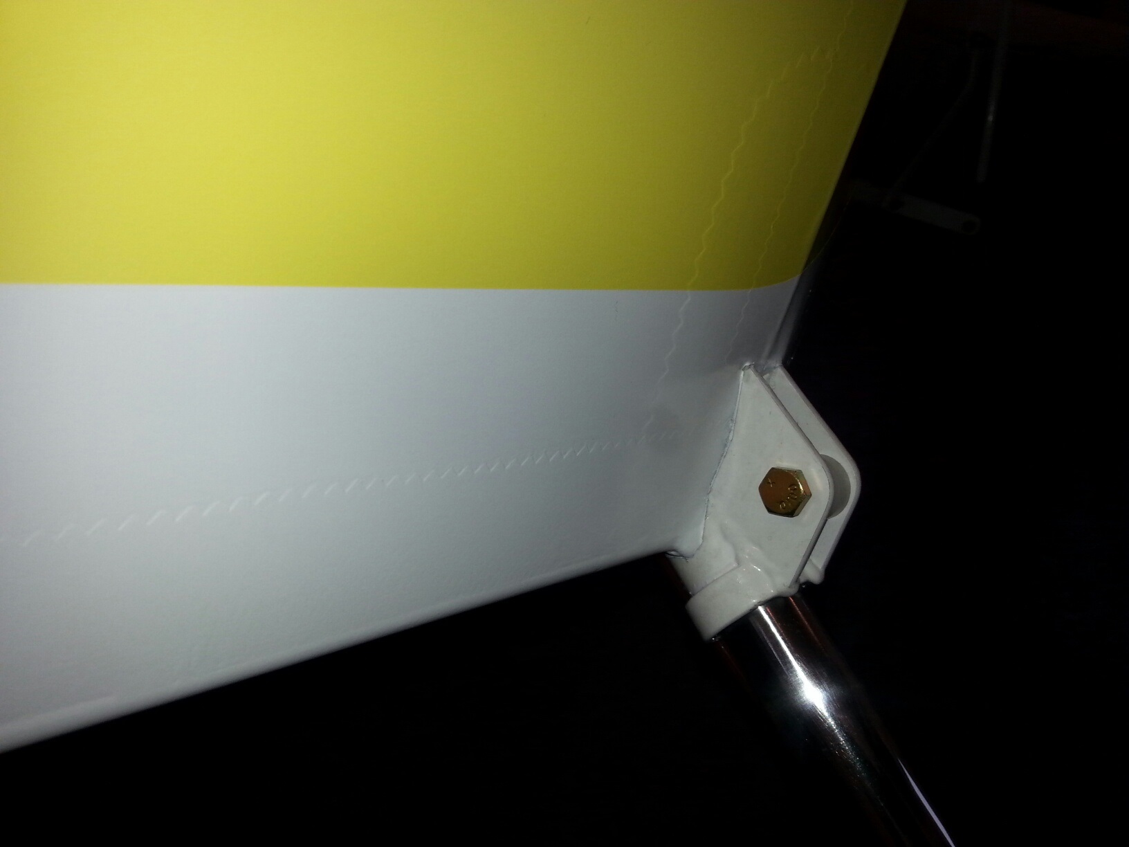

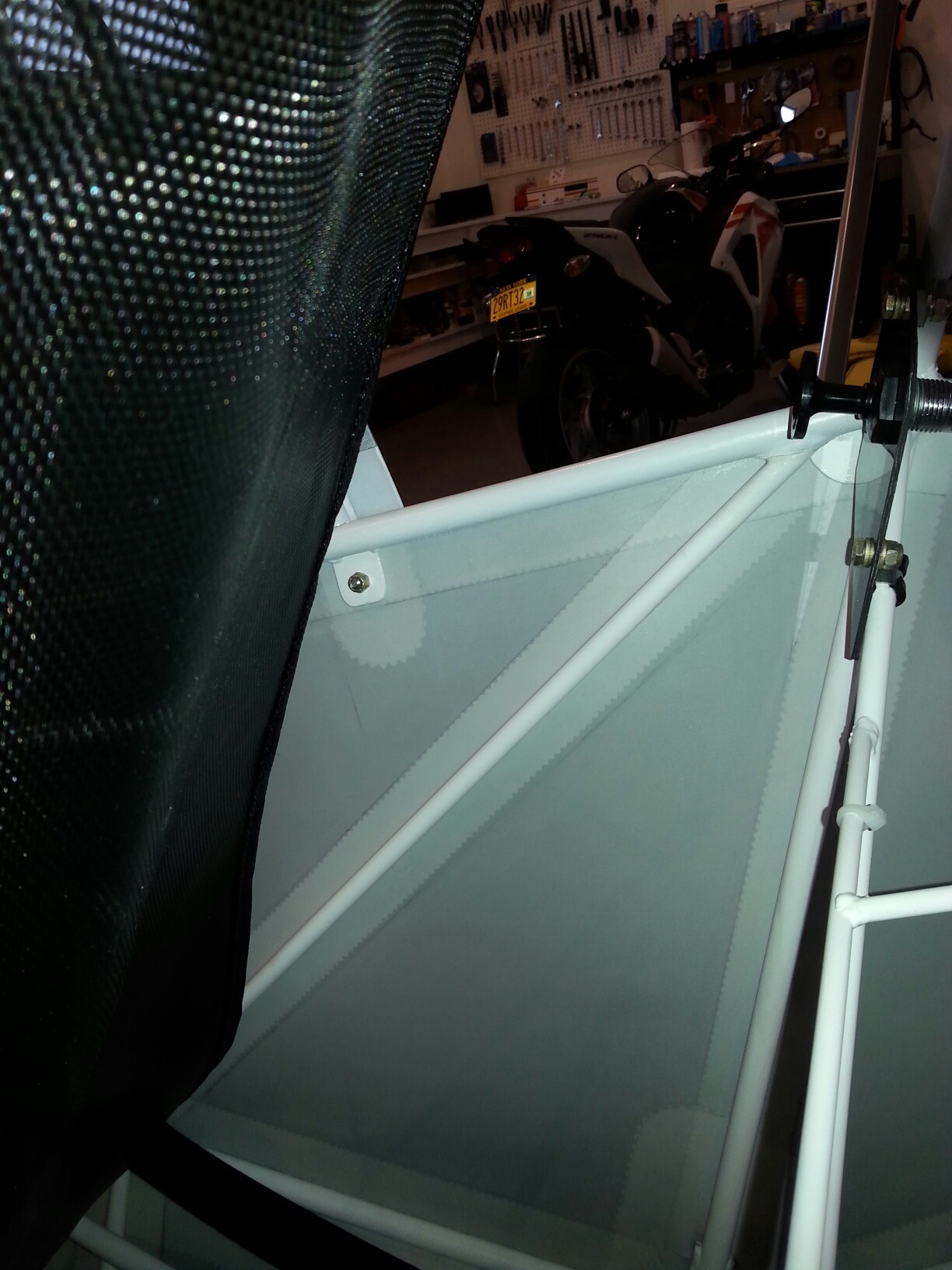

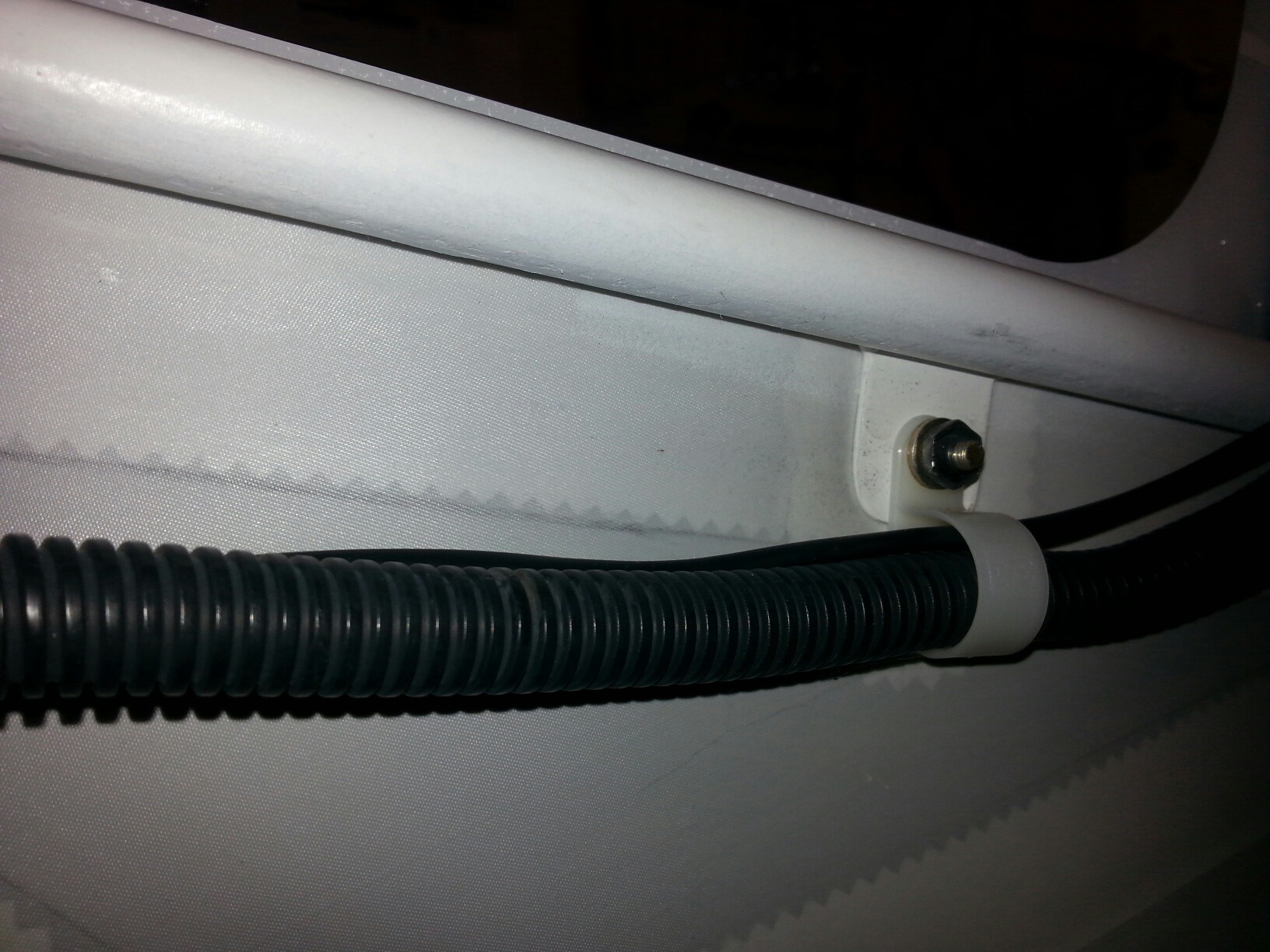

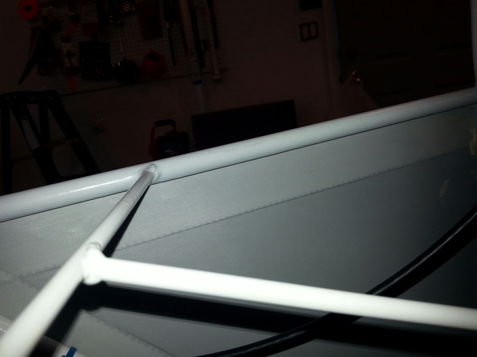

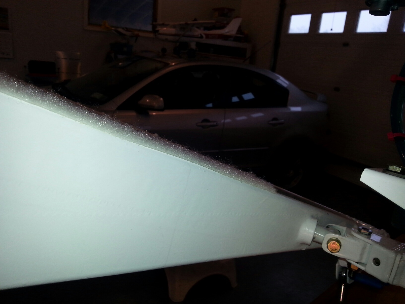

Stuart, here are the close up photos you requested.
I used the Poly Fiber system, it truly is a very simple system and the instruction book is quite good. The only part I had any trouble with was estimating the initial application tension, it is somewhat subjective depending on the size of the item being covered. 1 coat poly brush brushed, 1coat poly brush sprayed, 3 coats silver and multiple color coats. If I were to do it over I would not paint a lightweight plane white. I was used to auto paints and was quite surprised at how little coverage the pigments in the Poly Tone provide. The cage and boom are powder coated and most other parts such as nose cone, flaperons, tail ring and such are single stage Croma One auto urethane.

Thanks so much! They are saved to my ready reference file.
A tip of the hat to you on your craftsmanship!
I do however still have a couple of questions.
On the fuselage fabric, it would appear that you wrapped the upper longeron
with the pinked edge tape, but I cannot tell how far around the tube you
wrapped the fabric. I would think about half way around would provide
enough base for poly tac on that small of a surface.

Was the problem with getting the white to cover the silver or the yellow to
cover the white?
I ask because I can tell you used un-tinted poly brush, but understand that
light colors don't cover dark very well, and poly spray is fairly dark.

PostPosted: Sat Jan 25, 2014 7:51 pm    Post subject: Re: Firefly covering photos Reply with quote
I wrapped the fabric around as far as I could work with it, probably more than needed but in most places it was more than half way.
I used a lot of white to cover the silver, yellow over white was no problem. Spent lots of money on white paint and likely added considerable weight. If you look very carefully at the overall tail photo you can see that I added UV blocker to the vertical fin paint and it yellowed a bit.
I discovered a few things about irons. I checked several and found the following. Some iron thermostats have a wide temp. range between low on and high off. I finally found one with a narrow stable range but it cost a bit more than the really cheap versions. The shoe on all the irons at a given set temp. had rather wide variations across the shoe. For these reasons I found the recommended calibration method using a stack of napkins and heat sink to be somewhat inaccurate as only a small area is being sampled. I ended up using one of the non contact infrared thermometers and using the hottest portion of the shoe as my set temp. One of the small RC covering irons was also very helpful.
You are probably already aware of all the reasons Poly Tone is recommended and they are all true but I would use a urethane paint next time. The Poly Tone just is not as durable as the urethanes.
The checker board is Mono coat trim coat which works very well and the tail emblem was cut by a local sign maker after they blew up and adjusted a shop manual drawing.

be really easy to over shrink and damage something.
The Kolb manual suggested using a bunch of 5# weights suspended around the
perimeter to provide the tension.  I have not tried that yet, but suspect it
may be too tight for the 1.7 oz fabric, which is all I can find these days.
I think a little less than snug should be about right.  I have some scraps
of fabric (2.7 oz. I think) and some expired poly tac that I am going to
play with while calibrating my iron.  This well get me used to the process
again, and give me test panels to use when setting up my spray gun.  All it
is going to cost is some extra time, which will be well spent if it helps
keep me from doing something on the plane over again.
I found your comments about the pigments interesting and have a question
about that as well.
cover the white?
I plan on using yellow, red and black.  The yellow will be the "base" color
and the red and black with be fairly large areas of contrast.  My plan is to
use two coats of un-tinted poly brush, one brushed, one sprayed, each coat
consisting of two cross coats.
Then to skip the poly spray and just add uv blocker to the poly tone.  I
don't think I will do the entire structure in yellow as I first planned.  I
am now thinking of masking off and painting each color separately over the
poly brush which should still be basically white from the fabric underneath.
I do this for two reasons.  One, I am cheap, and two, any area with contrast
color will mean additional coats to that area, adding weight.
I am going to try my best to beat the 254# if I can.
Thanks for your photos and your input.
Stuart
