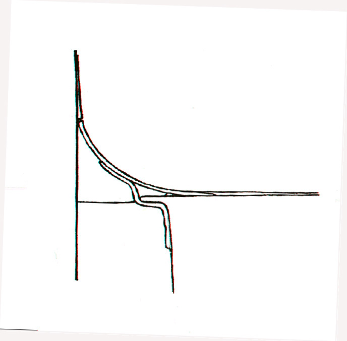

Tony
not sure what you are trying to achieve. I always made the fairings press lightly against the fuselage
so that there was no gap, and made them flexible enough to move with the bending of the wing.
Also filled the fuslage around the edges of the fillets to give a smooth transition from fillet
to fuselage.
Graham
