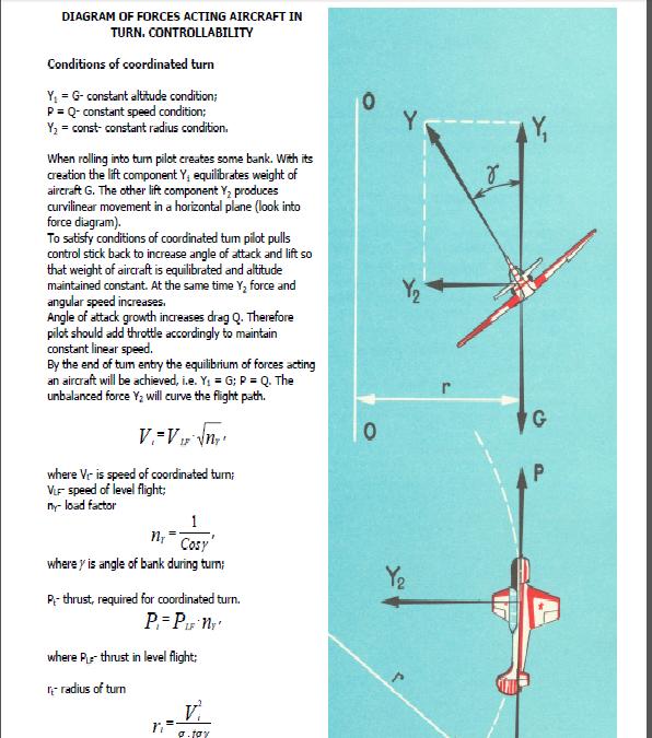

I’m looking for the Yak 52’s maneuver speed (Va)

Thanks but I'm looking for Va, the lowest speed at which you can generate the max allowable (7) g.

PostPosted: Fri Jan 10, 2014 6:52 pm    Post subject: Yak 52 maneuver speed Reply with quote
Maneuvering speed can be found mathematically. The formula is Vs (stall speed clean) multiplied by the square root of the g (7). If you put it into an excel formula it would be Vs*–n where n = acceleration. You can then use this to build a Vn diagram if you so choose.
Good luck!

PostPosted: Fri Jan 10, 2014 7:05 pm    Post subject: Yak 52 maneuver speed Reply with quote
Please also keep in mind that stall speed (at least in USA aircraft) is calculated based on MTOW and farthest allowable aft CG. If you are flying at weights below MTOW the Va will also be lower as it decreases as weight decreases (rule of thumb is 1 knot per 100 lbs).
Again you can calculate this using the same formula if you know the lower Vs or if Vs is unknown for the reduced weight you can calculate using Vaw2w1<![endif]--><![if !msEquation]>[img]cid:image003.png(at)01CF0E3F.3EE02840[/img]<![endif]>
Va would be the maneuvering speed you previously calculated based on MTOW. W2 is the current weight and W1 is the MTOW.

PostPosted: Sat Jan 11, 2014 6:14 am    Post subject: Yak 52 maneuver speed Reply with quote
Thanks Todd, good information.

PostPosted: Sat Jan 11, 2014 7:34 am    Post subject: Yak 52 maneuver speed Reply with quote
194 knots for Va seems crazy high for plane with a 60 knot stall speed. I am wondering if something is lost in translation?

PostPosted: Sat Jan 11, 2014 7:47 am    Post subject: Yak 52 maneuver speed Reply with quote
Todd
If I remember correctly, maximum maneuver speed is a lot like our military corner velocity. At that speed you can just pull max G at stall angle of attack. One knot above that and you over G. One knot below and you stall before reaching max G. 194 makes sense as 7 Gs is a lot and needs a head of steam to achieve. Hope this helps.

PaulW
Joined: 14 May 2013
Posts: 25
PostPosted: Sun Jan 12, 2014 10:22 am    Post subject: Re: Yak 52 maneuver speed Reply with quote
HI
Will this attached extract from Page 64 of the YAK-52 POH help?
 Filesize:  69.69 KB
 Viewed:  17322 Time(s)
