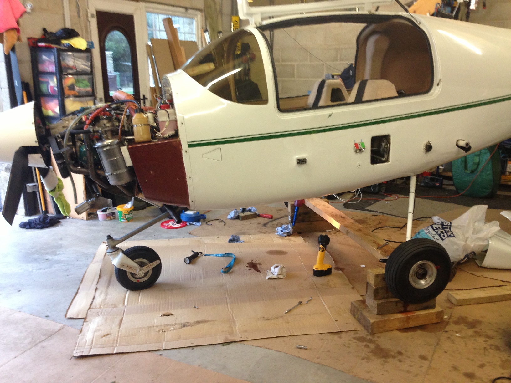

I have during the last few months been modifying the aircraft, with a new aluminium hard piped fuel system and the superb gascolator from "Andair" and changing the foot operated brakes to tunnel mounted finger brakes.
I wanted to share the enclosed picture showing how we finally (after nearly a week trying) managed to finally bleed out the air from the "Kart Component" master cylinders. The aircraft had to be jacked up on the main wheels, with the nose leg a lot lower, this got the cylinders as near to level / tilted forward as was possible!
What a job.............
Bleeding Brakes Wink
rgds
David
