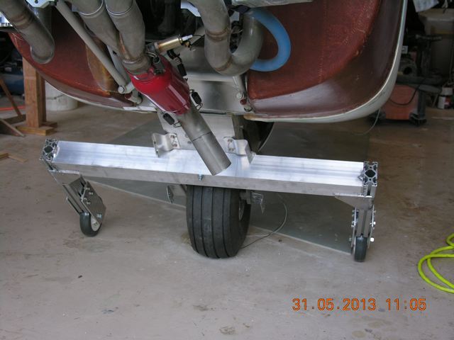

PostPosted: Wed Nov 27, 2013 10:21 am    Post subject: Mono dolly Reply with quote
On Nov 27, 2013, at 9:45 AM, Mike Gamble wrote:
I seem to recollect a posting showing suggestions for a dolly which would hold a mono upright whilst de-rigging and then allow movement of the a/c.
Mike...Steve Hagar designed a beaut...I suspect he would send you some CAD dwgs for dimensions etc. as he did for me.
Fred
[img]cid:4FD8454D-EBEB-401D-AB95-6DCE6C039E4F[/img]
 Filesize:  47.25 KB
 Viewed:  14298 Time(s)

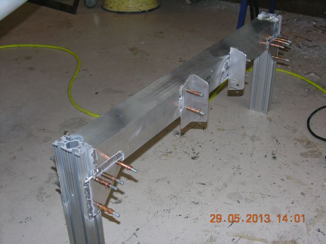

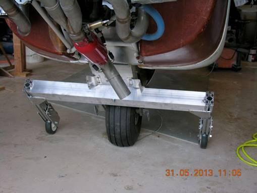

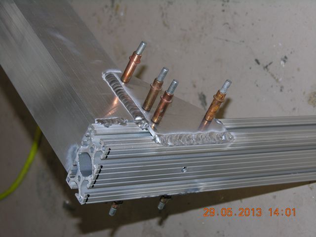

PostPosted: Thu Nov 28, 2013 9:14 am    Post subject: Mono dolly Reply with quote
Thanks Fred. Is that your interpretation of Steve’s design, ie without welding?

PostPosted: Thu Nov 28, 2013 9:50 am    Post subject: Mono dolly Reply with quote
Mike...my interpretation for sure...I separated the dolly wheels a bit more for added stability...those slotted framing extrusions are kinda spendy so I substituted 3 x 3 sq tubing where possible, but fully welded per Steve's design...I fitted and cleco'ed everything then gave it to my welder who charged me $30. for 15 minutes work max.
Fred
[img]cid:AA5E16CE-FAB5-487E-9C2D-848991B3857A[/img]
[img]cid:11639939-644E-4456-B985-16C2C4784C99[/img]
 Filesize:  44.81 KB
 Viewed:  14274 Time(s)
 Filesize:  39.67 KB

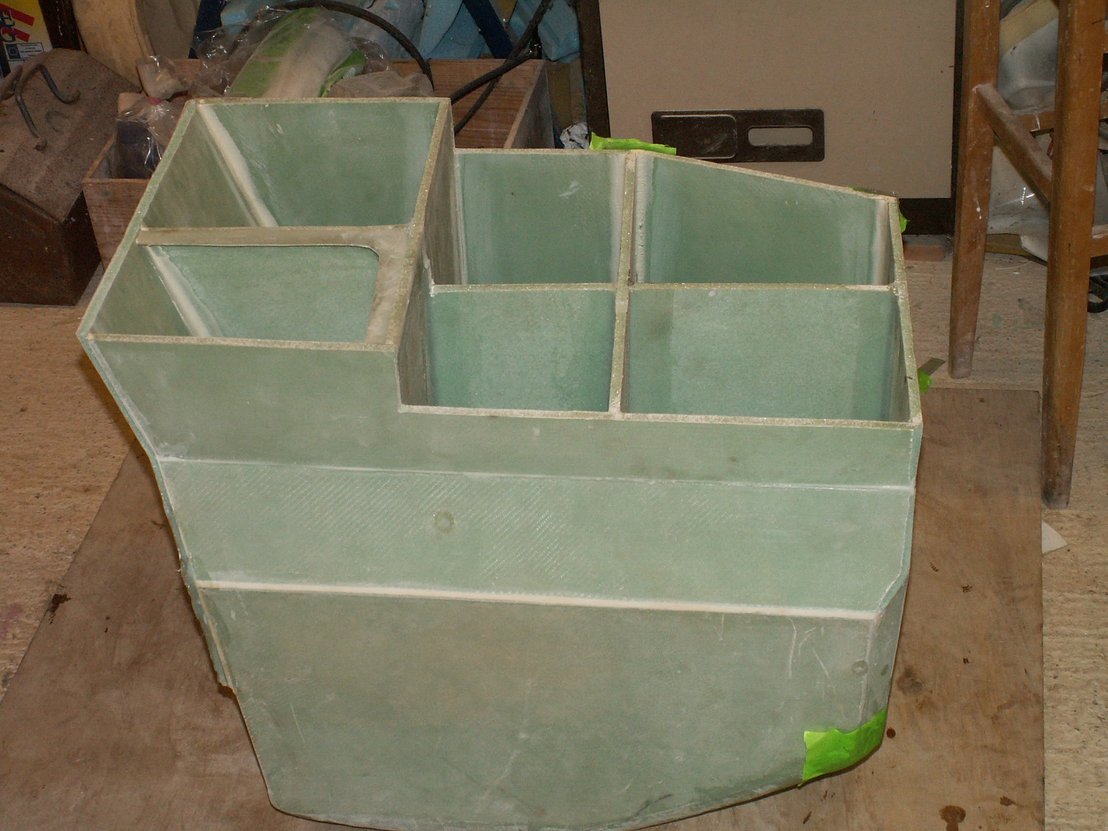

That's very interesting and kind of you to share. Was it you who also mentioned they have an LAA approved 100 Ltr ferry tank and, if so, are you able to share the details of that Mod?
Kind regards
Richard CC
davidjoyce(at)doctors.org

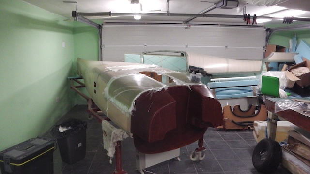

PostPosted: Sun Dec 01, 2013 8:26 am    Post subject: Mono dolly Reply with quote
Richard, Yes. photo of the build sage attached.
Essentially I made an outline pattern by cutting a
longitudinal midline (of the seat well) partition and two
transverse partitions, analogous to the partitions you can
see in the tank. I sellotaped them together to insure that
I could get the resultant solid shape in and out. The
base is a 5 layer bid splash moulding of the seat pan
with the edges turned up vertically for a couple of
inches. The sides are of high quality foam with 3 layers
bid outside and 2 inside all the joints are made with flox
going about 1cm into each panel edge then covered with
tapes of same nos of bid in and out. There is a small sump
at the back of the system, and also a recess for the
starboard spar pin. All partitions are vented at their
tops and bottoms. It works with a syphoning system that I
bought from Europa - designed for their long range tank.
It is retained by the seat belts with extra multiple loop
straps around the top and front, calculated to resist 10g
in any direction.
Flow rates demonstrated to exceed max 914 consumption. I
had previously by the way left a bit of bid/foam/bid panel
in avgas & mogas for some weeks without being able to
detect any sort of degradation.
Regards, David

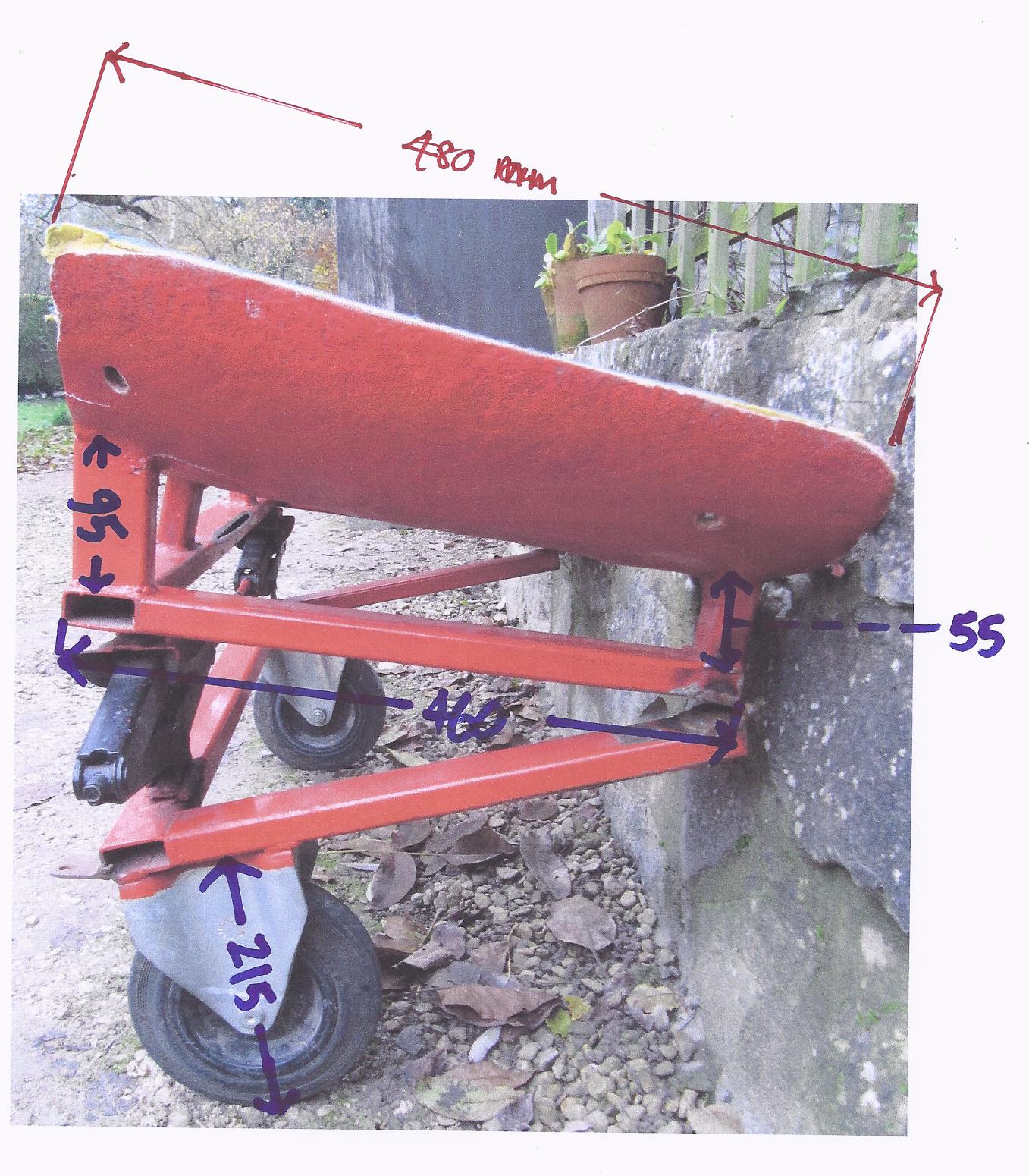

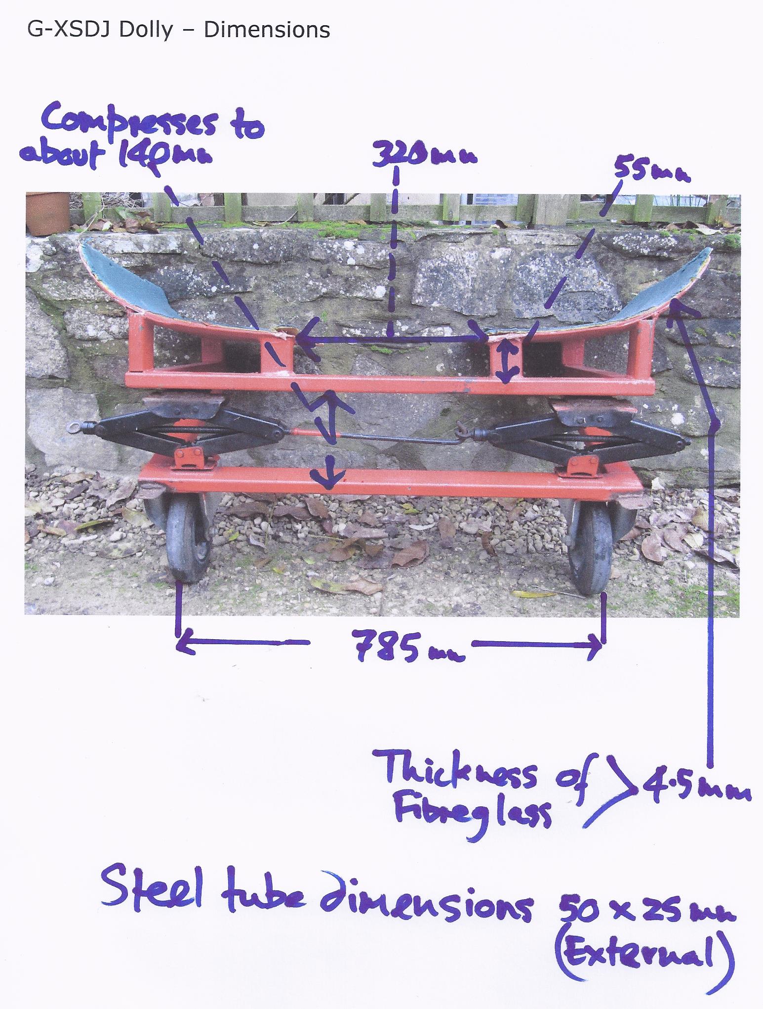

PostPosted: Mon Dec 02, 2013 3:14 am    Post subject: Mono dolly Reply with quote
For those you expressed an interest I attach some key
dimensions. The fixing wing bolts are currently many miles
away in the trailer but I think they are either 6mm or
8mm. Incidentally the track of the dolly wheels is
sufficiently wide that you can take one wing off without
needing to support the other one.
Regards, David Joyce, G-XSDJ

Mike,
We just clamp it to the swing arm. We do have a couple of angles welded to the cross bar to locate the dolly on the swing arm. Sorry we don't have any photos of it installed.
Jim & Heather

I have been following this thread quite closely as i am building a mono and one day it will need to stand on its own. I have seen many different solution's to the problem but yours David or Roger's is the best iv seen as not only does it hold the fuselage upright it can be raised to replace pads ect AND it can be used to hold the fuselage in transit AND hold it while rigging!! I was that taken with it that last evening i started to make my own my taking splash mouldings of the fuselage, so as was said before thanks for sharing David. Thanks Frank
