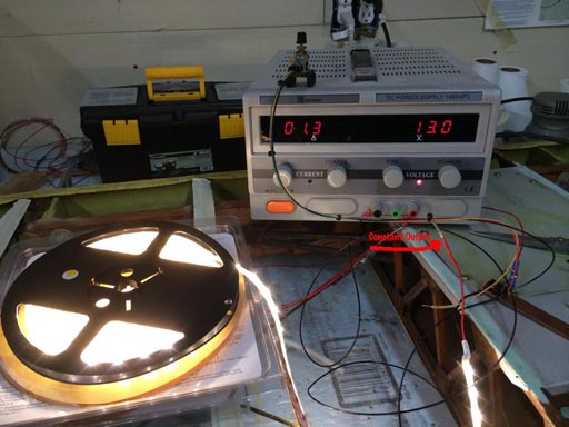

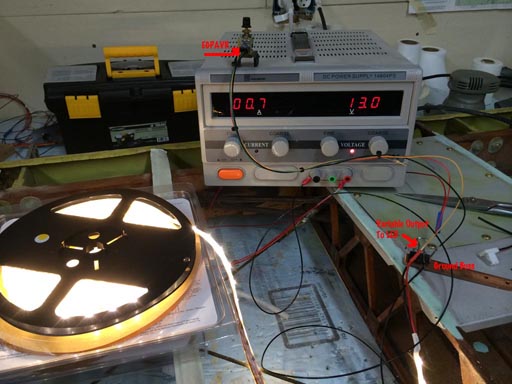

I ordered a unit which arrived in very short time and connected it up to my power supply and the LED string.
Here is a picture of the EGPAVR connected to the power supply and the LED string with the power out to the string coming from the variable output (yellow lead) of the EGPAVR:
Here is a picture of the EGPAVR connected to the power supply and the LED string with the power out to the string coming from the constant output (green lead) of the EGPAVR:
It all seem to work quite well for my application. I plan to use a short section of the LED string to back-light my fuel sight gage. Power for this LED string will come from the variable output. The remainder of the LED string will be used to illuminate the tunnel area of the Europa and thereby serve as an interior work light. Power for this string will come from the constant output of the EGPAVR. I’ll have to add an inline switch from the constant output to the work LED string. This is so that the interior work light doesn’t come on every time the sight gage is illuminated, it can be turned on only when needed.
