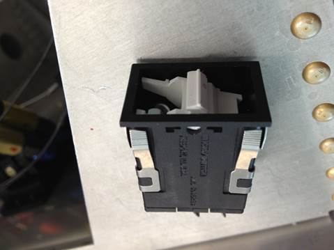

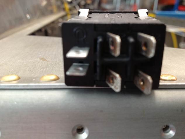

I bought these Honeywell illuminated rocker switches
which are DPST switches, ref. # AML34 FBA4AC01, and look like this from behind
The 4 inclinated lugs are obviously the source and load for each pole, but I’m having trouble to find out how to connect the upper lugs, i.e, how does the illumination lamp circuit works.
I suppose I’m having a brain freeze here…
Since they didn’t come with any schematic drawing, and I couldn’t find it online, can somebody please tell me (or send a hand draw) how does the lamp circuit works?
Carlos

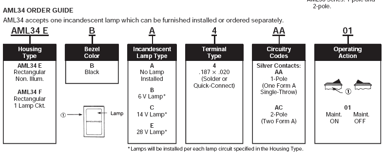

I re-read your post & p 4 and see your switch AML34 FBA4AC01 is a:
AML 34 F > “Rectangular 1 lamp circuit”
B > “Black”
A > “No lamp installed”
4 > “.187 x .020 (Solder of Quick-Connect) terminal
AC > “2-Pole”
01 > maintained ON and OFF
I find the second “A” intriguing, as it hints that NO incandescent lamp was installed?? Honeywell MAY be using the same body on multiple switches and your switch MAY have lighting terminals, but no light installed. Try a resistance measurement between the two straight terminals. An incandescent light should give a relatively low resistance reading.

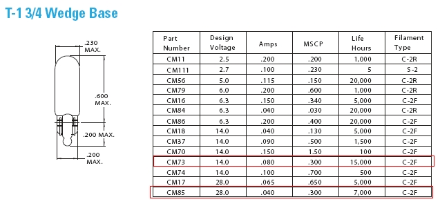

[img]cid:.0[/img]
I presume you have #73 or #85 lamps to install
[img]cid:.1[/img]

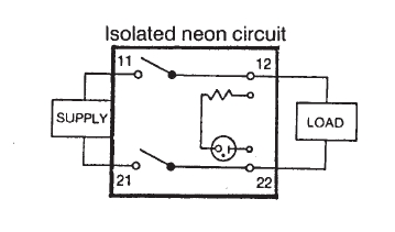

The schematic for these switches
[img]cid:.2[/img]
Shows the two poles on terminals 11/12 and 21/22 with
the lamp isolated on the other two terminals. The elsewhere

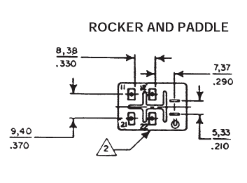

in the literature I found this rear view of the termina
arrangement
[img]cid:.3[/img]
If you look at the back of your switches, you'll probably
find numbers molded into the housings.
You probably only need one of the two poles to switch
a load so you can use either the 11/12 or 21/22 path
for this task. I presume that you're going to power all
the lights from a dimmer so one of the two lamp terminals
would be tied to ground . . . the other to your dimmer
output. For side-by-side switches, you can daisy-chain
jumpers across the row of switches to parallel all the
lamps and take single conductors to ground and dimmer.
. . . sorta like this.

Referring to the document AML30.pdf and analyzing the part number you have provided shows that you bought the switch without a lamp installed indicated by the "A" in the centre of the part number. You did buy the appropriate lamp to install in this switch according to the voltage you require didn't you? If you wished it to come with a 12V lamp already installed the central “A” should have been a “C”
AML34 ORDER GUIDE
AML34 accepts one incandescent lamp which can be furnished installed or ordered separately.
AML34 F B A 4 AC 01 has no lamp installed AML34 F B C 4 AC 01 has a 12V lamp installed. For 28 volt it would be an “E”
