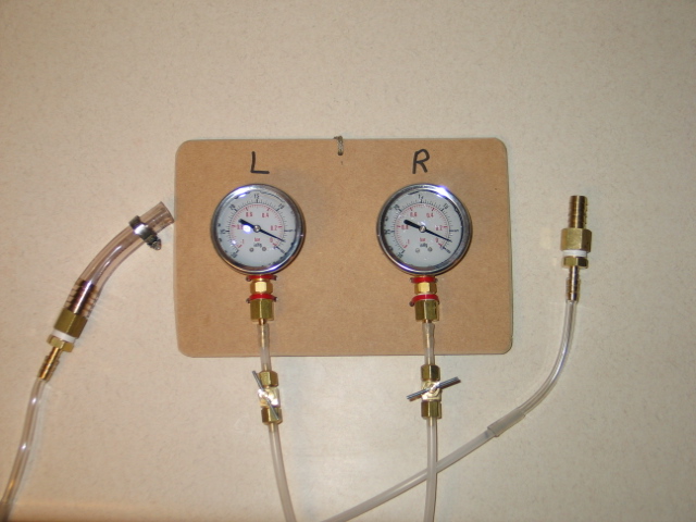

Connect the Pneumatic Sync Tool
It is imperative to have the engine up to the operating temperature. Remove one end of the rubber crossover compensating tube between the two intake manifolds or connect to the top of the intake manifolds or use the cross over tube rubber hose pinch off method shown in Rotax owner videos. All these attachment methods will work.
Hook up gauges or electronic sync tool. Secure one end of a gauge or electronic device to the rubber end of the compensating tube and the other to the gauge at the 90 degree fitting coming out of the intake manifold where the compensating tube hose was removed. Secure both attachments with a hose clamps to prevent leaks. Leaks will affect the results of your sync process. You can hook up your sync tool at the small screw on top of the intake manifold, but then you have to pinch off the rubber hose between the carbs on the cross over compensating line. I find this is just more work and you need to make sure the rubber hose on the compensating tubes are long enough (usually newer engines) and you don’t allow any leaks between the carbs. Many people have to cut the tube shorter and make the rubber hose longer to pinch it if you have an older engine with short rubber connecting tubes. I think it is easier and faster by just pulling the hose off as originally described and it facilitates complete carb separation.

Simple carb sync tool
 Filesize:  120.66 KB
 Viewed:  5420 Time(s)
