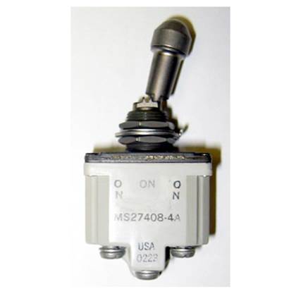

Guys
Since I am not sure if this switch will suite my need
can somebody please post a drawing of its eletric schematic.
Carlos
P.S. – I am looking for a switch for the fuel pump that can be powered from 2 independent power sources, being the middle position the OFF position

Hope these will answer your questions.
http://www.jameco.com/1/1/40651-2tl1-10a-switch-toggle-ms27408-4a.html
http://www.jameco.com/Jameco/Products/ProdDS/1817426.pdf

Hi CarlosYes: that would certainly do what you want, they do do one where the switch is not locked out in the on position, convenient for a quick flip to switch offJohn
