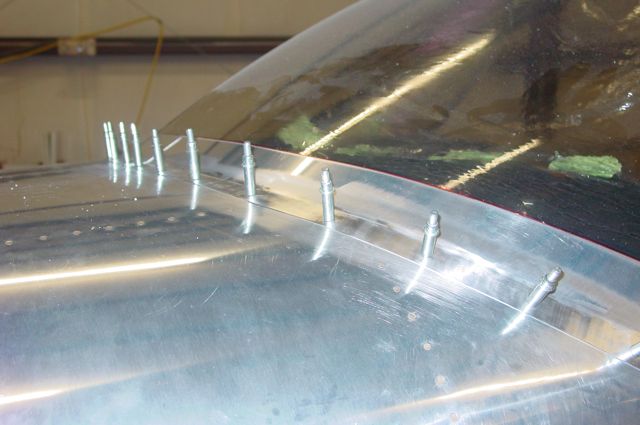

bob88 wrote:
Does anyone have an opinion and/or experience with the Blue Skunk windshield fairing?
Yes, I used the M.L. Skunk Works windshield fairing. I got the impression that Kelly thought that it's a whole windshield, it isn't. All it is, is a replacement for the built up fiberglass fairing at the bottom of the windshield. It's simply two partially shaped strips of aluminum that you rivet together and custom shape to your windshield. With minimum use of a shrinker/stretcher I got a great fit. As you fit, you will drill cleco holes to hold it in place. Once it's the way you want, you can glue it to the windshield (I used Silpruf 2000) and rivet it on. The real purpose of the Silpruf was to give it a good, black, look on the inside.
It was easy to rivet if the panel is out. Just make sure the holes were drilled in places not-too-close to anything else, so it's easy to get a bucking bar in there.
When it comes time to paint, you just feather on some micro to hide it. I am very pleased with the results and would definitely do it again. By the way, the price is the same that I paid in 2009.

PostPosted: Sat Dec 21, 2013 7:22 am    Post subject: Re: Windshield fairing Reply with quote
Bob,
I'm sure you'll do what you want. Here is a photo I took during fit.
John
