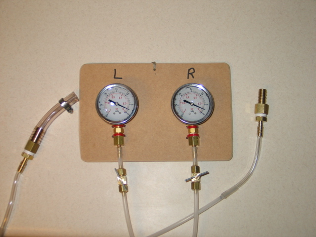

PostPosted: Mon Dec 30, 2013 12:58 pm    Post subject: Re: CarbMate Reply with quote
Hi John,
No special brad. I don't buy top dollar, but don't buy cheap either. When you get them just pull a vacuum on them at the same time and make sure they are reading the same.
Put an in line needle valve in each vacuum line to pinch it down to dampen the impulses even more. You can buy every thing you need except the gauges at Ace Aviation (Ace Hardware). Smile
here is a picture of a simple carb sync tool that works very well and doesn't cost a lot.
I have ab Aces dynamic prop balancer. It is fairly pricey for a one time owner unless you plan on doing a lot of planes. Wouldn't it be cheaper ($300) to just pay someone a one time fee.
